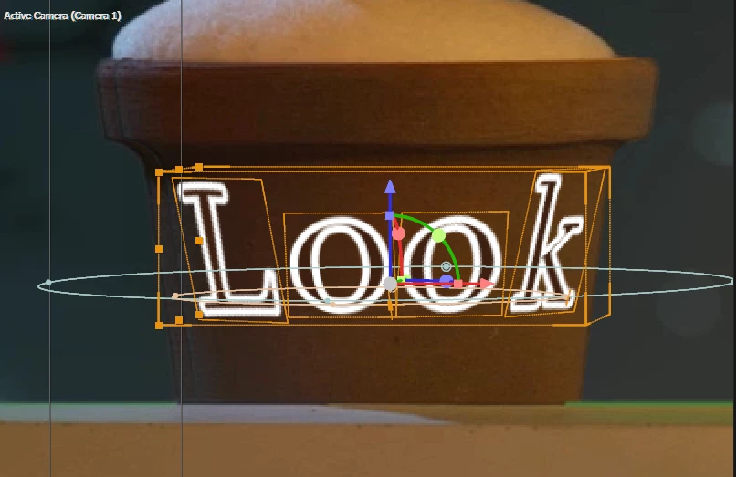

I need text to animate around a cicular mask path so I have
1) made text
2) made path
3) made laye 3D and rotated layer 90 degrees to "flat" in 3D space
4) align text perpendicular to path
5) enable per 3D character rotation
6) rotate next 90 degrees back to vertical
So far so good; the text animates round the circle facing outwards, exactly as intended.

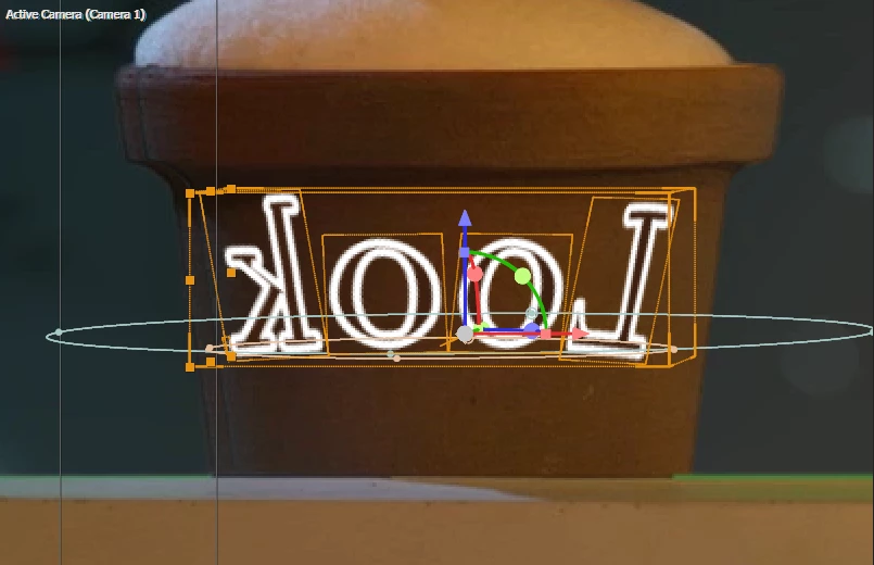

The issue is, I need the text to vanish at the far side of this circle. ie do the same thing it would do if you used CC cylinder or CC sphere and set the render mode to "outside only", as though the text is no longer visible around the far side of said cylinder/sphere (despite the cylinder/sphere being invisible).
However, I cannot achieve this - the text is always visible even when on the far side of the circle. This is confusing as even when I add an object at the correct position in 3D space that should mask the object, the text visibility pays no heed to the order of things in 3D space, only the layer order in comp view. You can see in the images that the text is still visible when at the far side of the mask path. (FYI I am using the 'first margin' property to animate the text along the path). This is despite there being a solid in 3D space at the centre of the mask path on the Z axis that should be obscuring the text when it is at the far side of the mask path circle.

use two layers. of same animation.  One in front of whatever its circling and one behind.  Mask them off so the transition is seamless
~Gutterfish
Mylenium
June 15, 2021
Nothing wrong. You have reached the limits of AE's 3D renderer and the specifics of your setup with using text on paths and per character 3D. Explaining the specific interactions would take too long, but you can always read the online help and/ or watch tutorials on how using specific layer switches and combos thereof affects AE's internal rendering order. So where your setup is concerned, you will have to get creative and use a bit of masking and track mattes, which for all intents and purposes could be based on a greyscale gradient applied to CC Cylinder even, though in your case something as trivial as a masked solid assigned as an Alpha matte to the3D text would do. You still have to split the layers, though, to get this front/ back thing illusion.
