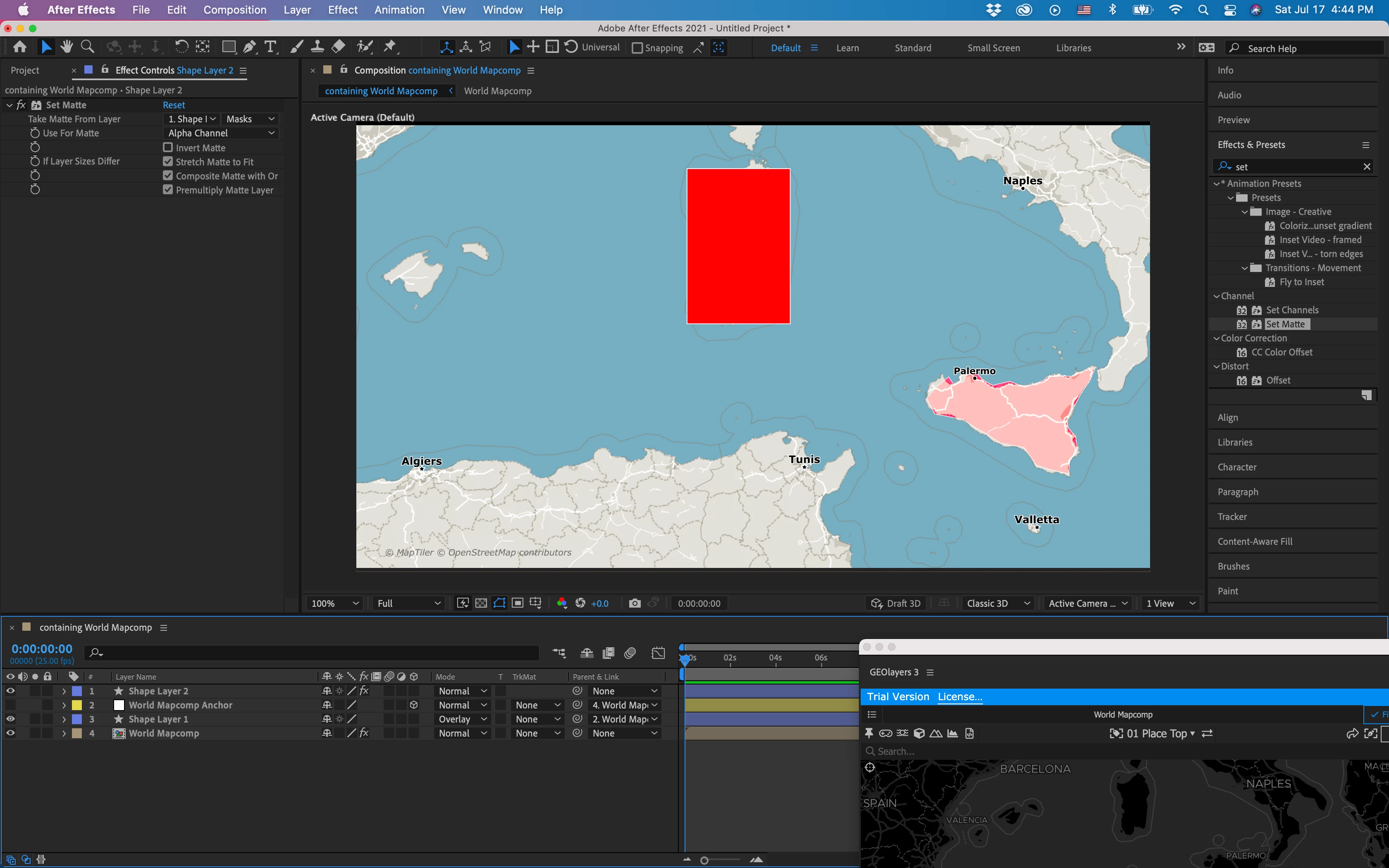

Hello there,
So I'm basically trying to find the best way to place a layer on top of a map and find a way to have that layer tranform to look identical to the map underneath.
In other words, if I were to zoom in Sicily, for example, and place a rectangle shaple layer there, how could I get it to look like Sicily, without having to manually move every piece to fit.  That's very tedious and I believe there's a way around it.  I'm rather new to AE, but track mattes sort of do what I'm talking about, but I can't get it to look just right.
If you've ever seen a historical video on Youtube where they move the borders around, that's basically my goal for the project I'm working on, just can't quite figure out how to do that.
Michael

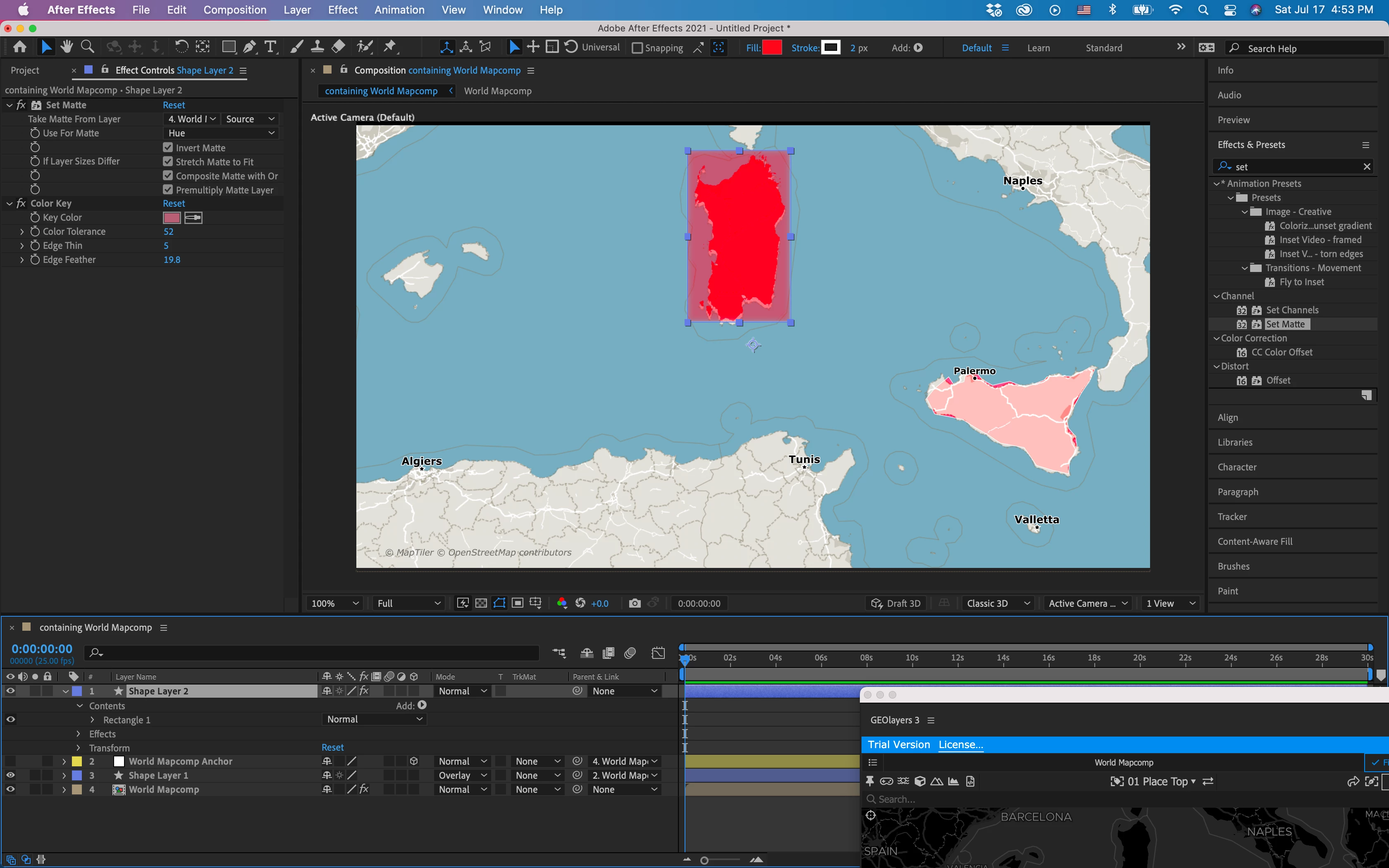

Set Matte sort of works.  I tried doing that, plus color key, but still can't get it.

How many layers/ what layers are within your map comp?
July 17, 2021
There are no layers within the map comp.  I'm using a plugin called Geolayers, which is making this more difficult.  If there are layers within it, it's stuff that I can't mess with.
July 17, 2021
Can you upload a screen shot?
July 17, 2021
Thanks for responding.  As you can see, on Sicily, I was trying to apply a shape layer, and manually fit it so that you can't see the border or water, unsuccessfully.  Then on Sardinia, I'm messing around with Mattes, to see if I can get that to work, also unsuccessfully.
