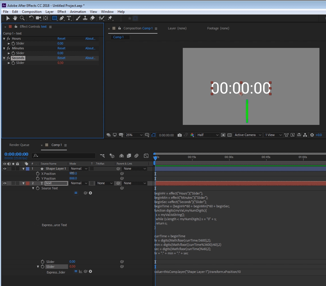

1. here's an animation preset I made for a Timer* where you have HH:MM:SS values in Sliders on a text layer. just create a text layer, use a monospaced font, and apply the preset (animation->apply animation preset):
Timer.ffx - Google Drive
2. about left and right, it's simply a matter of linking the sliders to the X value of the layer which is moving right or left.
*the only issue I currently see with this preset is that it does not work well with negative numbers (which I discovered by testing for your post, not that I ever needed it..) and I do plan to see how to work around it.
shauns82460770
April 26, 2018
Roei, your preset and approach worked perfectly!

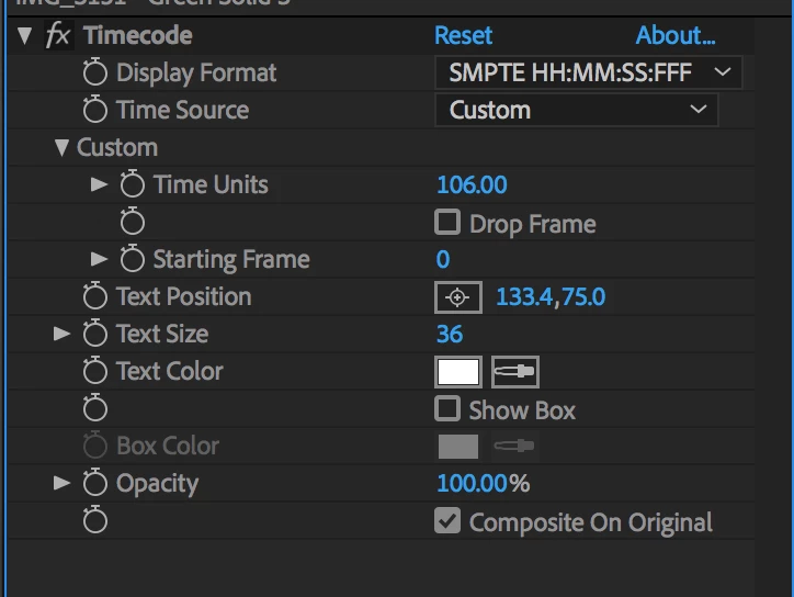

Effects>Text>Timecode should do the trick. Set the TimeSource property to Custom. Then keyframe the value for Custom>TimeUnits to offset the natural time increment of AE's Timeline or to any value you require.

Appreciate the response, Roland. While I'm giving this a try, is there a way to change the typeface?
Roland Kahlenberg
April 26, 2018

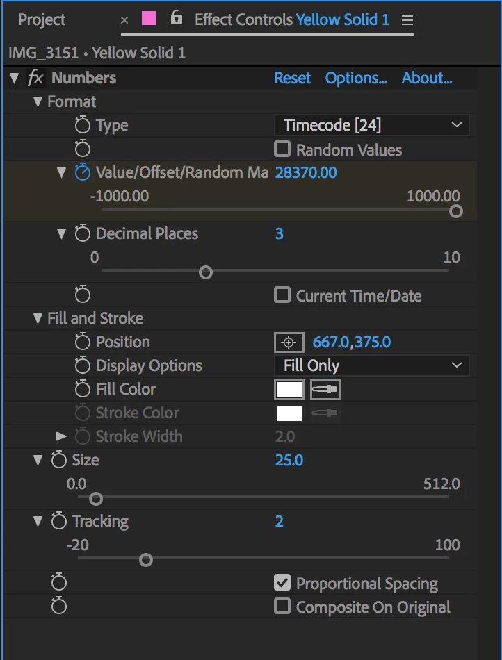

Not with this effect. BTW, I've just checked Effects>Text>Numbers and there seems to be a bug with the property Value/Offset/RandomMax not being functional when a negative value is input. The result when a negative value is input is as if only the positive variant of the number is being calculated. Please file a bug; using the Feature Request/Bug Report link at the top of this Forum's Main Page. Thanks.
