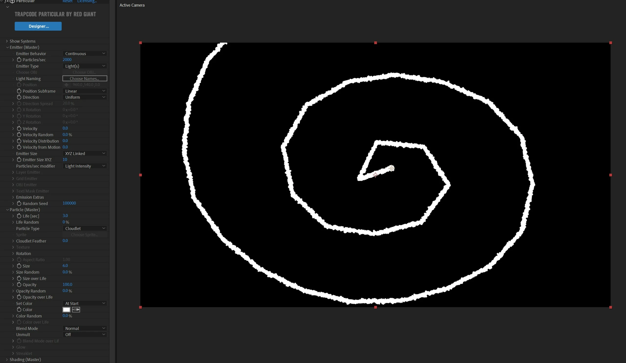

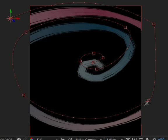

Ive used a light path for trapcode particluar , but the corners are not rounded , is there a solution for this?

May 21, 2020
I changed position subframe to other then liniar, nothing changed
slowering the speed did rounded the corners, but i may need to keep the speed faster
is there any other solution without changing speed?

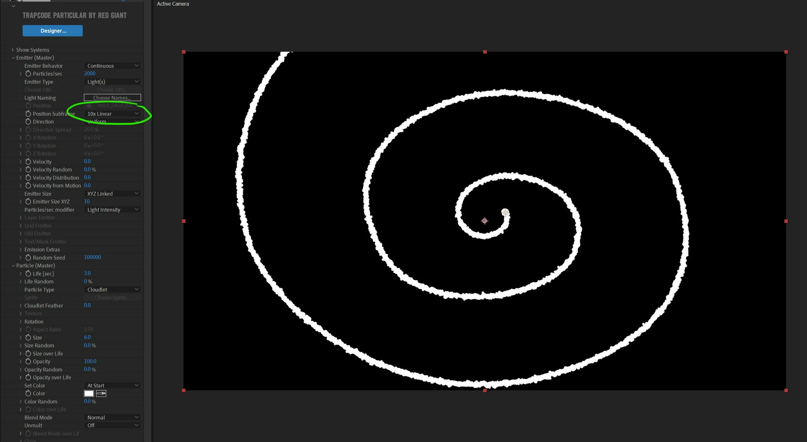

May 21, 2020
That's really odd, changing the position subframe sampling off of linear should have fixed it (as attached) 🤔 🤔:
If that doesn't seem to work for you for some reason, one thing you can do, is to keep the slower version, precomp it (drag it into a new comp), and then Layer/Time/Time Stretch that to the shorter (and faster) length you were hoping for.
