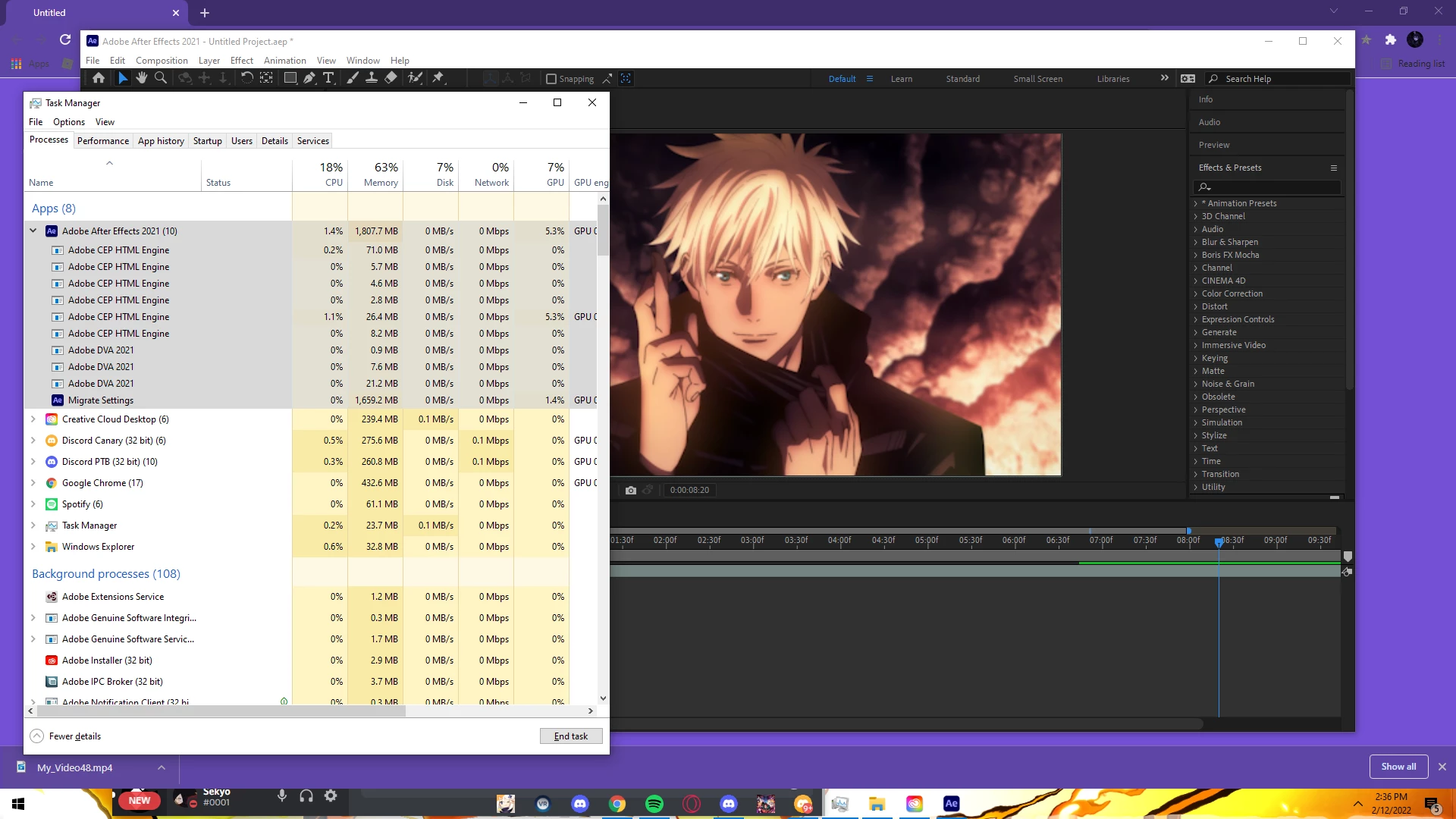

Without any actual system information nobody can tell you much, anyway, and according to your screenshot AE is only using a measly 2 GB, which by all standards is not much. The only thing suspicious is the "Migrate Settings" utility, so you may want to terminate that process/ find the dialog window and finish it. If you think something else is wrong you need to explain in more detail and provide the pertinent information.
Mylenium
February 16, 2022
The longer the clip the higher my memory goes up and will freeze my computer.  And when that goes up the sound gets all messy. For the system information. i run on a  i7 with 16gb of ram. I dont know why after effects is doing this so if  you could help me that woulf be nice.
