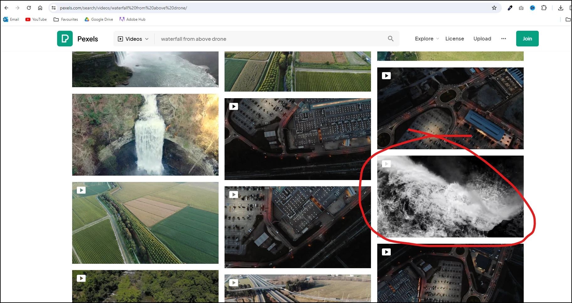

I think this is where stock footage can really help.
On Pexels, search for something like "waterfall from above drone".
Download a few examples.  I did this really quickly, so the footage I got would need to be refined or at least tracked as the drones were moving.  But provided you can find decent footage, then bring it into After Effects.

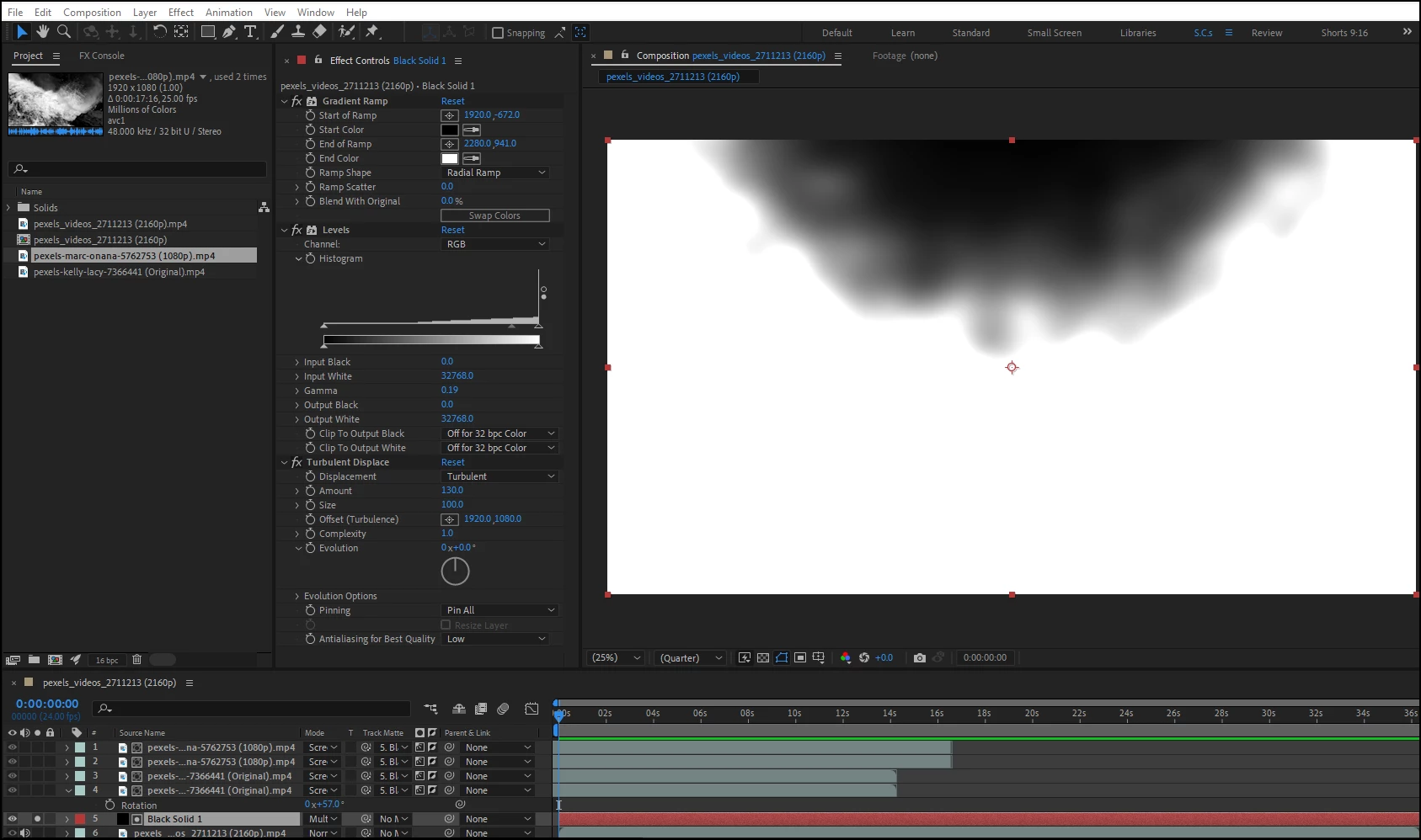

Next create a new solid, and add:
  • A Gradient Ramp.  Set the start and end points so that the edge appears in front of the boat
  • Levels effect and adjust it so that the edge of the hole is quite sharp
  • Turbulent noise effect to roughen the edges of the hole.

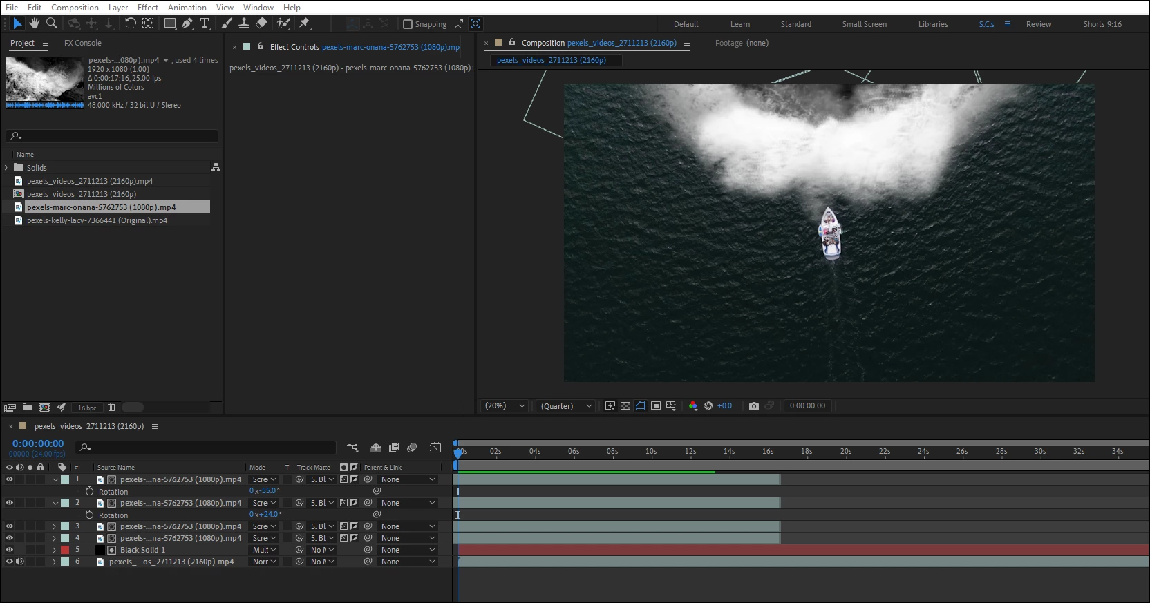

Set this layer above the boat footage with its transfer mode set to Multiply.
Add your stock footage layers, using masks and possibly the luma key effect to just show the white foam.
Use the solid as their track mattes, set to Luma Matte Invert
