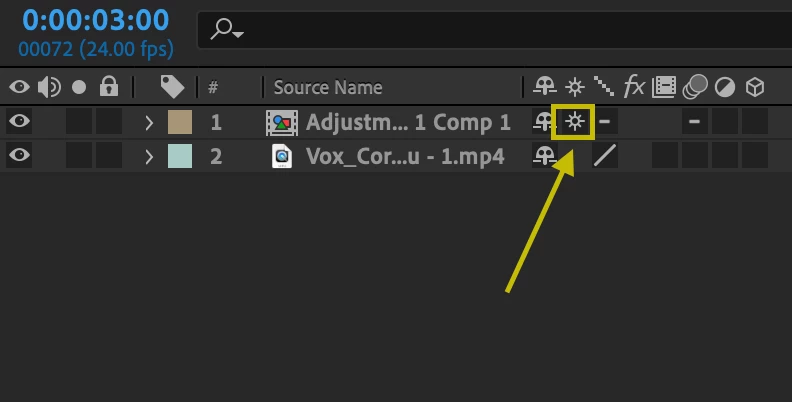

I would like to group mulitple adjustment layers with their individual masks inside a precomp, but the precomp should just behave like a "group" in Photoshop, just that it can be deformed in AE etc.
It means when I have a brightness correction it should work also at the main document, when it is nested inside the precomp.
How to achieve this?
As soon as I precomp an adjustment layer, the new precomp is not affecting anymore the layers below.
Thanks for help
OussK
January 9, 2022
Just apply collapse transformation on the precomp you want to affect the layers below.
