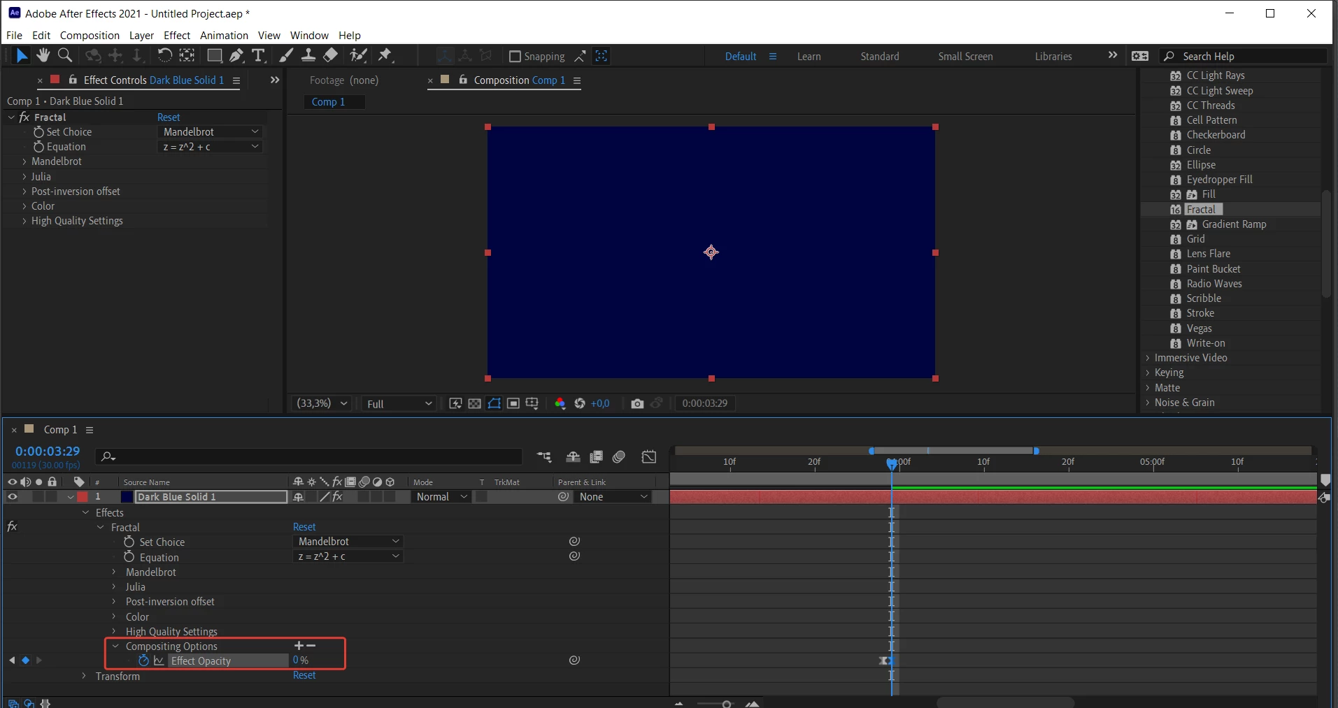

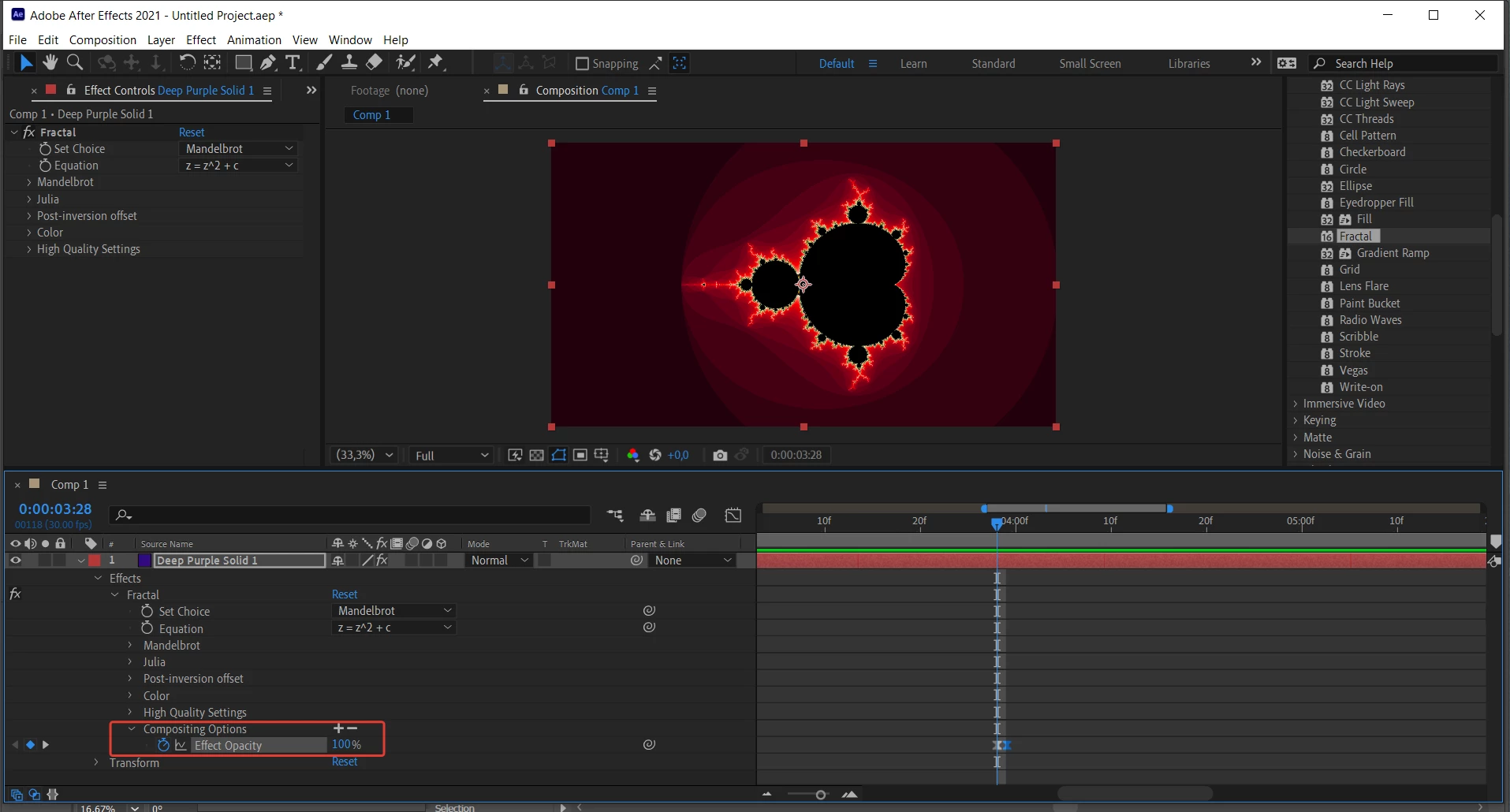

For me, the easiest way is to change the Effect Opacity property on the Timeline panel.
You can stop it abruptly or create a smooth fading. Later you can learn how to animate it with expressions and a great new experience 🙂
Here the effect is stopped quickly using the Opacity changing from 100 to 0 in the adjacent frames.

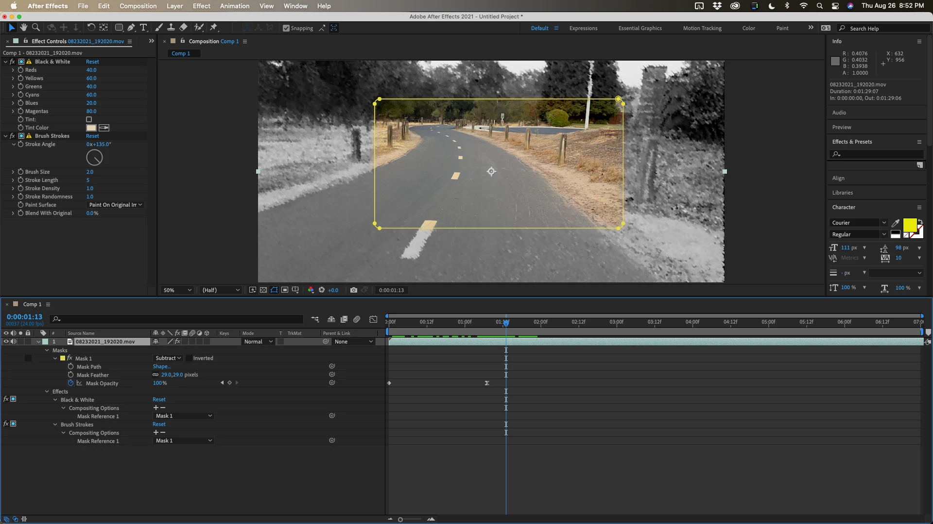

You can turn an effect on or off by adding a mask to the layer, setting the Compositing options to use the mask, then animate the mask opacity. For example, I added Black and White and Brush Strokes to this clip with a Subtract mask in the middle, set the mask to subtract, added it to the Compositing Options for both effects, then animated mask opacity from zero to 100%. The result is a normal clip that changes to black and white + brush strokes outside the mask as the opacity changes.
Compositing options work with almost all effects.
