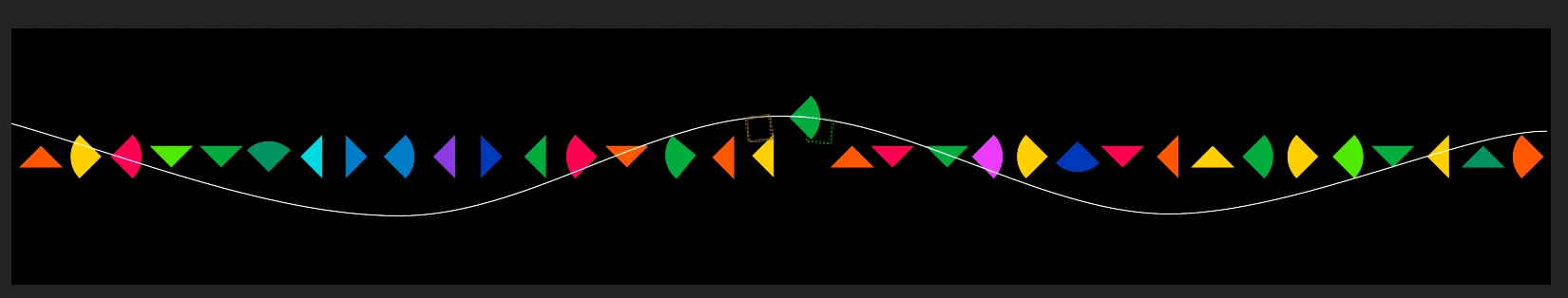

I'd like to attach all of these shapes to this moving white line. Any help would be appreciated! The green one you see attached I did with Trace Paths. But it doesn't work for multiple objects. Thank you in advance.

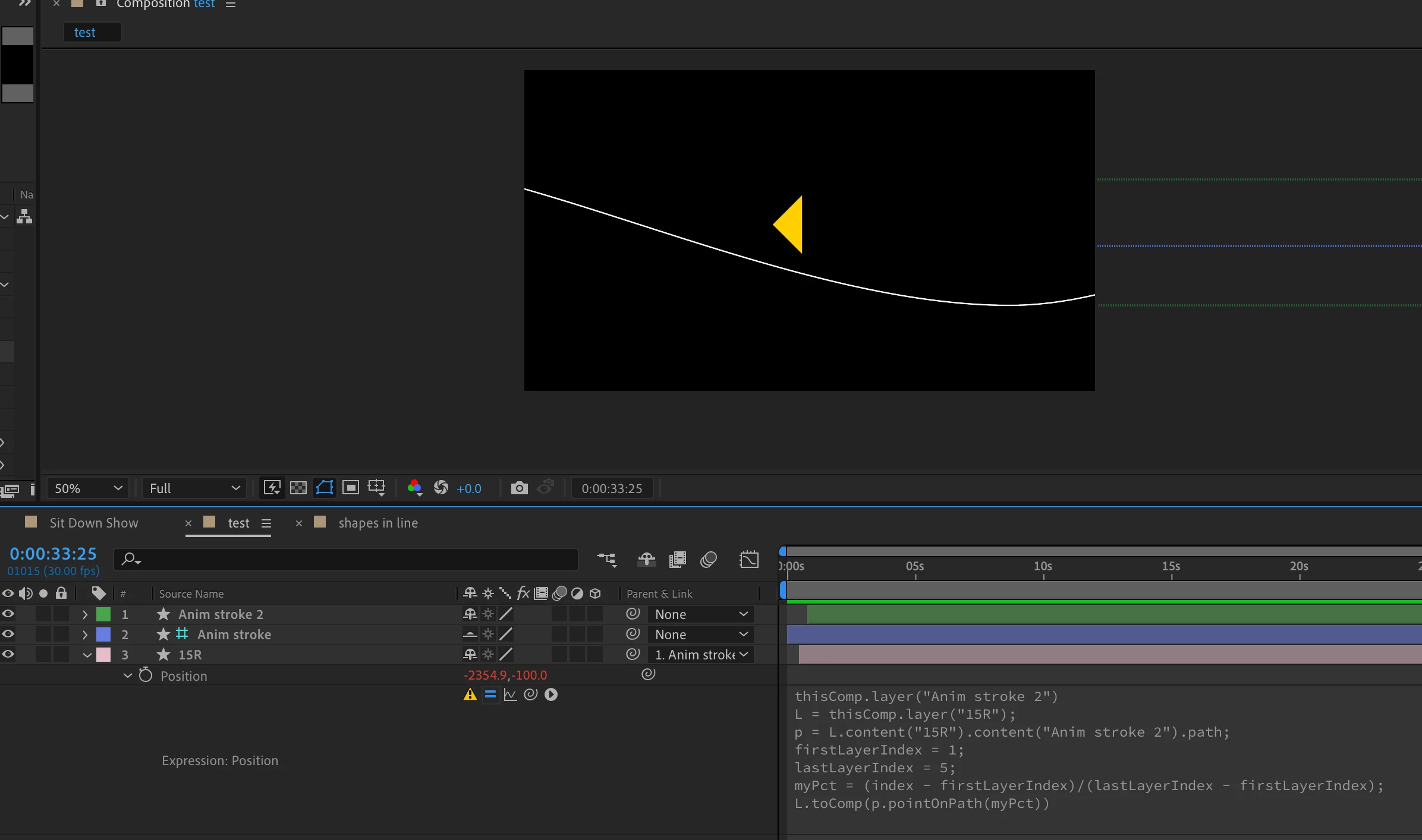

JudieLAuthor
Jun 20, 2024 3:09 PM UTC
Hi Dan, I've applied the code you suggested but it's not connecting. Can you please let me know where I've gone wrong in this screen shot? Thank you.
Dan Ebberts
Jun 20, 2024 3:17 PM UTC
There's an extra line at the top of your expression that shouldn't be there. It looks like firstLayerIndex should be set to 3 (?). If there's only one layer getting distributed then I guess lastLayerIndex should also be set to 3. Where is the path exactly (maybe post another screen shot that shows the stroke layer twirled open to expose the path)? Also, the layers being distributed shouldn't be parented to anything.

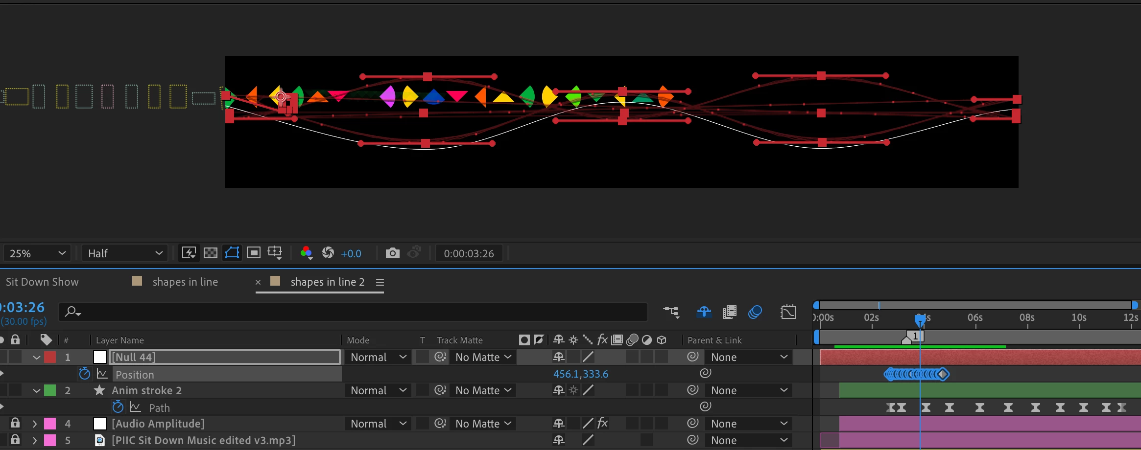

JudieLAuthor
Jun 20, 2024 2:36 AM UTC
Just realized you meant "path", my apologies. In theory, what you suggested would work. But when I copy the path key frames into the Null position, it goes bonkers like this. Even the keyframes paste all bunched up.
