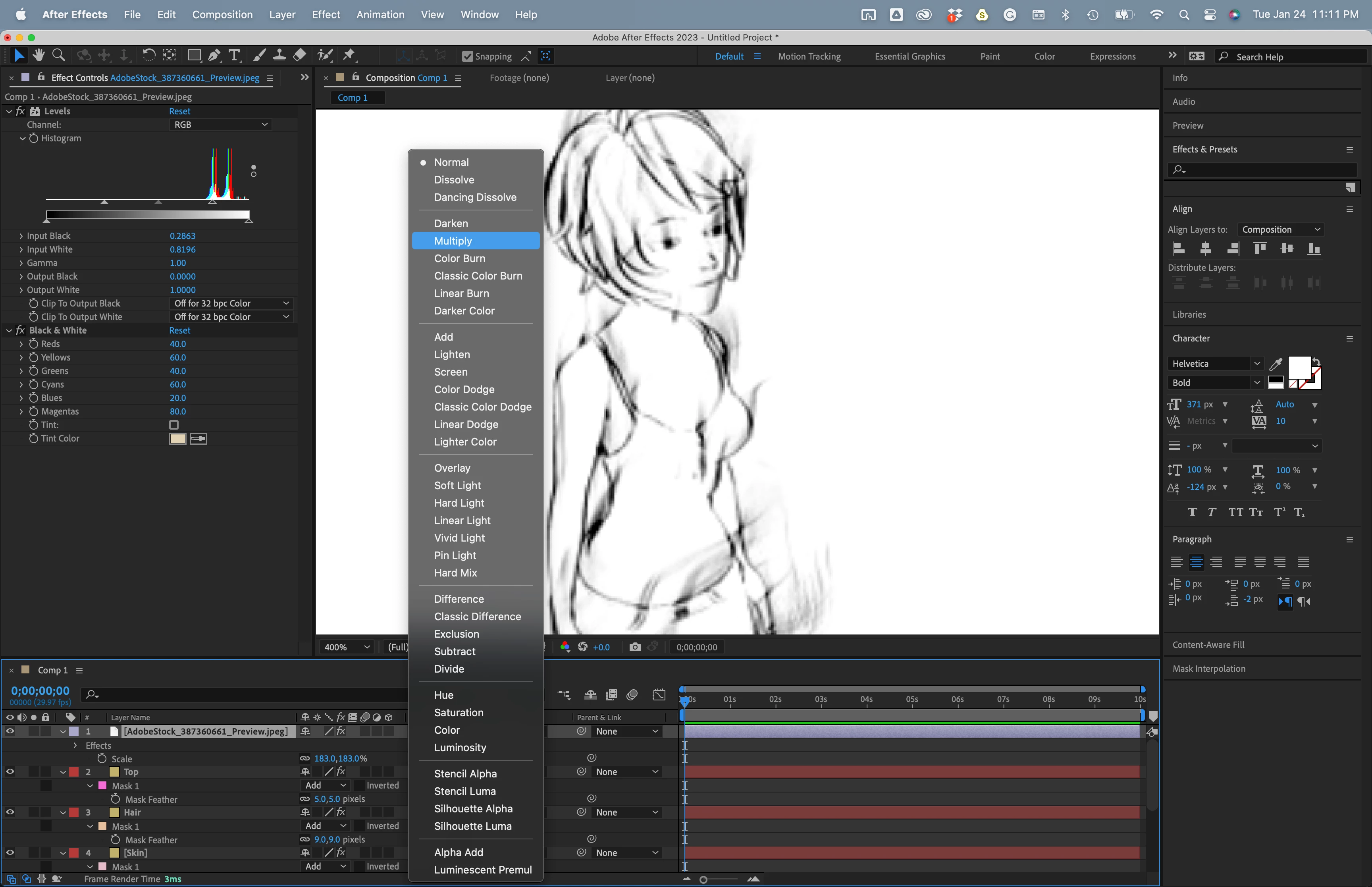

Removing the white background on your pencil drawings is as simple as changing the Blend Mode to Multiply. The white will disappear, and the colors below will show up.

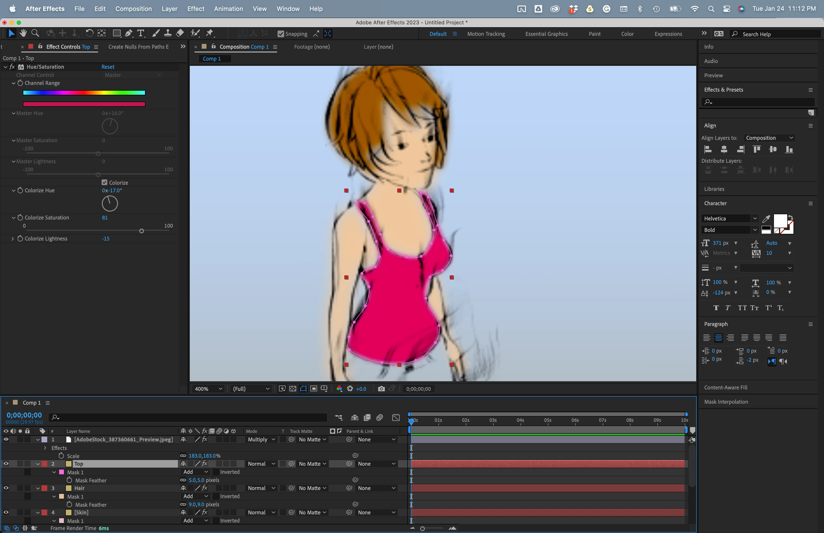

The big challenge is creating the colors and animating their shapes. You will have to do a lot of rotoscoping (animating masks) to add color. I grabbed an Adobe Stock image, added some color correction to make the background whiter, then added a shape layer with a gradient as a background and some solids for the hair, skin, and shirt top. Changing the blend mode of the top sketch layer lets the colors of the other layers show through.
I have attached the AEP file and the Adobe Stock image for you to play with.
The name of this workflow is Ink and Paint. Depending on your drawings, you may be able to do a little tracking in Mocha AE to speed up the Roto, but just like traditional cell animation, adding the color will take some time.
