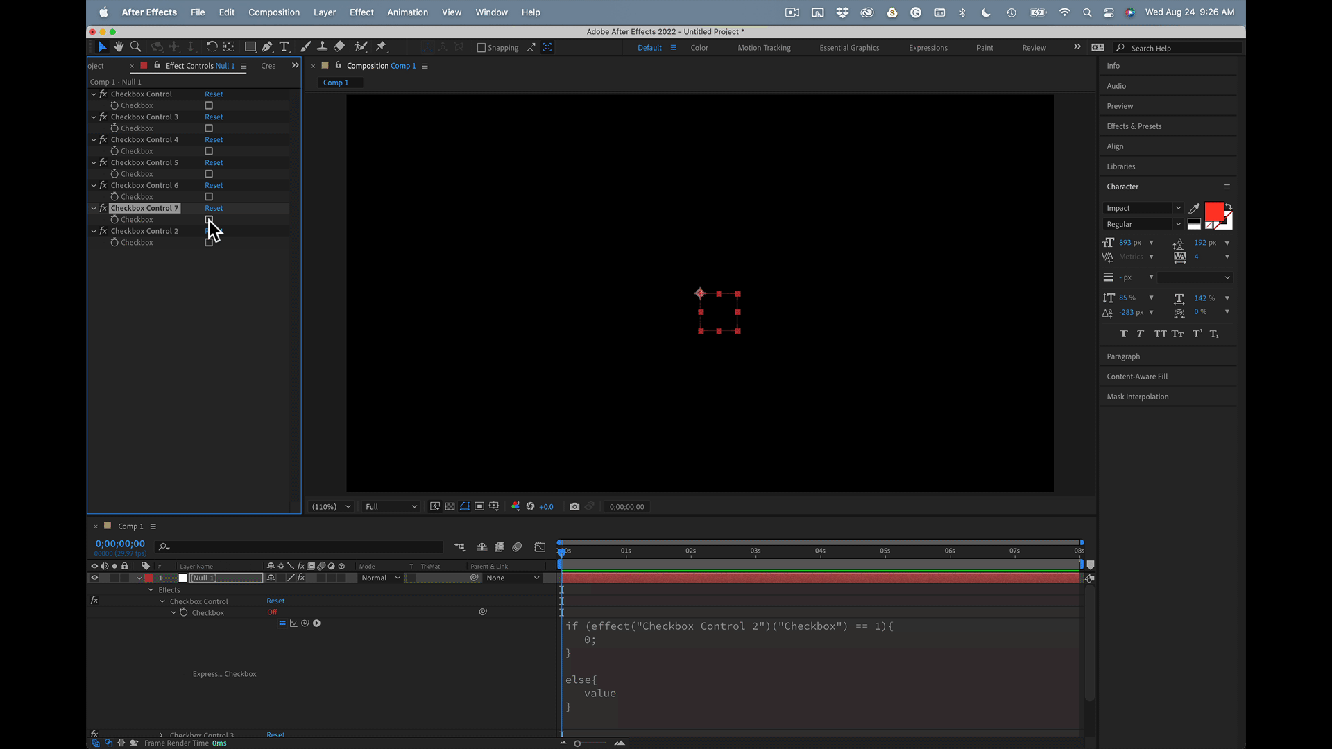

This works:
if (effect("Checkbox Control 2")("Checkbox") == 1){
	0;
else{
	value
As long as Checkbox 2 is not selected (checked), the Checkbox with this expression can be on or off. If you select Checkbox 2, the checkbox with the expression will be turned off.
