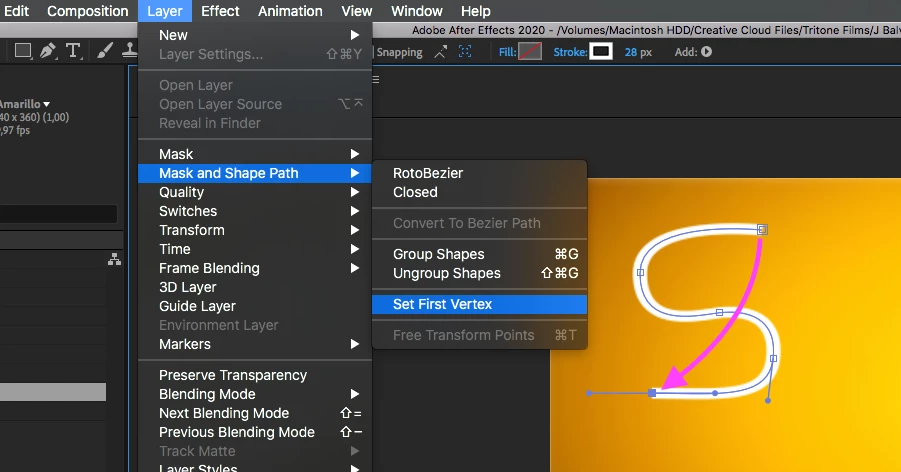

For morphing animations like that I would use Illustrator to set up the morph. You have a lot more control, it takes only a few minutes, and you can do things using AI that would take days to animate if you tried setting keyframes for a path. Here are two tutorials I did years ago. I've been using this technique since you could set up blends in Illustrator and expand them to layers.
If you don't want to do that try changing the first vertex, pick a portion that has a straight line and open, then close the path. You might even just select the path then cut it and paste it right back.

Setting the first vertex on an open path completely changes the path.
The only way I know of to set the first vertex of an open path to the other end of the line is to copy the path and paste it to a motion path, then time reverse the keyframes using the Keyframe Assistant, then copy the motion path and paste it to the vector path. You will get a position shift when you do but the shape will be the same except it will be out of position.

And, the second way, which cuts ane reconnects the path, doesn't work. The first vertex is automatically moved to the counterclockwise side of the path I cut, and when I change the first vertex, the counterclockwise side of the path is automatically reconnected.
Eventually, when I was trying your AI method, I found that the direction was turned correct after copying the path from AE to AI and copying it again from AI to AE. This way seems to me most simple and quick for now. Anyway, again I appreciate your idea and help.
