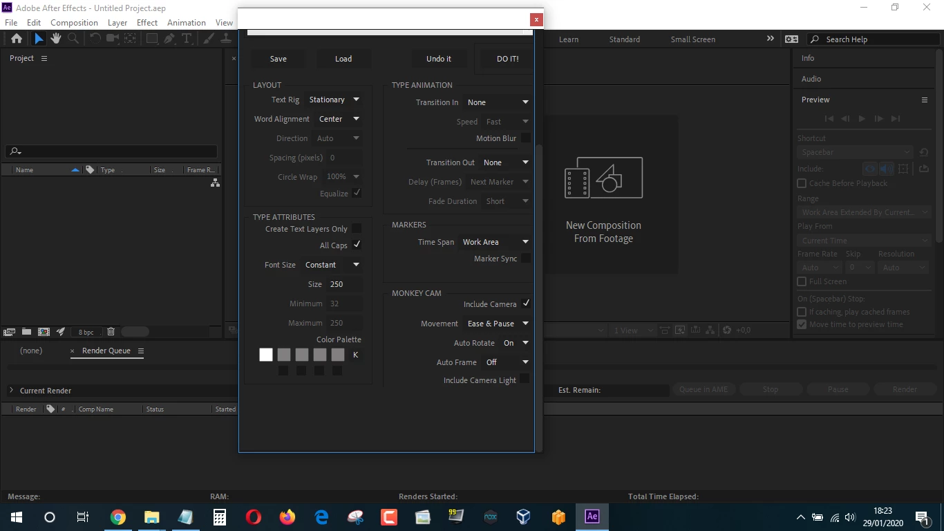

How can I scroll down inside a script UI panel in After Effects?
I don't know if the title makes sense, but I installed some scripts on After Effects, and some of them are bigger than my screen resolution and I can't access some options.
I just need to find a way to scroll down and see the rest of the panel to use the scripts properly.
My screen resolution is 1366x768.
Thanks!!

This is nothing you can fix yourself and in fact you'll run into trouble with other functions where panels get clipped off as well or buttons appear off-screen. You know, there's a reason why it's called "requirements", no offense. Of course script and plug-in developers will design their stuff to work within these predefined parameters. You might be able to contact the developers via AEScripts to see if they can provide an alternate version, but to be honest, it would probably make more sense and see if you can forcibly increase the screen resolution or at least create a suitably sized virtual desktop, even if reading tiny aliased text may be a pain.

Ok, I figured it out.
If you go on "Panel Group Settings" and select "Stacked Panel Group" and then drag the inner panel down a scrollbar appears.
