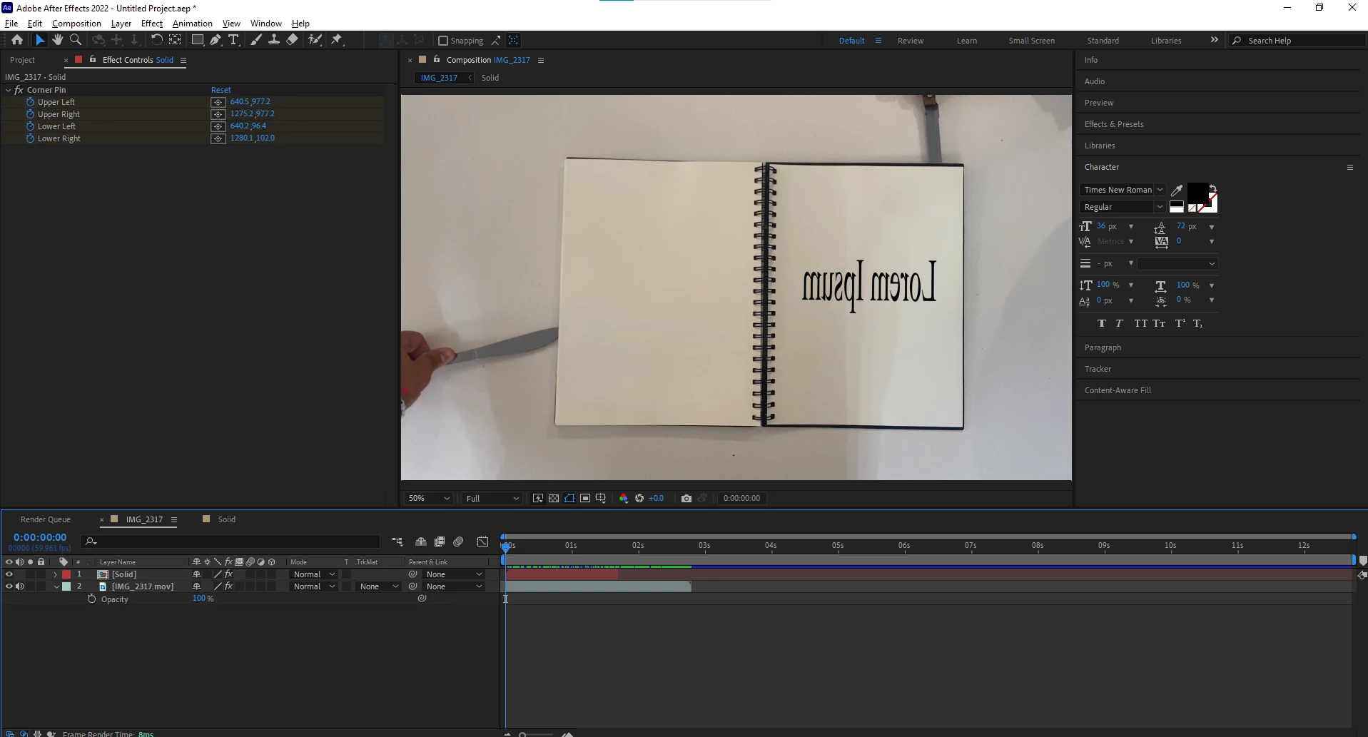

So I did what you said. I used mocha and had to fix the corner points and perspective basically each frame, but I had a good looking tracking at the end. The only problem I had was with this. I need to place some text and images, but everything I place on the solid that has the tracking data (Or any layer that has been affected by the tracking) transforms like this. I guess i could just reflect it, but its there any way to fix it without that?

Such stuff is simply not possible in a fully automated process. You have to manually matchmove. That's why VFX movies have armies of matchmovers that do this for a living. In your case you should be able to get almost two thirds tracked successfully and only have to animate the end segment by hand. Other than that a lot of such stuff is simply full on 3D with the actors just mocking the motion and then the assets being generated in a 3D program.
