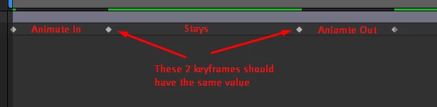

How do I bring an image in, and then let is stay on screen for a few seconds, and then move it out?
  • August 22, 2022
  • 618 views
I know about the position option, but when I add a third keyframe, my image slowly moves away when I put that third keyframe, how do I keep it still on the scene for a few seconds and then move it away off screen?

Hi nawid24923312c8ju,
Thanks for writing in.
You'd need to put 4 keyframes. 2nd and 3rd keyframes would have the exact same value and the distance between them will decide how long the image stays on the screen before it starts to animate out. Here's a screenshot that could help.
Let us know if this is not what you're looking for.
Nishu
