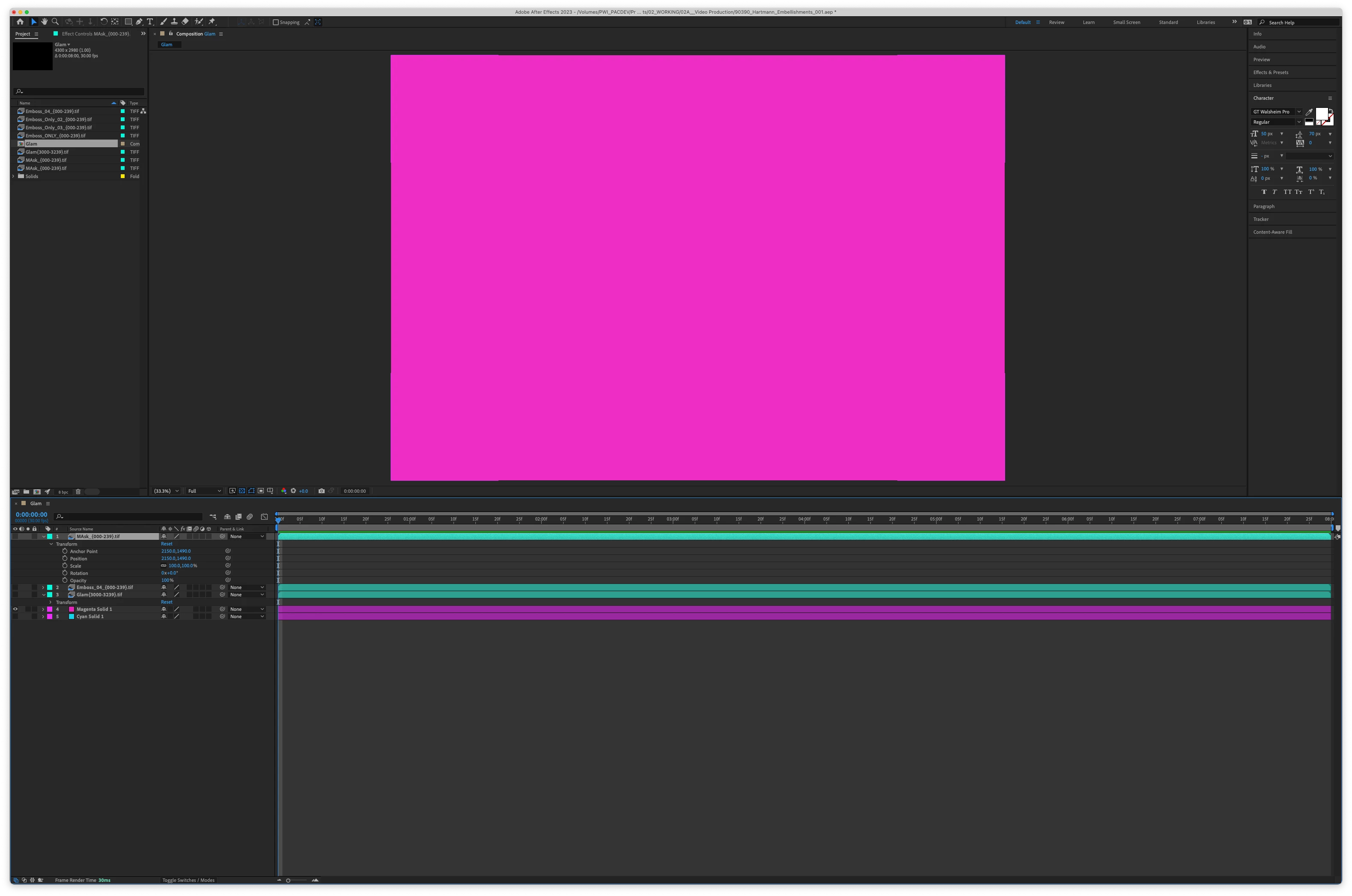

First is Magenta Background (so I know when the key works)

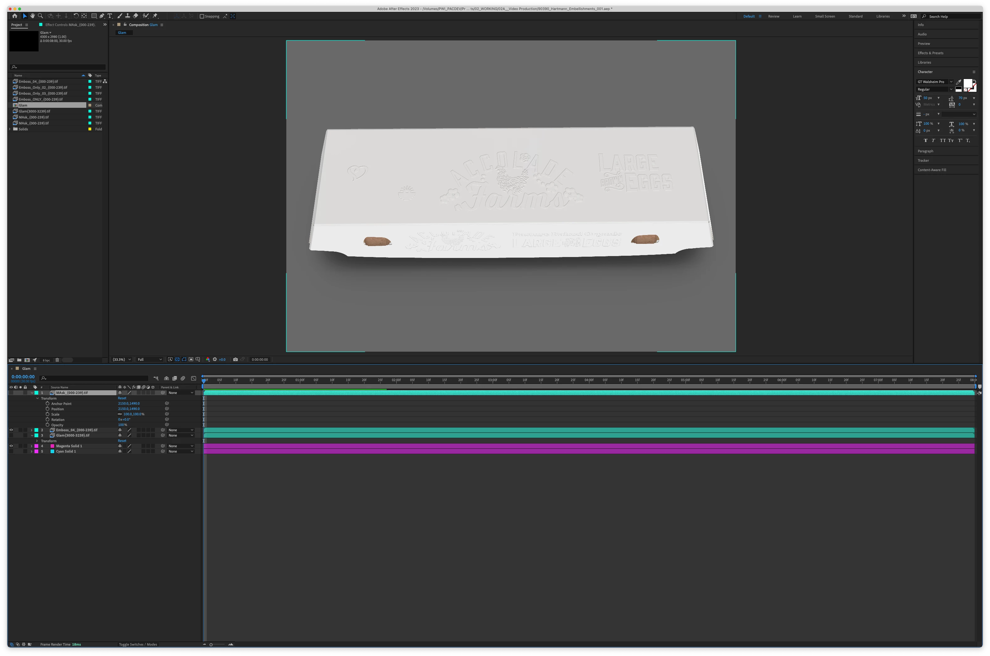

Second is subject (this version has no color/graphics, but you get the idea of what I want to crop)

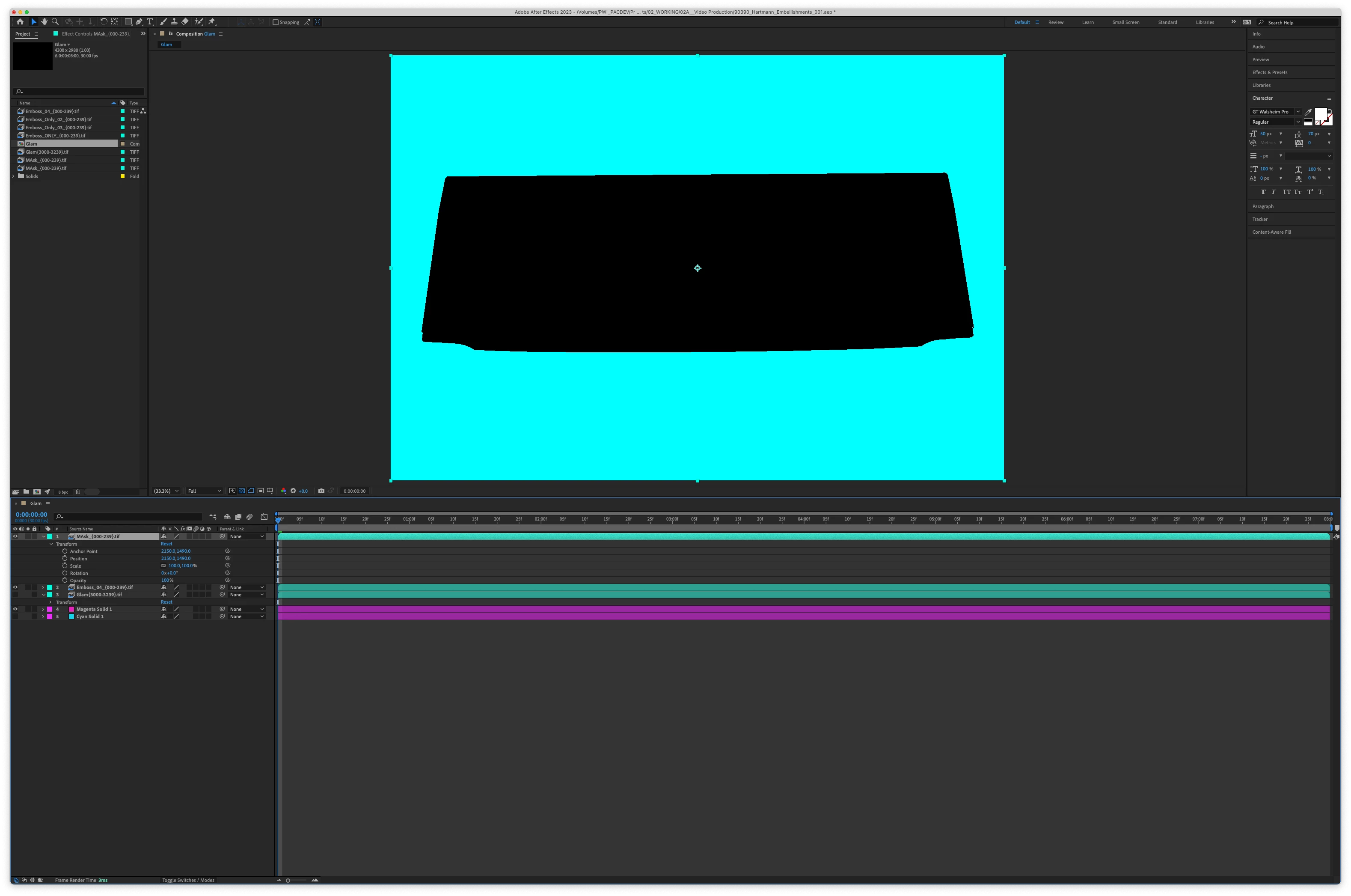

Third is 'Mask' footage - basically the black is for the subject, and the Cyan is what should be 'see through'...
