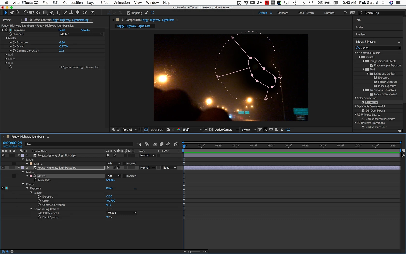

January 16, 2018
The light from the streetlights is providing most of the illumination in your scene. If you want them all to blink on and off at the same time you could animate a curves or levels effect or even exposure.
if you want to turn them off and on at random then you could experiment with some soft edge masks and compositing options in the effect so that only some of the lights dim and turn off. The hard part will be setting up the planes in the shot that are illuminated by different lights so it really looks like the lights are going out. You'll want to mask out or duplicate things that are not illuminated by the streetlights like the road signs. This will require some masking, or if the camera is moving, some rotoscope and duplicate layers or masks used with the compositing options.
That's about all I can give you without some more details on the shot and exactly what you are trying to achieve. A single light going out comp might look something like this:
This is just a start. I'm guessing that the camera is moving and that you'll need to do some tracking and some roto to get the shot to work properly, but this should at least get you started. If I were to end up with 4 streetlights that randomly shut off in a 7-second shot I could easily end up with 20 layers before the composite worked well enough to look realistic.
