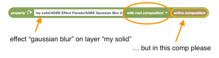

Being that clicking the refresh button is not useful to me because the comp names will always be different, how would I disable or enable specific effects in a layer, when I won't know ahead of time what the comp name is? I realized the method I used alters ALL the effects on a layer, but there is one effect I would like to start off as disabled.
Do you mean the layer name will be the same, but the comp name not?
In the image above, I showed how to use the "with root layer" option, to change the layer dynamically.
You can also set this option to "with root composition" to only change the comp dynamically:

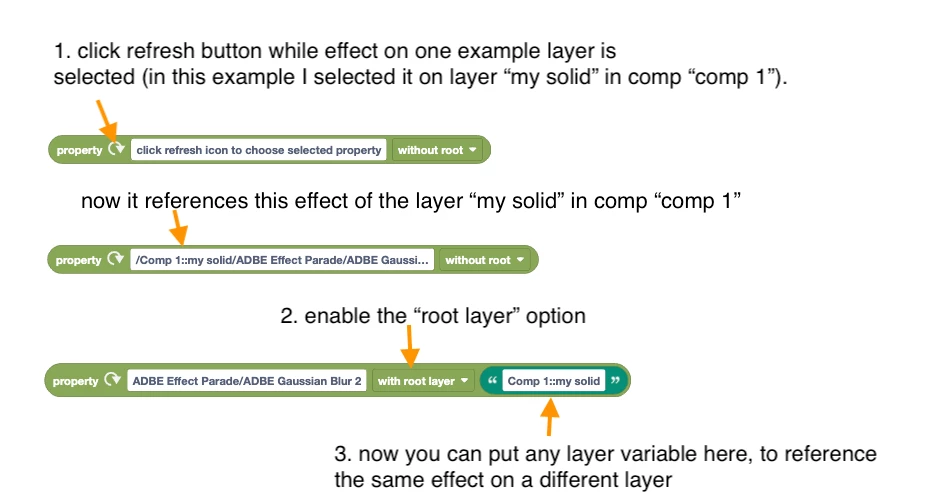

Extra tip:
If you want to access a particular effect, but on different layers, you can use the "root layer" option to adjust the layer dynamically.
Tip 2
Also note that you can access layers and effects by match name, name or index.
The refresh button uses match names, but instead of
"ADBE Effect Parade/ADBE Gaussian Blur 2"
you could also write
"Effects/Gaussian Blur"
or
"Effects/1"
to access the first effect.
If you use names like "Effects" instead of "ADBE Effect Parade", just notice that you tool won't be combatible with Ae versions in other languages, where this property has a different name.
