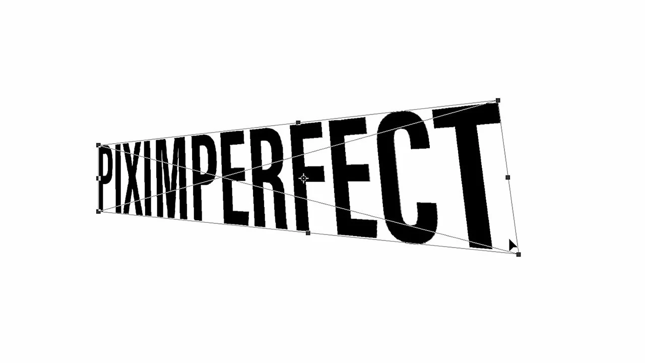

I want to be able to have one side of the text be smaller than the other (essentially skewing the text) seems like all I should have to do is be able to move each corner of the text so I manually skew it by moving the corners independantly but when you grab a corner and move it all the corners move in unison. It seems so simple compared to the other things I can do with after effects yet somehow I seem stumped.
Feels like I'm overthinking it and I already know how to do what I'm having a brain fart. I know how to do it in photoshop but I can't seem to do it in After Effects. Any ideas? I've tried using corner pin effect yet I don't find it that usable for what I'm trying to do

Corner Pin is way to go as is Mesh Warp, Bezier Warp and whatever you fancy. The only caveat may be that you may have to pre-compose the text to get correct results. Everything else would require a better explanation of what you are actualyl trying to achieve. Just saying that things don't turn out as you expect is no good way of asking for help.

so I'm editing for a steamer, and they want me to annotate/subtitle actions within the gameplay they have provided (like bullets flying over their head in the game they are playing) I want to add a bit of text to each bullet flying over their head to amplify the escalation of the scene. In the bit I am editing, they are being fired at the from where they were looking, so I will be scaling the text down to a small size, adding motion blur to it and scaling up (and also key framing the positioning of it) so it gives the effect of the text flying past the screen and getting closer (until it exits frames) however I want to skew the text so it looks warped slightly to add to the effect which was why I was asking for the effect.
I was wondering if it's possible to skew the text just by moving the corners (like you can in photoshop for example) so it would be easier to annotate each bullet rather than having to skew each bullet differently using various sliders on the effects tab (as the bullets all fly in different directions out of frame and I'll have to skew/warp/corner pin each one differently to the direction it is flying) so using sliders on a corner pin for example might make it very tedious considering there is probably about 50 different annotations.
I can simply turn the text into a 3D object and spin it on it's axis so one side is facing the screen but then I also wanted to skew the other side first so it looks like it's coming from a direction (like the picture I've provided where the laser is smaller from the source but gets larger as it reaches the perspective of the camera)
