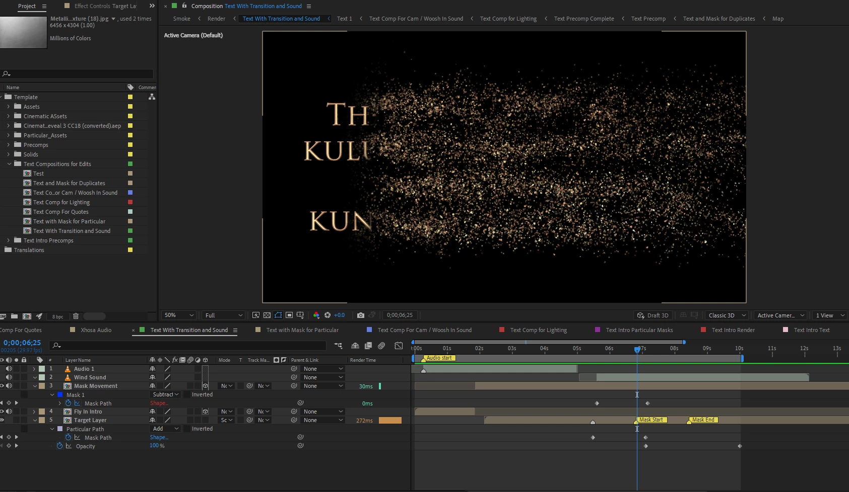

I'm a novice with After Effects, but managed to make a template that uses a projection map to create 3D looking text. It then uses Trapcode Particular to create a transition where the text disapears as if it's being thanos snapped.
My question is related to the following three compositions:
  1. Text With Transition and Sound.
The primary composition of my project is made up an audio layer that I need the other layers in this composition to sync to. The keyframes of the composition titled "Mask Movement" has keyframes for a mask path that covers the text at the same time the "Target Layer" has a mask that reveals the particles.
For this to look decent, the keyframes for the mask titled "Particular Path" have to be 15 frames forward from the end point of the audio layer. Additionally, the opacity key frames of the Target Layer have to start  when the keyframes of "Particular Path" end. The opacity keyframes take 3 seconds to complete.
Next,  the keyframes for the mask titled "Mask 1" in Mask Movement have to be 4 frames infront of the key frames for "Particular Path" (in other words the first frame of Mask 1 is 4 frames forward from the first keyframe of Particular Path). I currently have an expression attached to this mask that I believe is working for this
"target = thisComp.layer("Target Layer");
targetMask = target.mask("Particular Path").maskPath;
targetMask"
Lastly, there's a Wind Sound audio layer that must start at the beginning of the keyframes for "Mask 1".

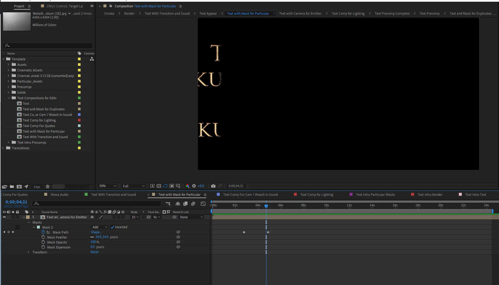

2. Text with Mask for Particular
This composition has only 1 layer that controls a mask that covers up the emitter for Trapcode Particular to make it so the particles slowly dissapear. To look decent, the keyframes for this emitter have to begin 18 frames before the keyframes for "Particular Path" begin.

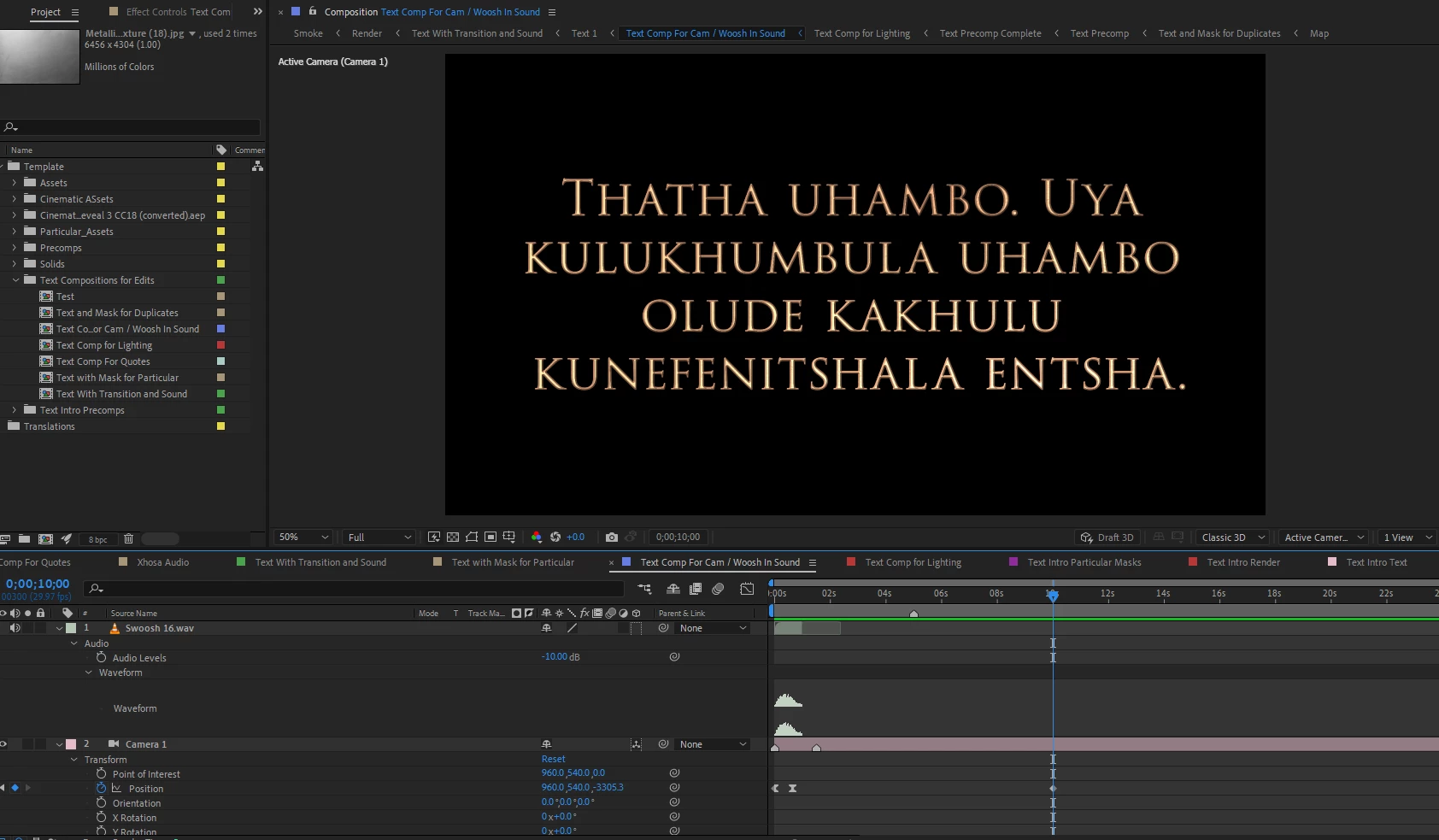

3.Text Comp For Cam / Woosh Sound
This composition has 3 layers, but the only one of note is "Camera 1" which slowly makes the camera move away from the text. The last keyframe for position of this layer has to occur at the same time as the last keyframe for opacity.
