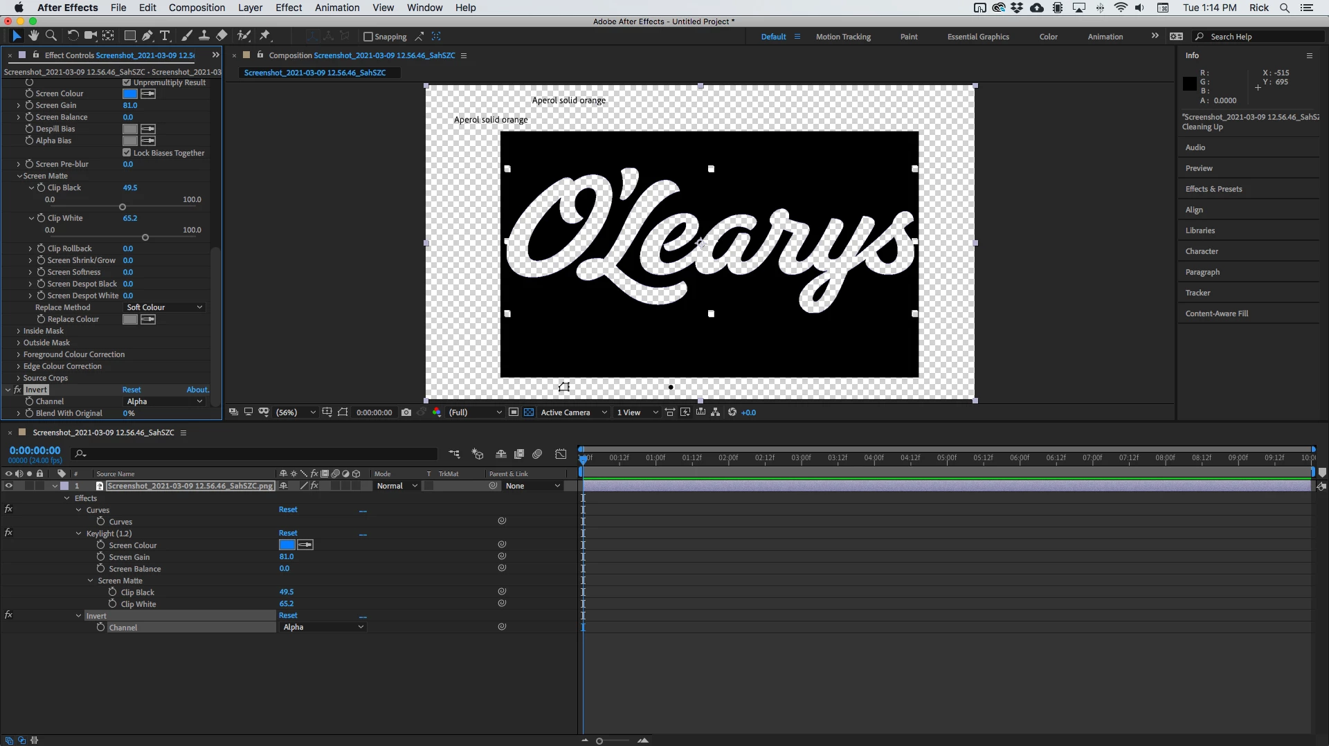

Thank you for the screenshots. I'm assuming that your PNG image, Layer 1, does not have transparency. If that is the case and you have a nice solid color Linear Key is a pretty ham-handed way of pulling a key, but it will work. I took a screenshot of your screenshot and I'm using that as layer 1. Here's how that looks with one click on the background color:
Here's one click on the Foreground color and it takes more samples so I wouldn't do that.
Notice the transparency grid is on so I can clearly see through the layer. Any layer I put below Layer 1 will now fill the hole. To invert the matte all you need to do is add Invert to the layer and select the alpha channel.
Personally, if I needed to pull a key from this image I probably would have used Curves + Keylight then Invert/Alpha if I needed a hole where the logo is.
You need to do a little image manipulation to get keylight to work but you have a lot more control over the edges.
If it was just a still image I would open it in Photoshop and remove the background and be done with it. It would save render time.
Solo your layer, check the transparency grid, and mouse over the transparent areas with the Info Panel open to check for the accuracy of the key. It should be 1 if your Info Panel is set to read decimal or 255 if it is set to 8-bit.

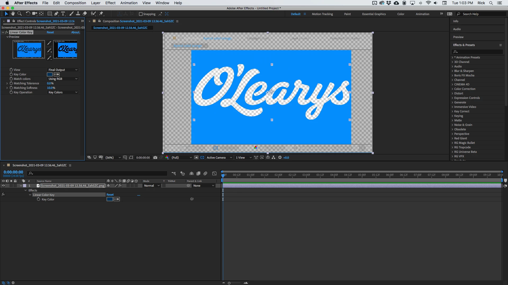

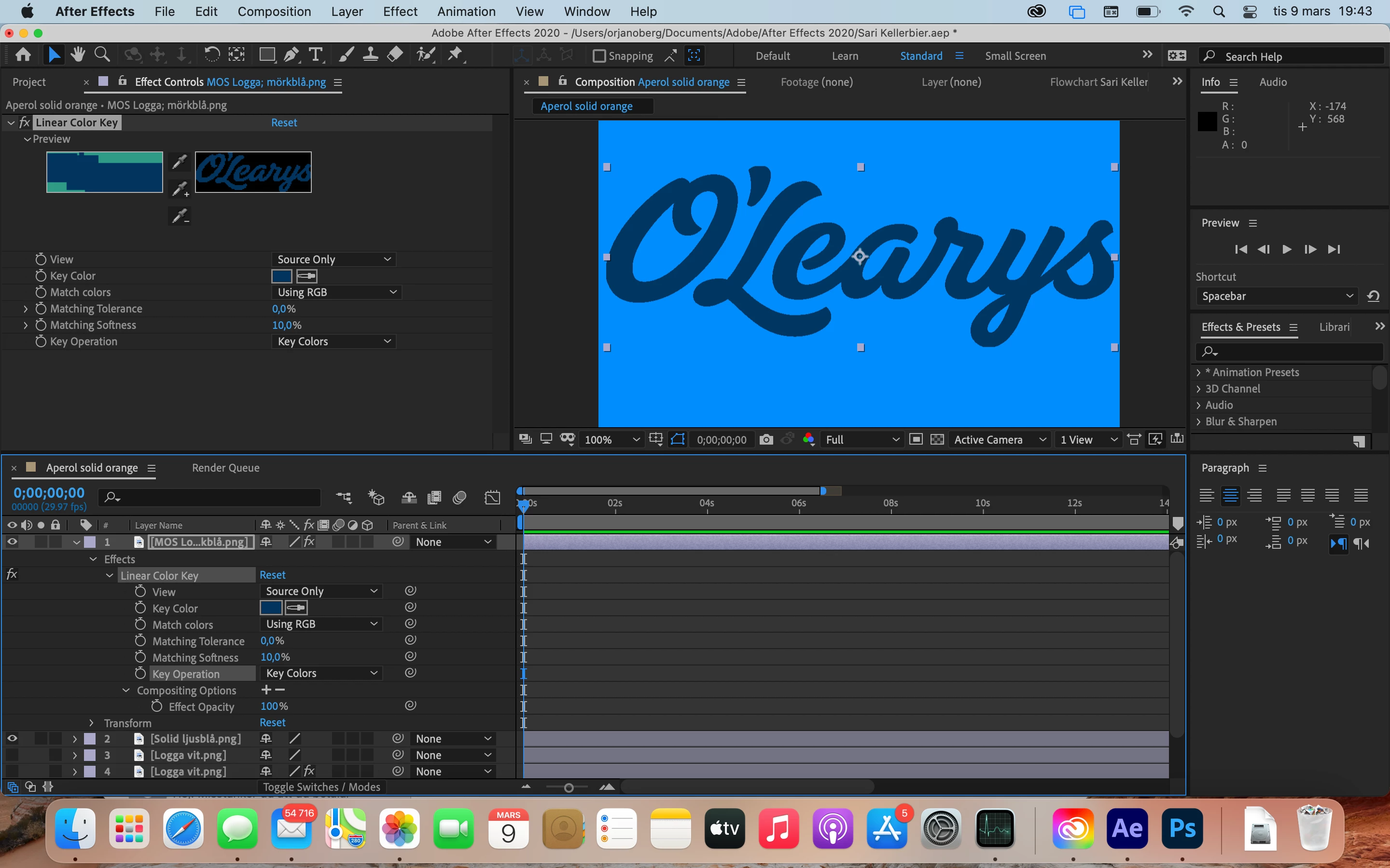

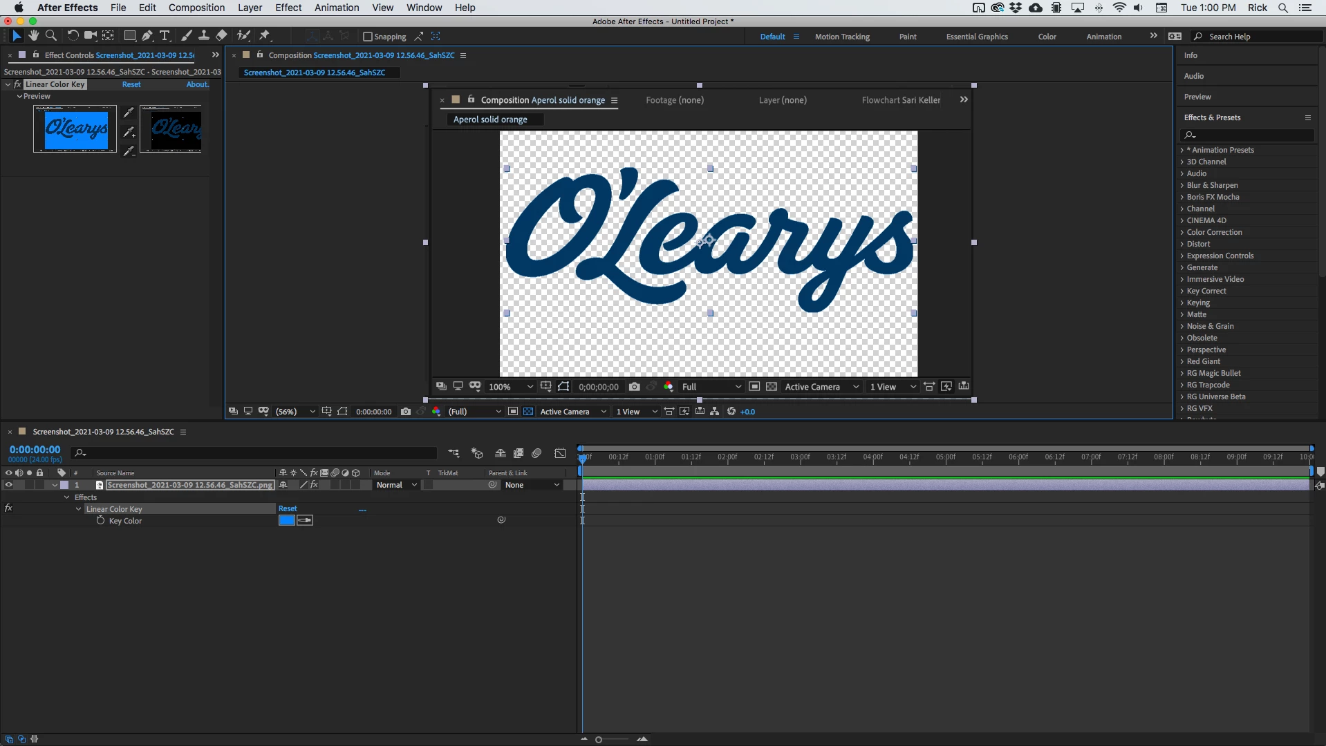

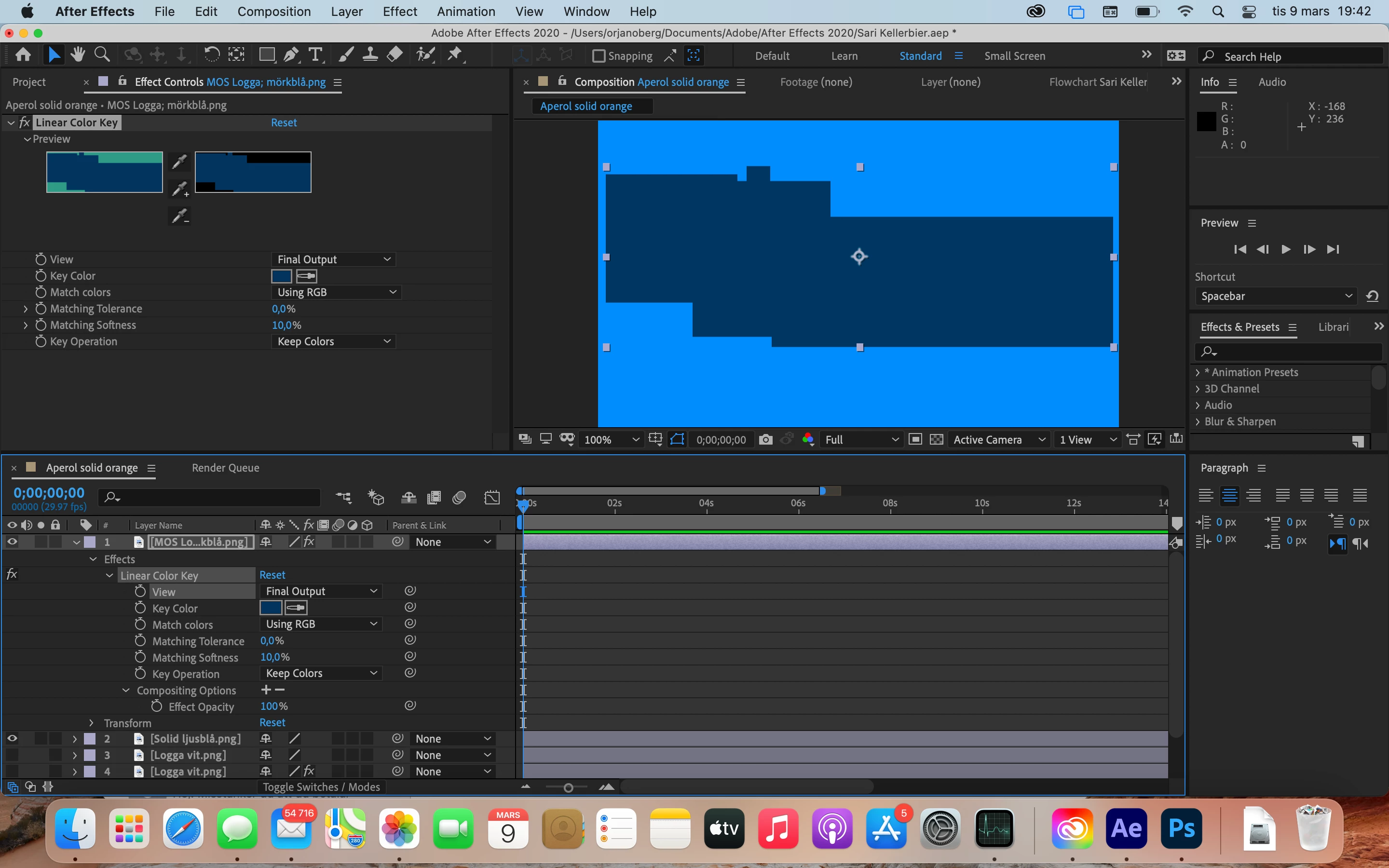

Sure. I have two screenshots. It seems ridicoulus...
The second picture is the inverted one. The light blue is supposed to fill the dark blue.
