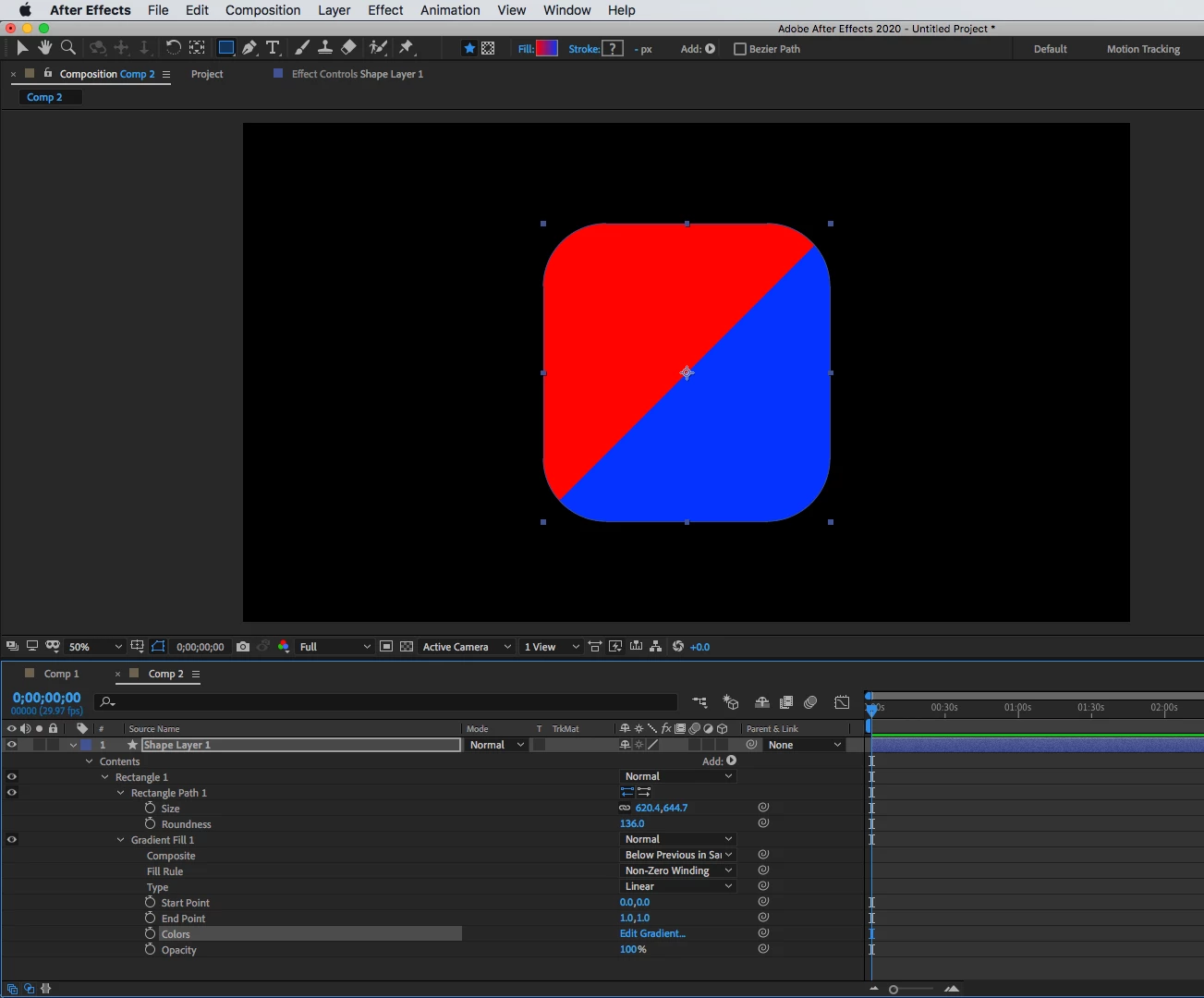

Hi there!
I was wondering how I can fill part of a shape layer. For instance. I have a rounded rectangle shape layer that is completely white. Now what would I have to do to fill half of the rounded rectangle in a different color?
I played around with masks but whatever I do, I cannot seem to get the result I am looking for.
Since it is a rounded rect (with a drop shadow effect), I can't really just draw 2 shapes and piece them together. It looks scuffed.
Thanks in advance.
December 31, 2020

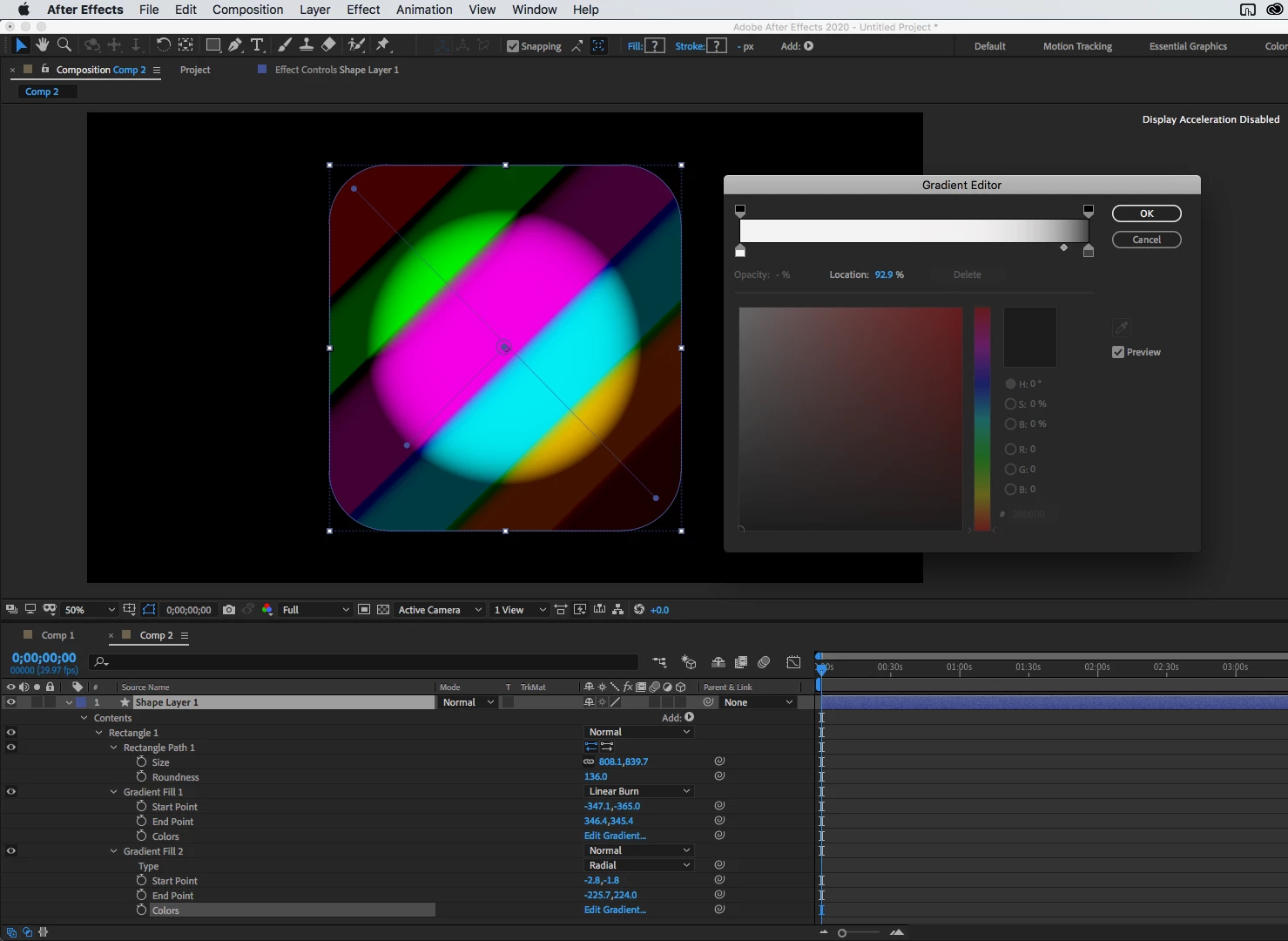

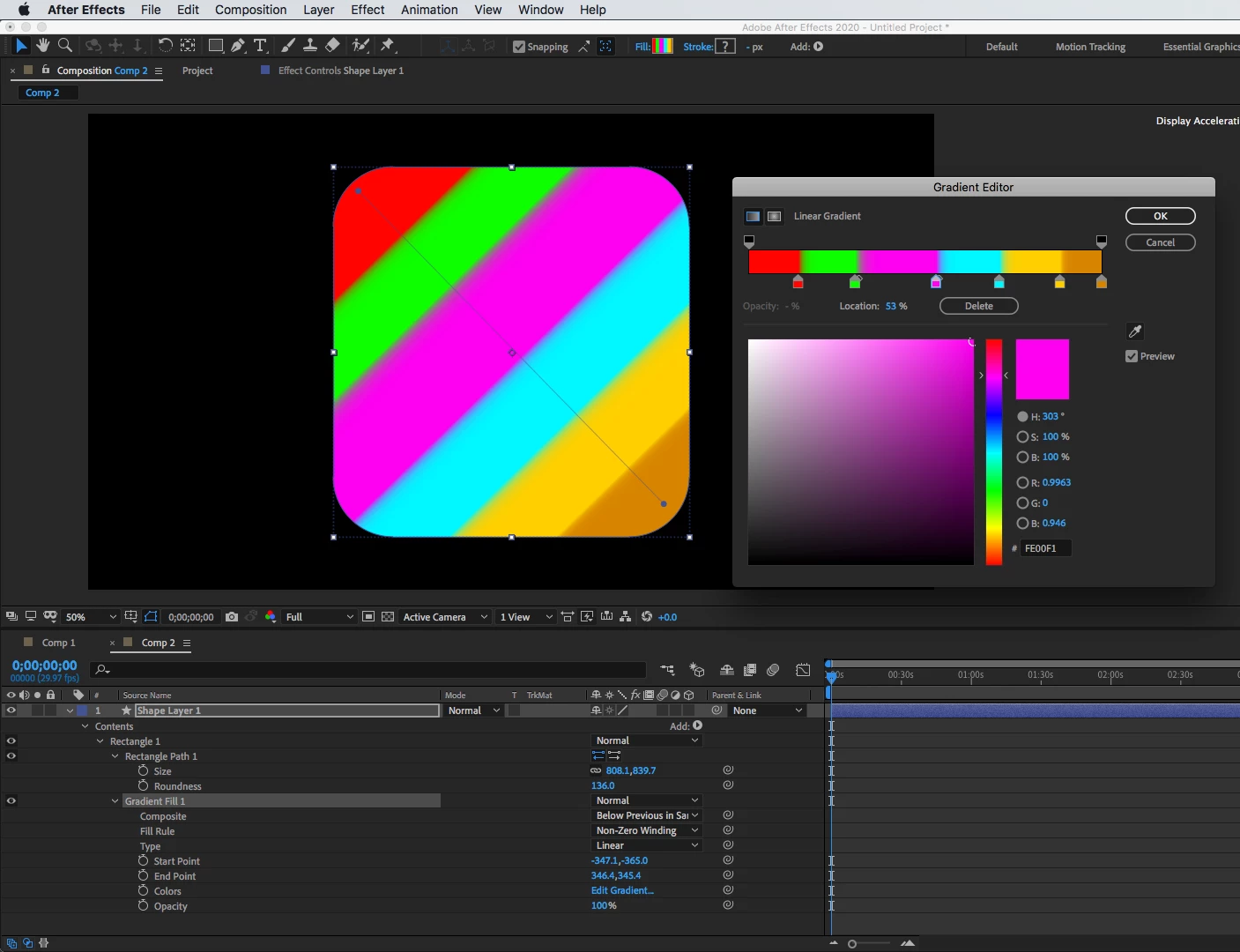

Remove the Fill, add a Gradient Fill. Set one end of the gradient to the first color, the other to the second color, then edit the start and endpoints. There's not much to it. You could even add multiple colors and slide the middle point right up next to the previous color. Check out these screenshots. You can even add multiple gradients and fills then use blend modes to combine them. I'm showing you all modifications to the layer.
That should get you started.

December 30, 2020
Actually you can click on fill for the shape (top of the screen) and choose a linear gradient and adjust the start and end points and position of the gradient onto the same point so it looks two tone
