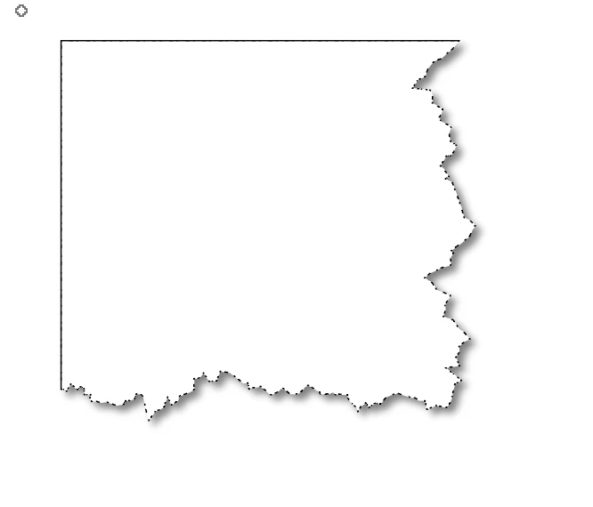

Thank you for the reply. I'm rather new to after effects, having done mostly 2d animation in it (no 3d). Will look into your suggestions.
The pieces of paper I intend to animate are 2D, made in illustrator:
