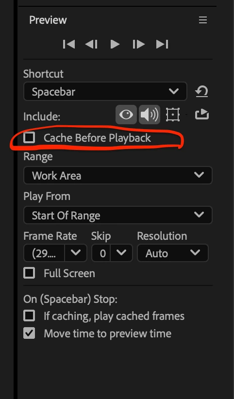

It sounds like you want to enable "Cache Before Playback".   This checkbox is located in the Preview panel.
It's also going to be helpful to make sure Composition > Preview > Cache Frames While idle is enabled.
If it seems that it's taking a long time to cache the Preview, try lowering the Composition Resolution to favor faster caching with lower image quality.   If Full Resolution previews are important, you may need to allow time for them to cache and use the Composition Profiler to identify Layers that are taking more time to render.
For playback speed, make sure that the Frame Rate pop-up menu in the Preview panel is set to "Auto" (the Composition frame rate will show in parenthesis is the Frame Rate dialog box).
December 2, 2024
As Warren said, enabling Cache Before Playback should solve the problem. You'll still have to wait for the frames to render.
It's also a good idea to set the Comp Panel resolution to Auto instead of Full when running previews.
