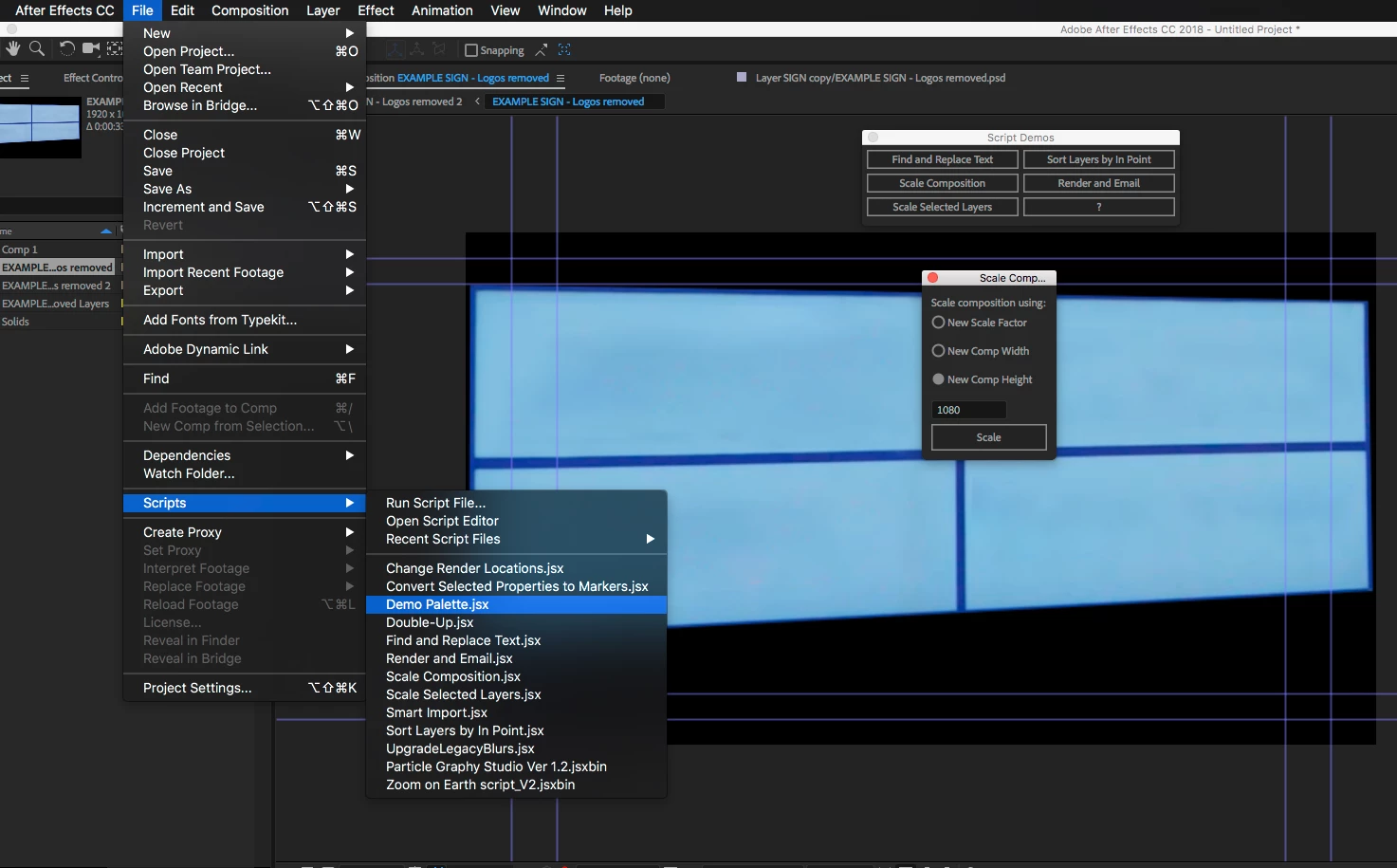

Here is another workaround thats pretty much hidden and that most people never get to see but is built into AE
Select File -->Scripts-->Demo Palette. This will open up a palette with a scale comp functionality. Select your comp in the timeline and presto. Very easy to use
Let me know
Mo

Interesting! You're right. I've been using AE for a long time at different companies working on many different projects and never knew about this
I will try it out and report back!

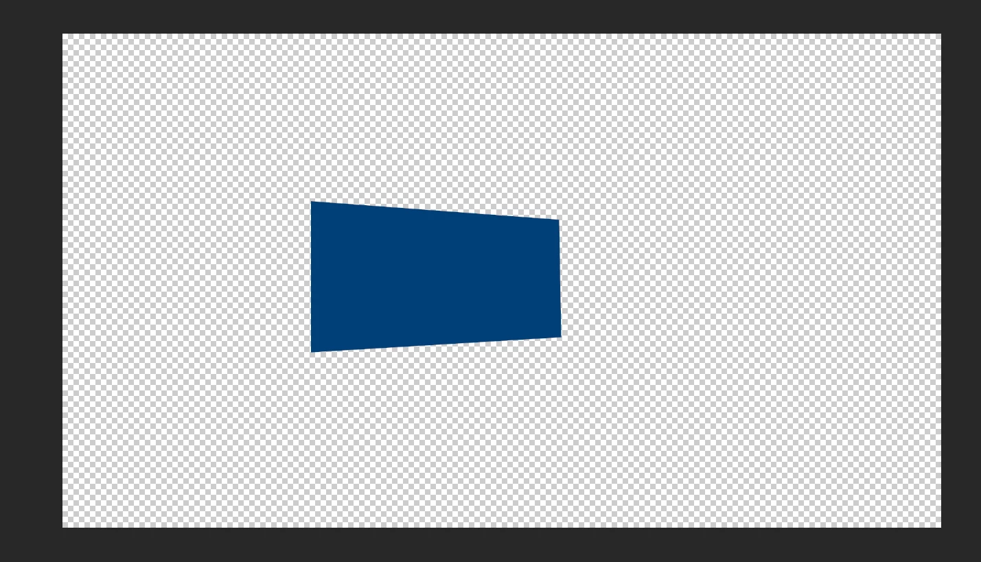

Yes, I understand. I'm not asking that though. I'm sorry for not explaining it well. My tracking data is perfect, there's no issue with that, there's also no issue with the precomp where the cornerpin data is. I'm asking about a way to make an image that's smaller than the documents frame size be as big as the comp. To make the actual corners of the sign within the frame scaled to match the corners of the comp.
For example, the image below shows a canvas size in photoshop of 1920x1080, but the blue shape is much smaller. Yes, I understand that the blue shape needs to be as big as the comp in order for the track to work properly. That's what I'm trying to do. I created my own version of the sign, using the still frame from the footage, so the result is that the new sign is exactly the same size as the original sign (because I used parts of the original sign to make the one one.) Now I'm trying to figure out a way to easily make the sign the full canvas size, either in photoshop, or by importing it into AE and doing it there:

2 ways:
1. In PS change the image size to got the comp or
2. Take the sign into AE, create 1080p comp and revise there
