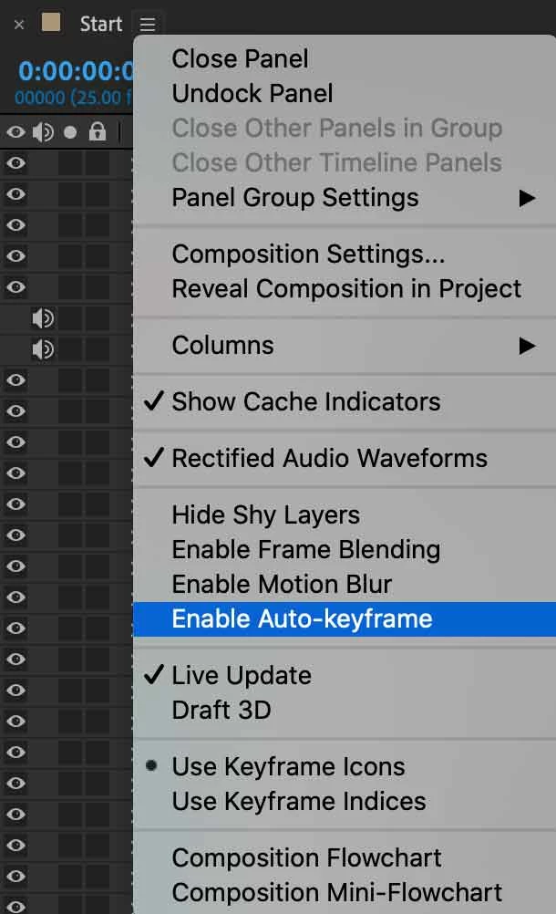

My version of After Effects now creates automatic keyframes.
If I change any parameter, even though I have NOT toggled the stopwatch it will automatically toggle the stop watch and make keyframes.
How do I turn this feature off?

    Correct answer Mike_Abbott
    Thanks for that. You are correct auto keyframe is on.
    However there does not seem to be a way of switching it off here.
    Should I be able to click this icon and turn it on and off?
    If so its not happening.
    Select it from the menu and that will uncheck it (turn it off) for  new properties.
    Any properties that are already animating will need to have their blue stop watches clicked off manually.

    Hi , I cannot check off the AUTO KEY FRAME MODE  from the manu after clicking it also. It is always SELECTED.
    I am using AE CC20. Kindly help

    I understand you. So listen to me please.
    In the timeline, click on the icon that is beside of compositon's name. then a menu apears that you should click on Enable Auto-Keyframe.
    December 22, 2020
    Hi. I enable it by mistake and now I can´t find the menu you posted. Could you tell where I'm supposed to click on, please? Thank you.

    So... do we have to guess what version of after effects you have... or are you going to tell us?

    Hi, thanks for the question. Its After Effects CC (2017)

    OK. In the timeline, look at the panel menu - the three horizontal lines in the tab. You've probably got: "Enable Auto Keyframing" on.
    Select it to switch it off.
