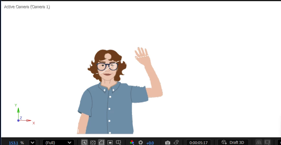

    My project setting was GPU accelerated! I switched it to software only but I had already fixed my issue so not sure if that helped. I found out that the white line was because my character moved after the pins were placed (it zooms in so the scale gets bigger). To fix that I had to delete my pins and increase the size of my mesh and then redo the pins. I ended up just doing the puppet effect once my character stopped moving to avoid further issues.

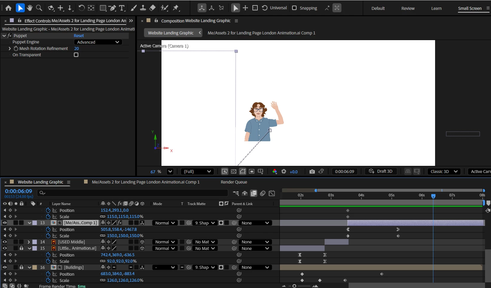

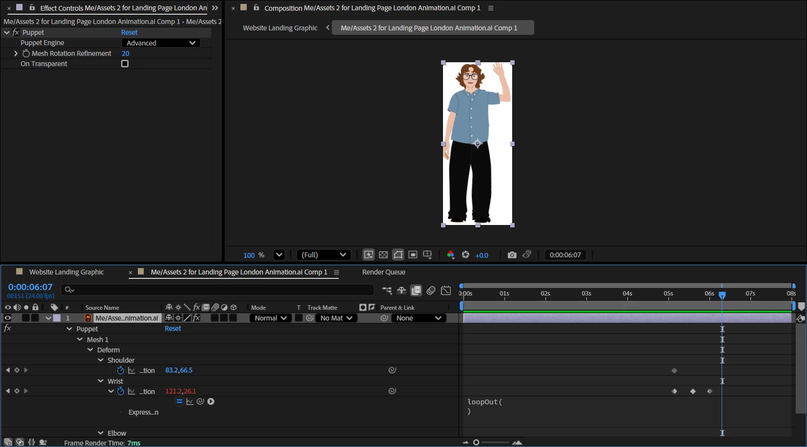

    I’m having this same issue trying to use the puppet tool on a pre-comped vector character while enabling Continuous Rasterization in both the pre-comp and the main composition (if I have it on just in only one it turns out blurry). I tried it previously with CR only on in the pre-comp and rendering it out of Media Encoder still was blurry. Now I’m trying CR on in both comps and it’s turning off the puppet effect and also producing a weird white line across my comp? I also noticed that when turning CR on in the main composition it made my character a lot smaller and I had to adjust the scale again.

    I attached screenshots of the weird line that appears and my workspace for each comp.
