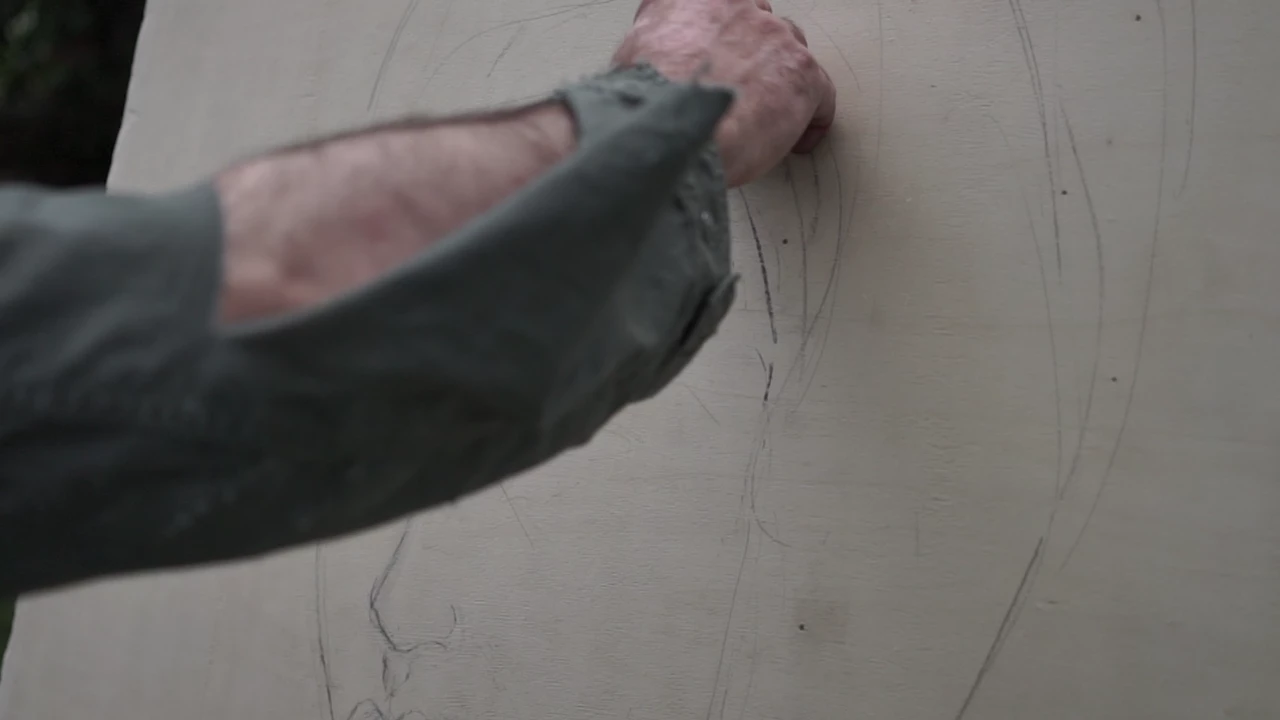

Thanks a lot for your great response
Here is my footage:  Animated GIF - Find & Share on GIPHY
The scene will be cut to other shoot after drawing 1 line and will come back fastly while other line is drawing. After 4 cuts there will be no more need to hide the sketch because of actual drawing
So I just need to handle this about 7 seconds only while he is drawing actual lines

May 28, 2018
the method I described will be suitable for you. for rotoscoping, if the movement is this fast in real-time and not because of your GIF export, then this will be rather easy using Rotobrush. nevertheless, as I said, this is no beginner stuff and to pull this off successfully will require a lot of practice or a professional.
