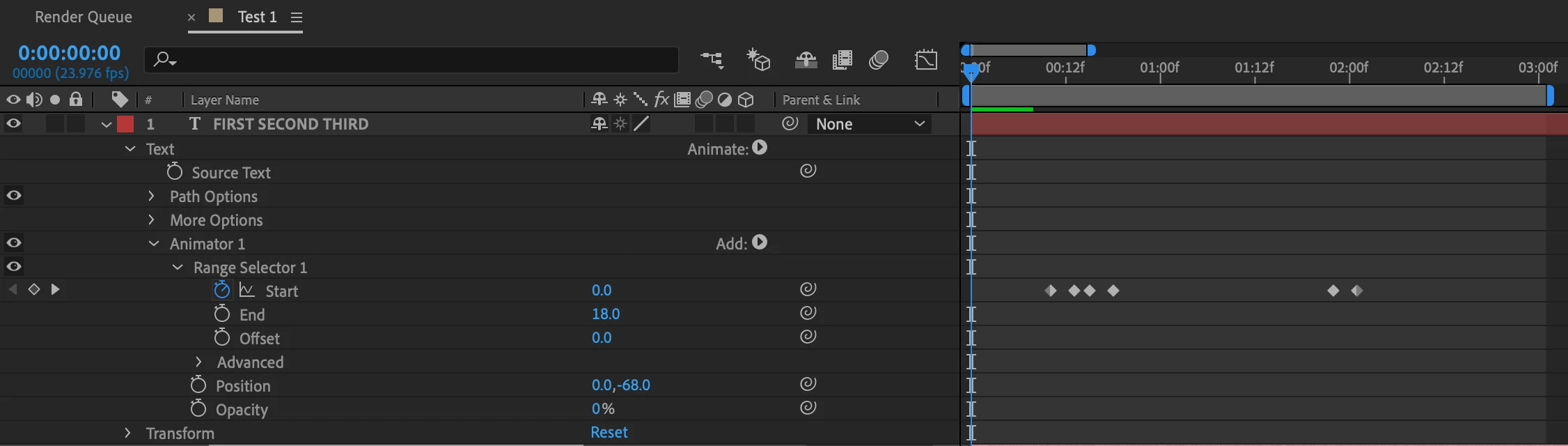

This first one is a normal text animation with a range selector where the words come in at different times.
There is no overshoot or bounce on this version but I have the ability to control the timing of the animation with keyframes.
Here is the layer properties for this example:

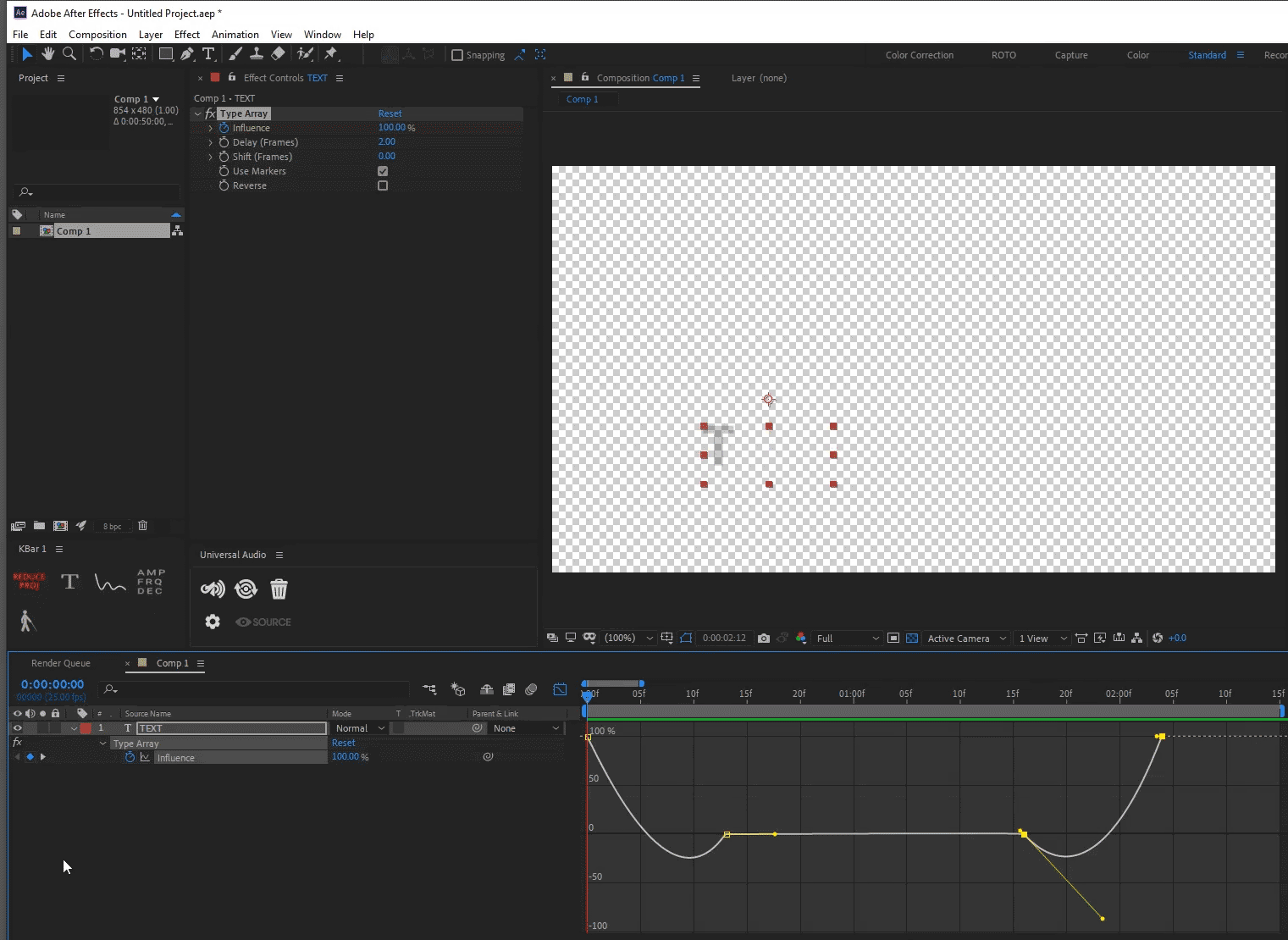

Correct answer Roei Tzoref
use this preset:
https://paulslemmer.com/type-array
use the graph or any inertia/bounce expression on the influence parameter:

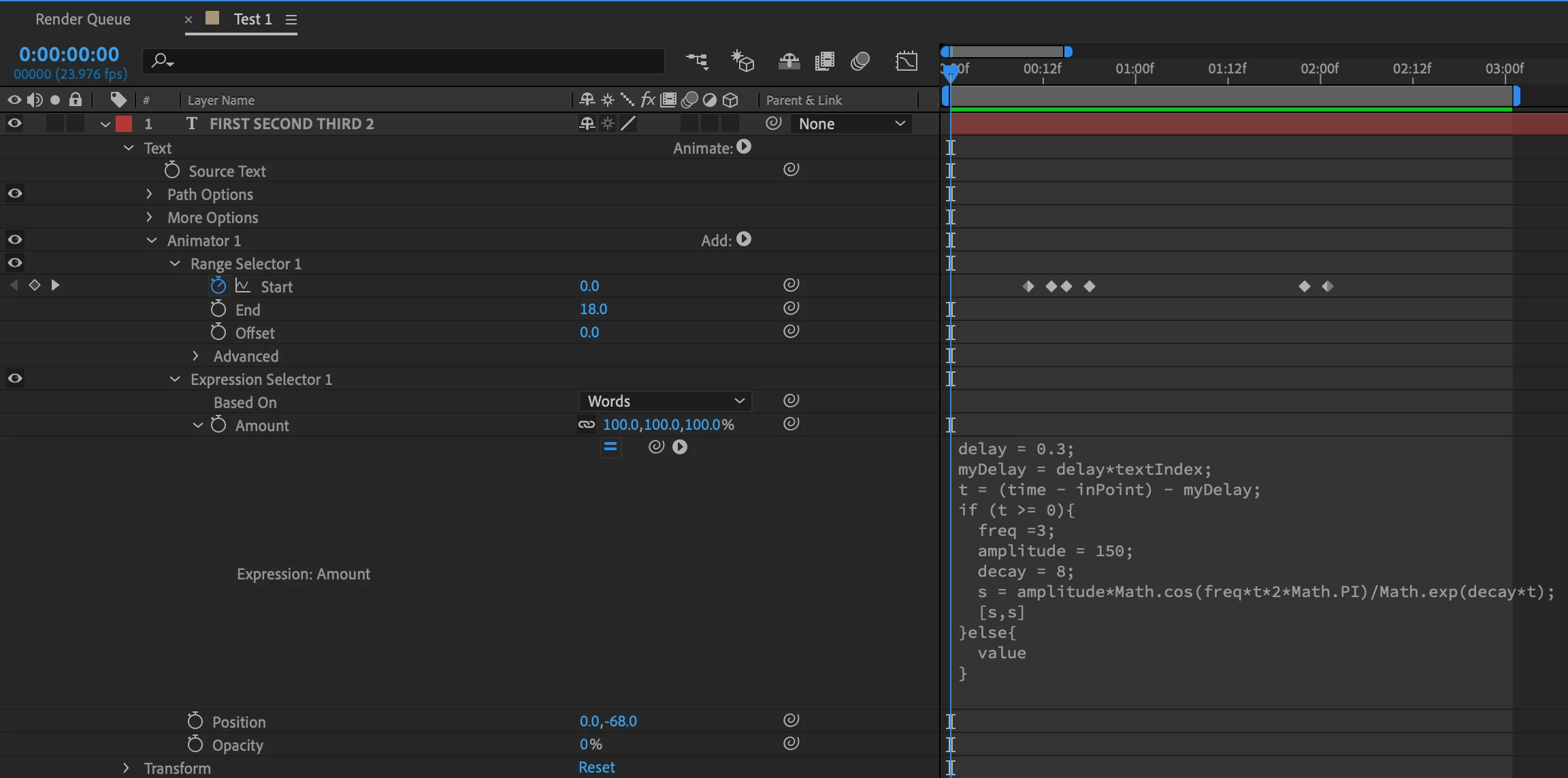

February 6, 2022
Delete your range selector and replace it wtih an expression selector. Put this code in your expression selector's "amount" property. You can edit the delay, frequenccy, amplitude and decay to time it and change the other characteristics of the bounce. I'd pickwhip those values to slider controls in your effects panel so you can keyframe them and edit more easily in general. You can even select all your sliders and the new text animator in your layers and save them as a new effect so you don't need to set it up again in the future.
delay = .1;
myDelay = delay*textIndex;
t = (time - inPoint) - myDelay;
if (t>=0){
freq =3;
amplitude = 150;
decay = 8.0;
s = amplitude*Math.cos(freq*t*2*Math.PI)/Math.exp(decay*t);
{s,s}
}else{
value
The_Inky
June 14, 2023
So if you did use this expression, how would you change the timing on when you want the animation to end? Obviously for the start you can just slide the layer down the timeline, but to control the length of the animation there is no keyframe data to tell it how long you want it to last.
