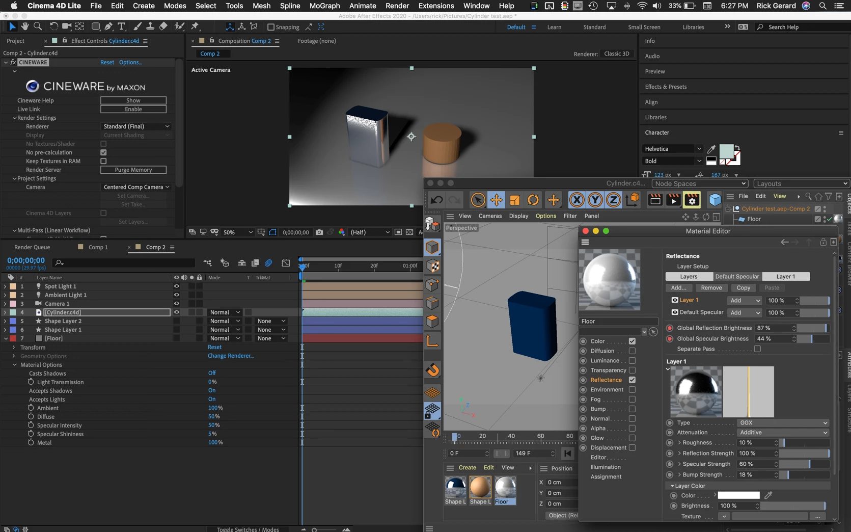

If you can live with the render times you can just change the comp rendering option to C4D, extrude some solids tying the height to the extrusion depth, turning on Casts Shadows (off by default) for the layers and setting the floor's reflection properties like this:
I am showing you all of the modified material options for the layers. The strength and look of the reflection can be adjusted.
Another option using just AE's standard tools would be to change the Comp Rendering Engine back to Classic 3d, export a C4D file, then set up your material options and animate the extrusion in C4D Lite. You have a lot better control over the extrusion and the materials in C4D Lite.
There are even more options if you have one of the many 3rd party plugins that support 3D objects. I use Video Copilot's Element 3D. It's easier and more powerful than C4D lite for this kind of work. Both of those 3D solutions will render faster than it will when you set the Comp to the C4D rendering engine.
These two examples took me about 15 minutes to set up.
