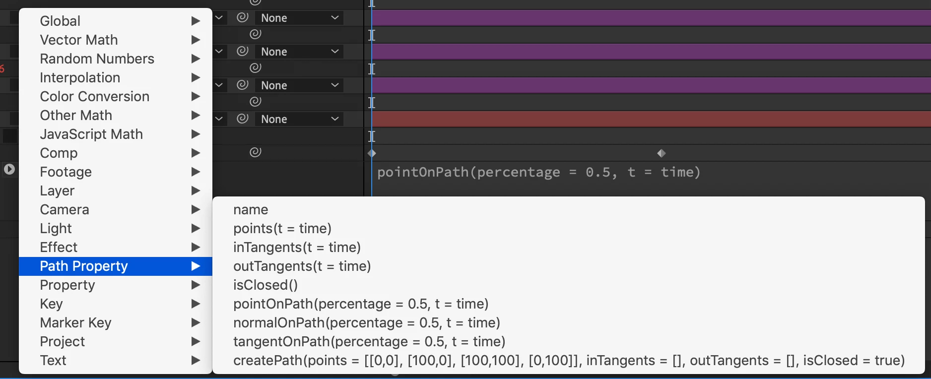

The loopOut() method only works for numerical values or numerical arrays. Mask keyframes contain complex vector information and none of the looping or traditional math functions will work with masks. There are very few options for creating expressions that will work with masks. You can find most of the methods that will work directly on masks in the Expression Language menu in the timeline.
Unfortunately, there is very little documentation yet on using these methods and you can't just click on one and apply it.
