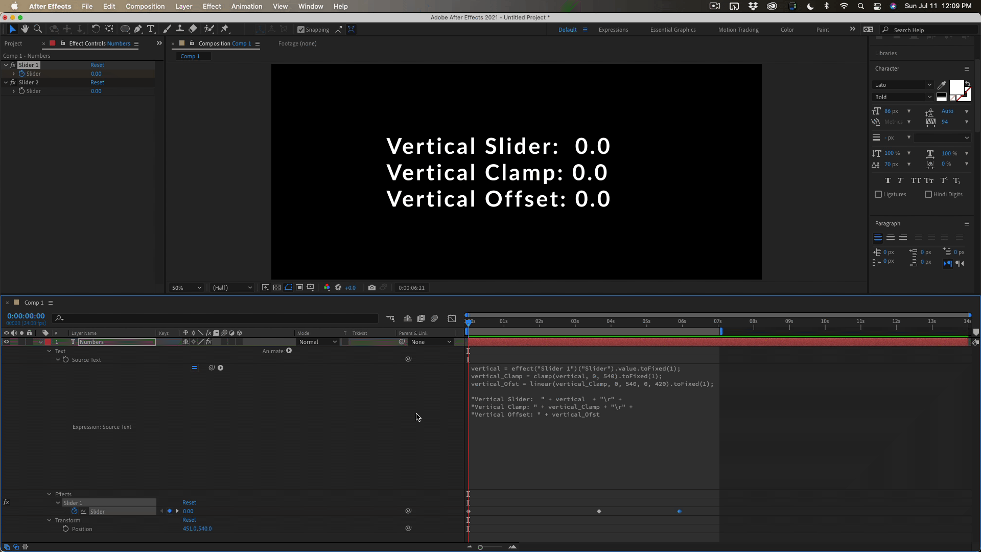

You just need to declare some variables. Here's the code on a text layer and the resulting values:
vertical = effect("Slider 1")("Slider").value.toFixed(1);
vertical_Clamp = clamp(vertical, 0, 540).toFixed(1);
vertical_Ofst = linear(vertical_Clamp, 0, 540, 0, 420).toFixed(1);
// the following code displays the values for the variables
"Vertical Slider:  " + vertical  + "\r" +
"Vertical Clamp: " + vertical_Clamp + "\r" +
"Vertical Offset: " + vertical_Ofst
Plug those variables into your expression and it should work. I added clamp(1) to the end of each variable to clean up the text display. You can delete it unless you want pixel-level rounding.
Bram Hoekstra
July 11, 2021
Thank you very much!
This is exactly what I meant!
