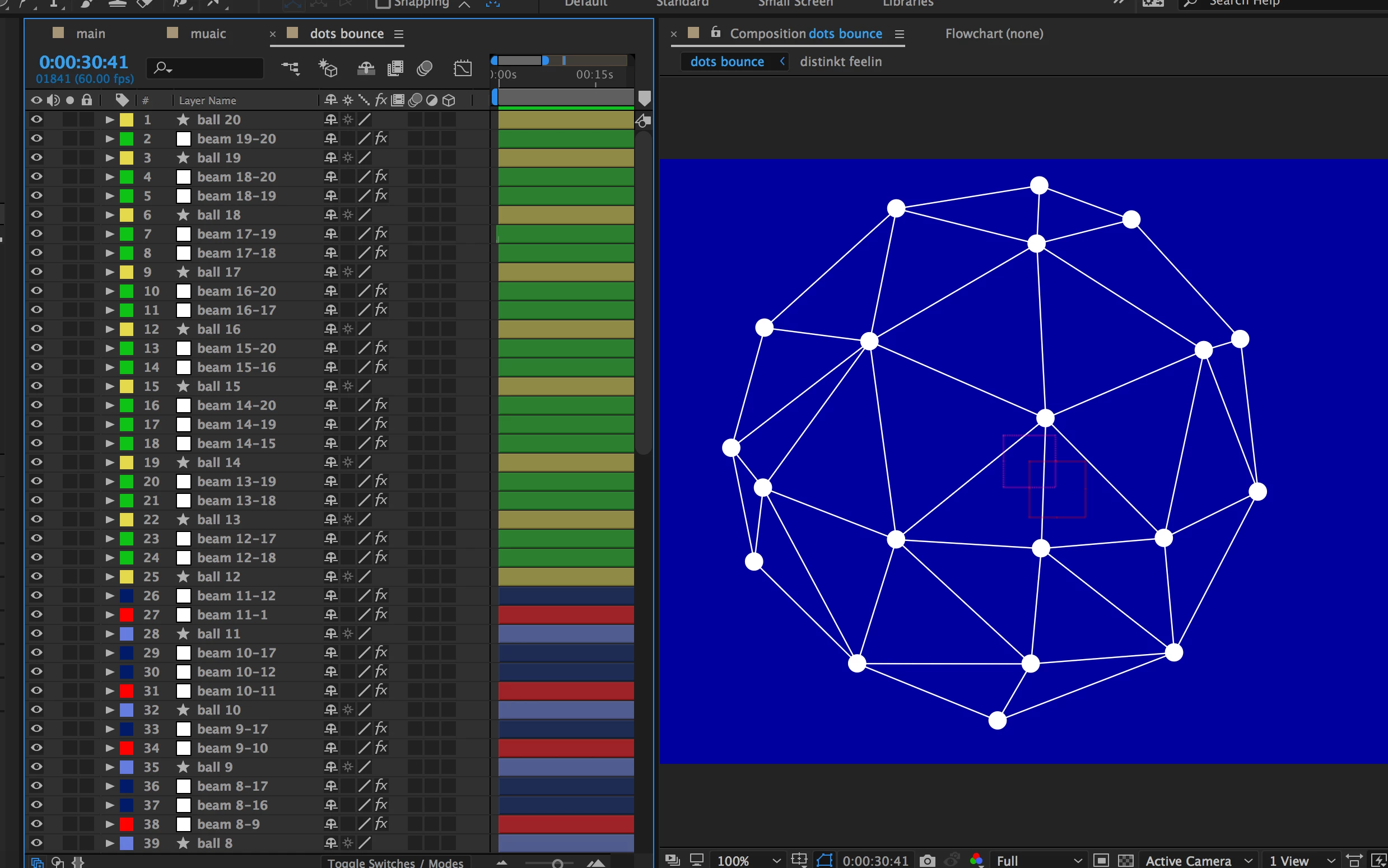

I am trying to make the outer ring of dots in the polygon below move away from the central point of the composition when the scale of the null object changes. The null object is changing its scale based on audio keyframes.
I wanted the dots to move in reaction to the audio and this is the only way I can think of to do this. When I pickwhip the position value of the dots to the scale of the null object they do what I expected and bunch into the top corner of the composition.
Any help would be much appreciated as I'm well and truly stuck at this point.

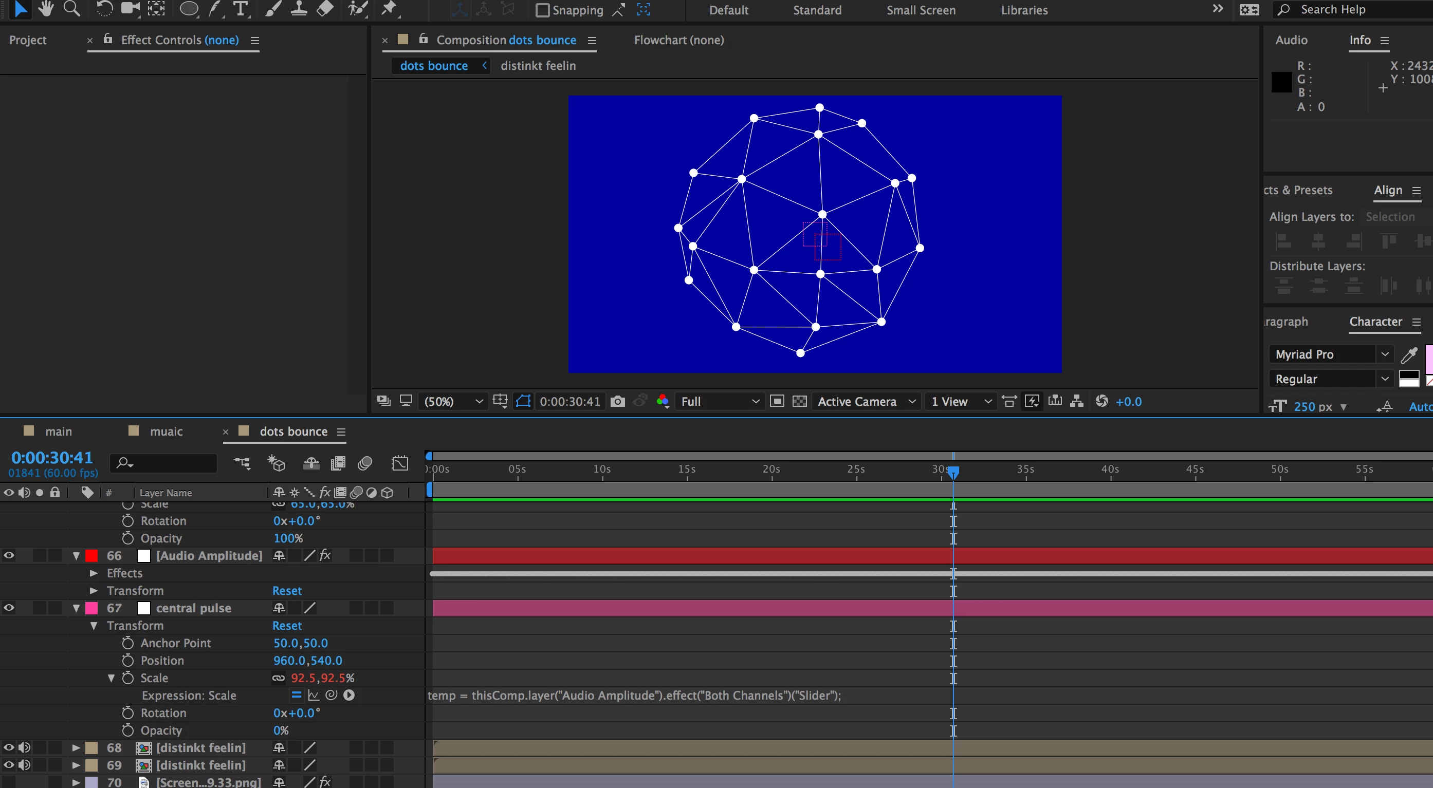

You need to add the original position value of the points to the expression. Your expression should be like this:
temp = thisComp.layer("Amplitud de audio").effect("Ambos canales")("Deslizador");
[temp+value[0], temp+value[1]]
Anyway, i think this is not what you are looking for. I think the best way to do this is to link the outer dots to a new null object via parenting, and link the scale of this new null to the scale of the "Central Pulse" layer via expression.

This is pretty much what I'm trying to do. So do I need to apply your expression to the central pulse layer and then add the values for the individual dots?
Jose Panadero
August 2, 2017
The expression is only to apply to individual dots in case you don't link those dots to a new null. But I think the offset will be always in the positive ranges of position values so i'm not sure this is what you need.
The second way to do it is to link the outer dots to a null, then link the scale of the null to the audio keyframes in the Audio Amplitude layer.
