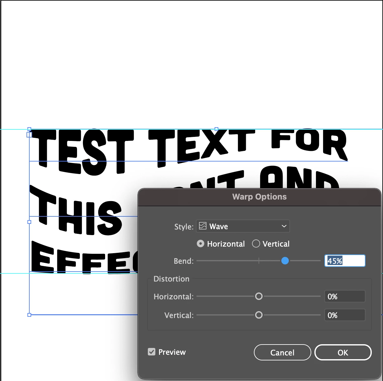

I have a project of which visual style is based on use of a font. In Illustrator I used the effect "Warp" and then chose the style "Wave" for the font:
In illustrator the effect basically bends the text inside the text box, leaving the top and bottom parts of the text mostly unaffect to bending. Basically the effect only bends the inner part of the text inside the text box.

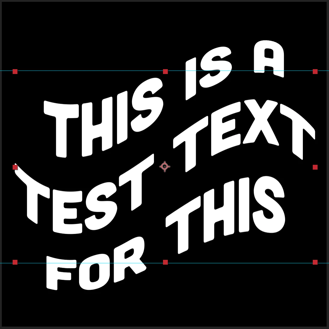

The problem occurs in After Effects when animating the text and applying the same "warp" effect on it and choosing the style "wave".
Compared to Illustrator, After Effect's warp effect bends the text differently, to "outside" of the text box compared to Illustrator's effect:
Is there any solution to have the same effect done in After Effects. Of course there are multiple ways of replicating the effect ( shape layers etc ) but there are multiple versions of text that i have to turn into videos with the same effect, so the "easiest" way would be just to change the text with all the animations ready.
So is there any way to replicate the effect on a text layer in After Effect?

I think the issue is that AE sees a text layer as the frame size of the comp while Illustrator sees it as the size of the text.
If you make either the text layer size the same as the comp frame, or the comp frame the same size as the text layer and then apply Wave Warp and set the Pinning property to 'All Edges' you can get a similar result to what you have in Illustrator.
So you can do it in AE, but it will likely involve precomping your text layer.
