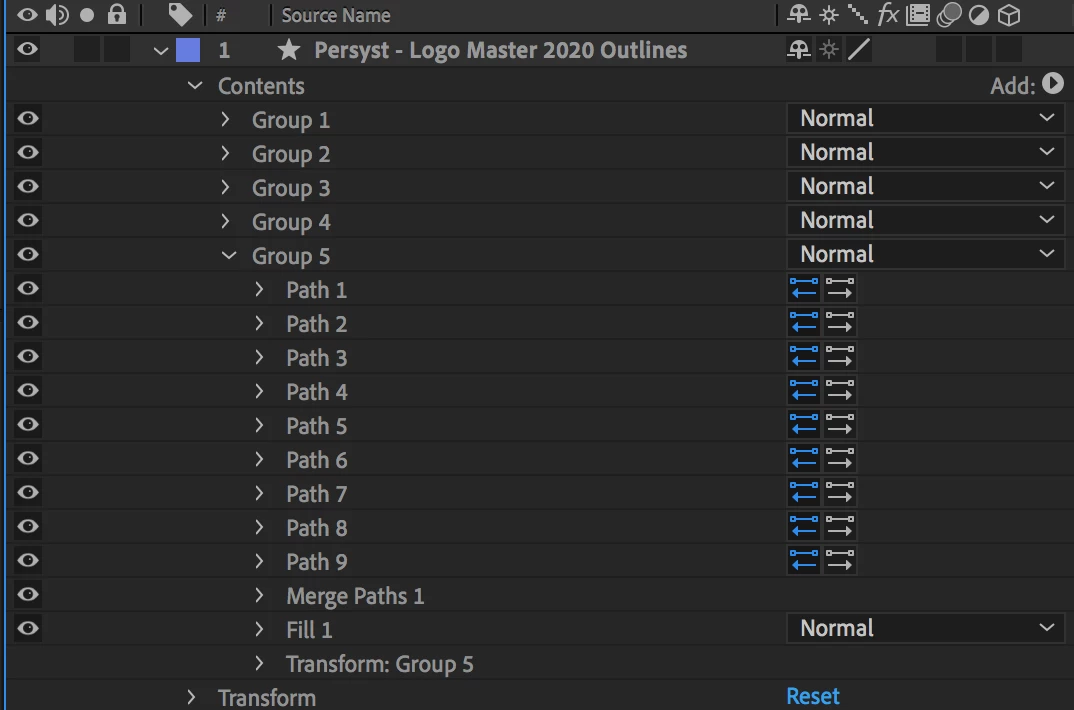

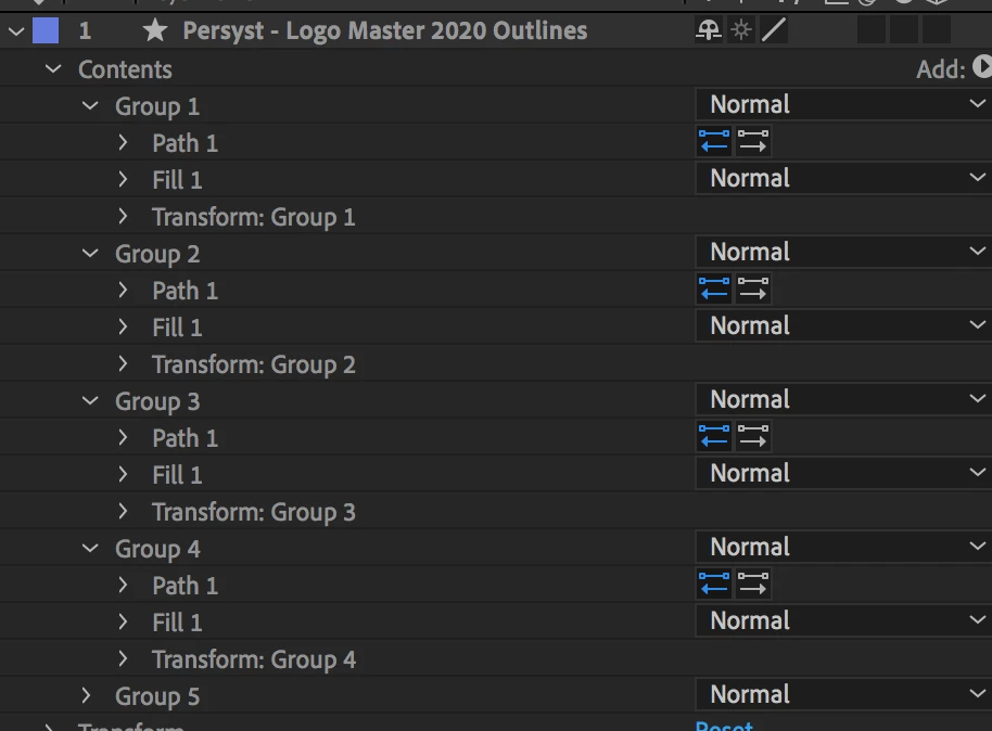

Greetings, I was able to do copy cmd+C a complex Illustrator path that had cutouts and paste it into After Effects onto an adjustment layer and the AI path was converted to various mask layer in AE which is exactly what I wanted. But I could not figure how to do this same thing by importing the actual AI file. I was able right-click 'Convert Shapes from Vector Layer', but all I get is a shape layer with a Contents drop-down that has a bunch of Groups that have Path and Fills, as shown in the screenshot below.
Is there a way to convert these shape groups/paths to mask paths?

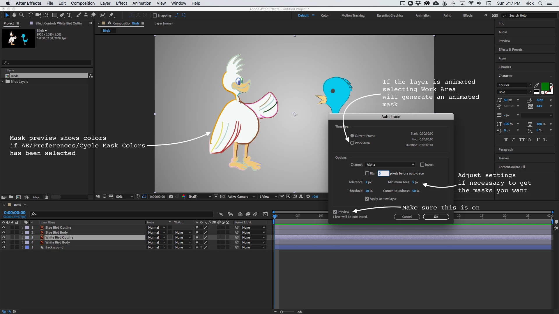

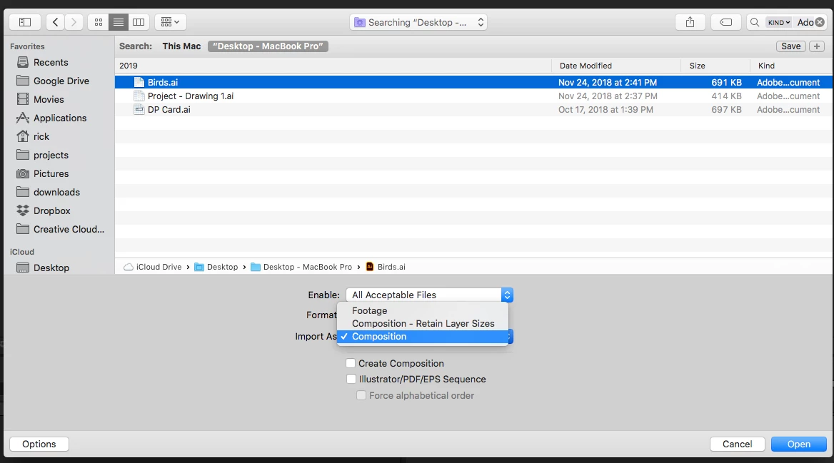

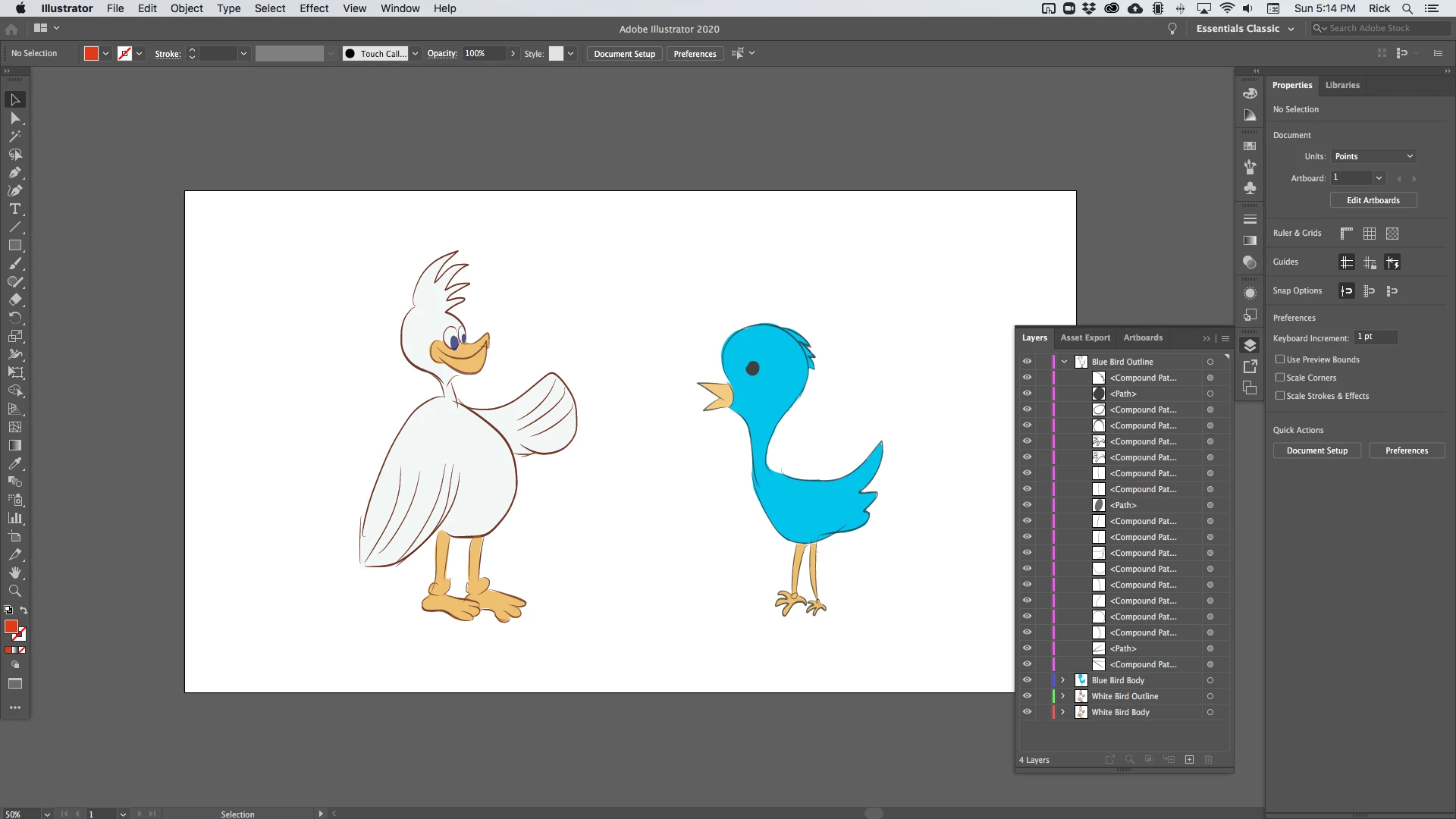

By far the easiest way to do this would be to prepare your AI file with each path you want to use on a separate layer in the proper position, import it as a Composition, then select the AI layer you want to use as a mask in the timeline, select Layer/AutoTrace from the menu, adjust the settings while previewing the output, then using those masks as needed.
Most of the time I import AI files as a Composition/Retain Layer Size, but this would give you a solid just the size of the layer and you probably don't want that. If you are using effects like Saber or UltraZap you'll want some room around the masks. Importing as a Composition makes every layer the size of the composition frame and that's what you want for this kind of work.
This is the workflow from the AI file to the comp through the final composite:

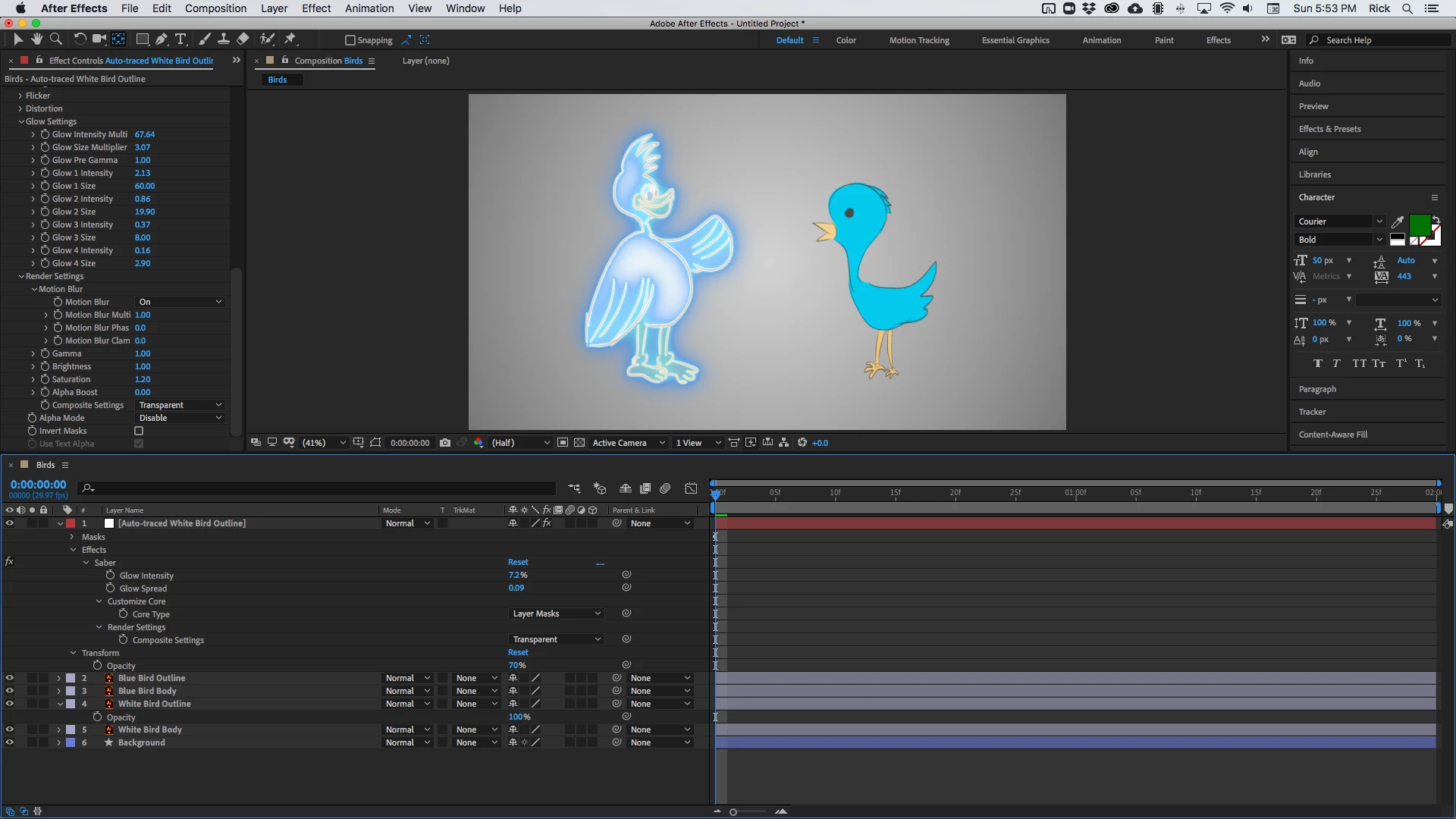

I don't have UltraZap installed on this machine so Saber was applied and set to use the layer masks. The default settings were slightly modified. You can see everything I edited in Saber.

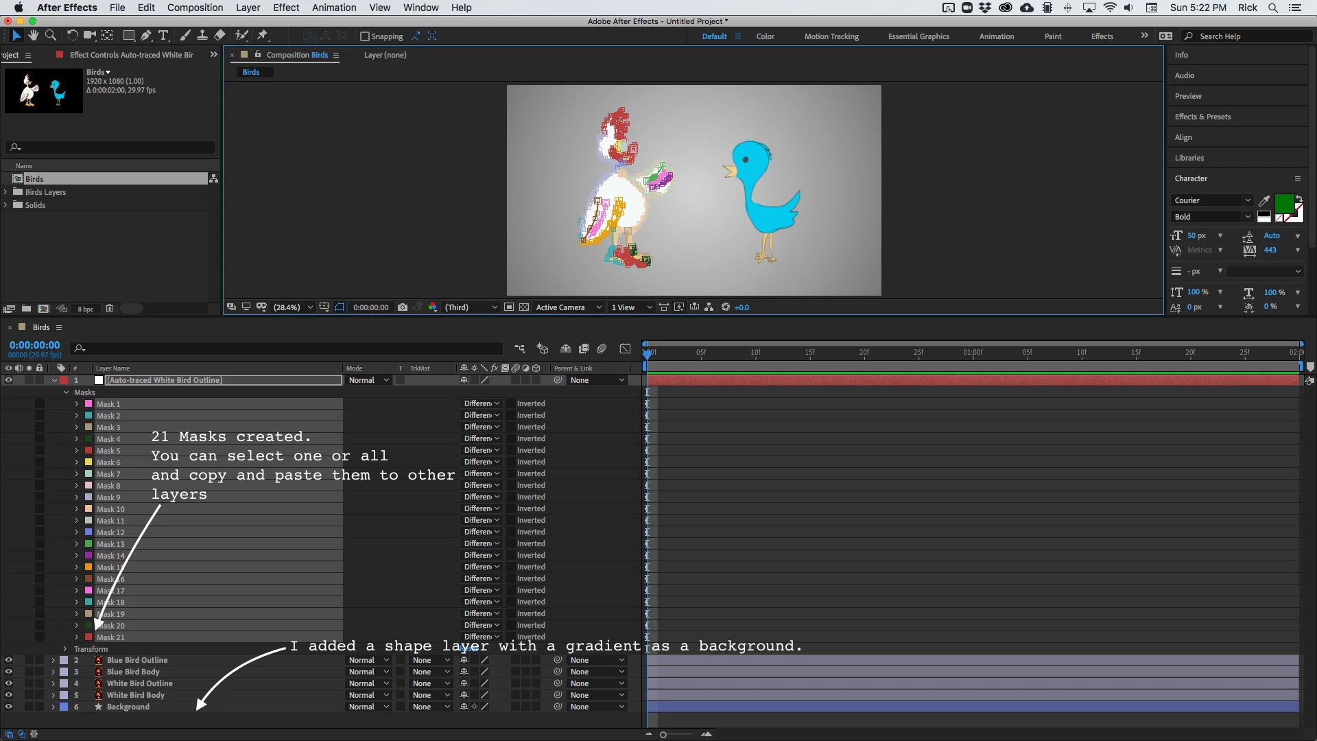

For what you are trying to do this is by far the most efficient workflow. Creating outlines from vector files is almost always a bad idea. If you use that feature each layer you convert to outlines should have only simple shapes, no brushes, no layer masks, no vector effects, and no gradient fills, blends, or other fancy things applied in Illustrator. If you end up with masks you can select multiple masks, even multiple animated masks, copy them, and paste them to a new layer with no problems. If you want to copy paths, you have to select them one at a time and paste them one at a time.

Yes you can do it. Once you have converted an AI to Shape Layer you can access to all paths under the Contents category in that layer. The way you convert to masks is:
1.- Select any of the path of your shape layer and use the copy command (CTRL/COMMAND+C)
2.- Create a Solid and create a single mask point in your solid layer using the pen tool
3.- Select the Mask Path parameter inside the Mask of your solid layer and paste the path data (CTRL/COMMAND+V)
Try it and tell us if this works for you.

Thanks for the reply. Can you please tell me what exactly I should be clicking on when doing the commad+C?
I can only click on the Group name under the Layer name (in my case I need the paths of Group 5) or I can click on the indivual paths under Group 5, but the individual paths are shape outlines and also shape cutouts, and since I need all the paths for the full composite mask, I clicked on the Group 5 name and did command+C, then created the point mask on a new Solid layer. I then did command+V but nothing gets pasted. What am I not doing correctly?

As Rick comments, you must copy the path (the one with the stopwatch on the left). Then, select the MASK PATH (not the Mask category) and paste it.
