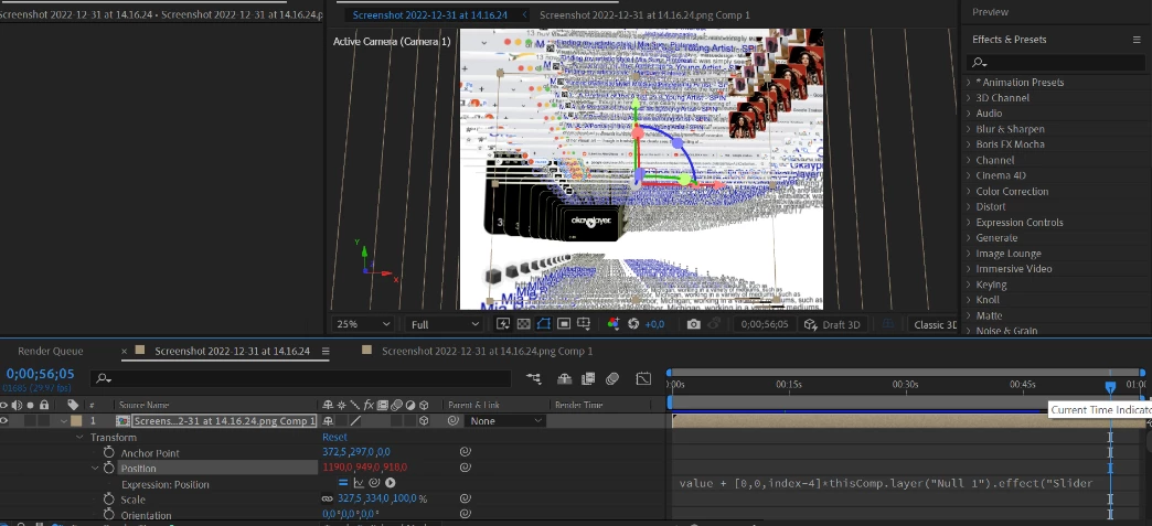

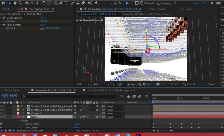

Here is the project screenshots:
January 2, 2023
