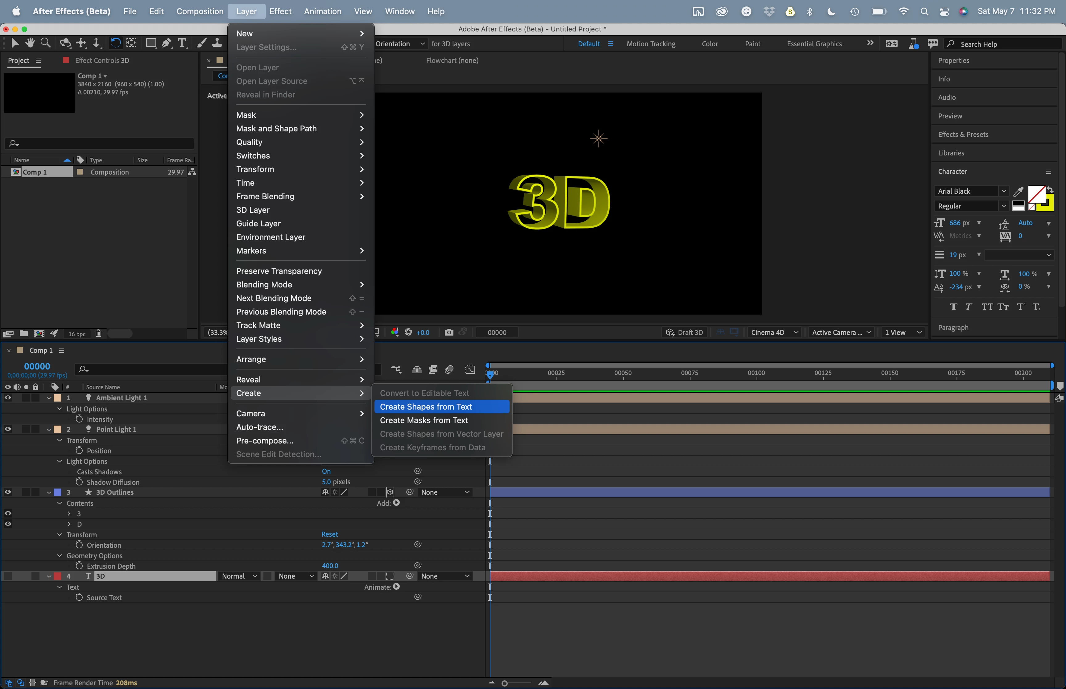

Create your text layer, select Layer/Create/Create Shapes From Text from the menu, make your shape layer 3D, press AA to reveal geometry options, and add light and some ambient light. Takes about 2 minutes:
The screenshot shows everything I modified and the shapes created from the text.
