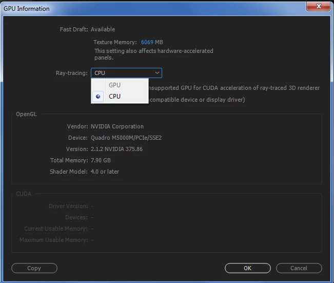

I'm facing issue to enabling GPU on Ray-tracing in AE CC2017. Any idea how to resolve it?
Btw, I have no issue to enable Cuda on my Premiere Pro CC 2017.
OS: WIN 7 SP1 64 bits
Nvidia video driver: 375.86-quadro-grid-desktop-notebook-win8-win7-64bit-international-whql
GPU: Nivida M5000M
Thanks.
KK
Correct answer Roei Tzoref
is M5000M different from 5000M? because if it is, M5000M it's not supported by Ae for ray-tracing
After Effects System Requirements for Mac OS and Windows
but hold on, why would you want to use the old, obsolete 3D renderer when you can use the much better C4D RENDERER ? you don't need cuda for that because it uses multi-threaded CPU. try it.

December 1, 2016
December 2, 2016
Hi Roei,
You are right, M5000M is difference with 5000M card.
Seem like my GPU too new and currently AE are not supported. Will take your advice use C4D option, let see how it goes.
Thanks.
KK
