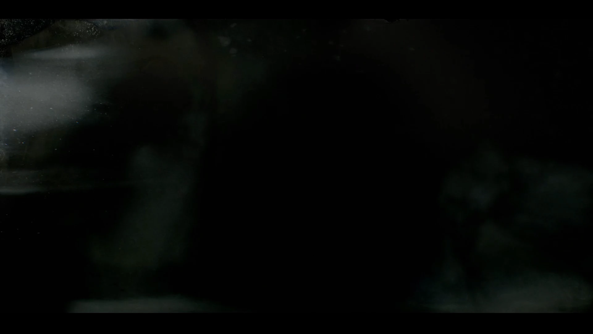

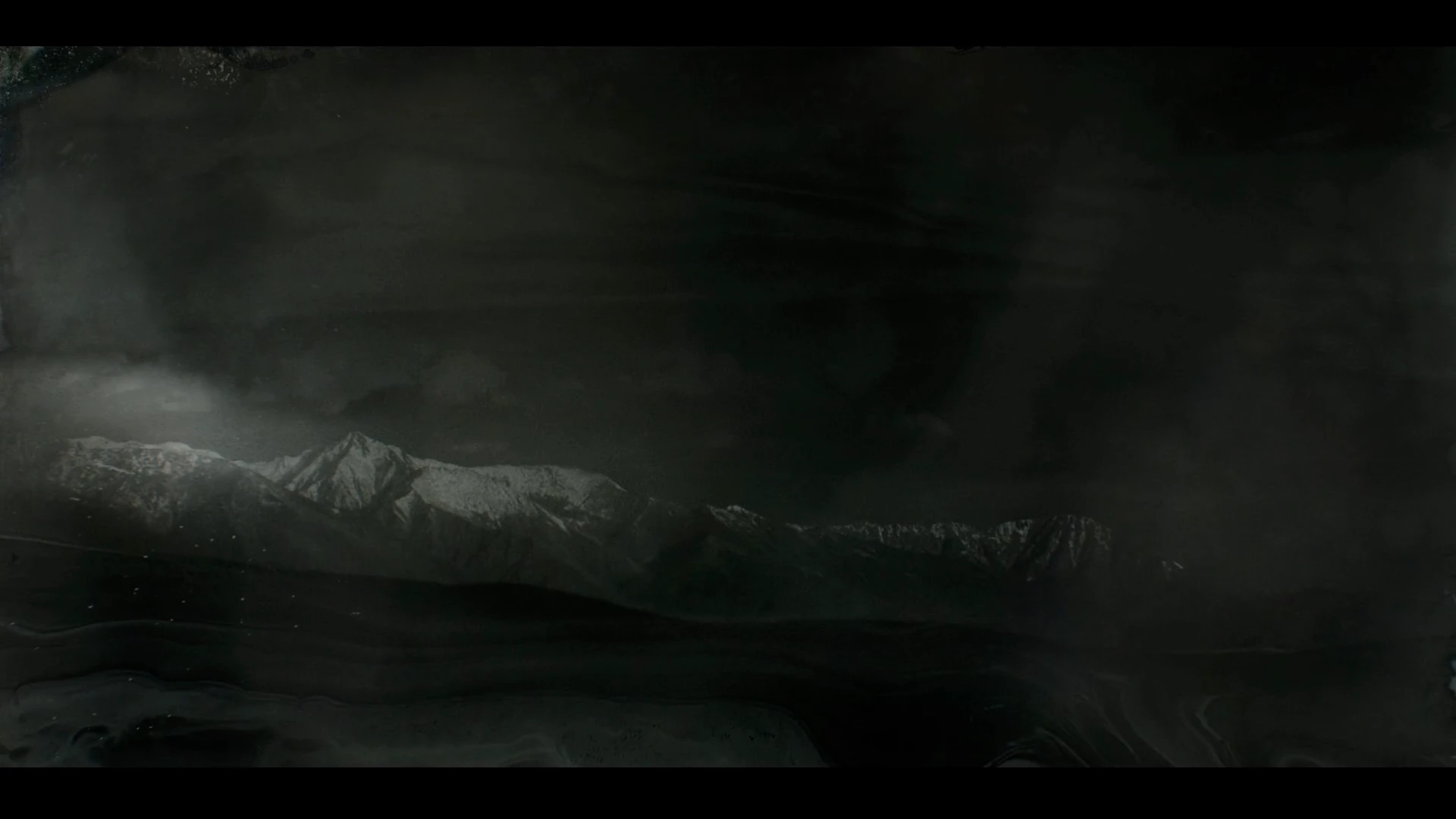

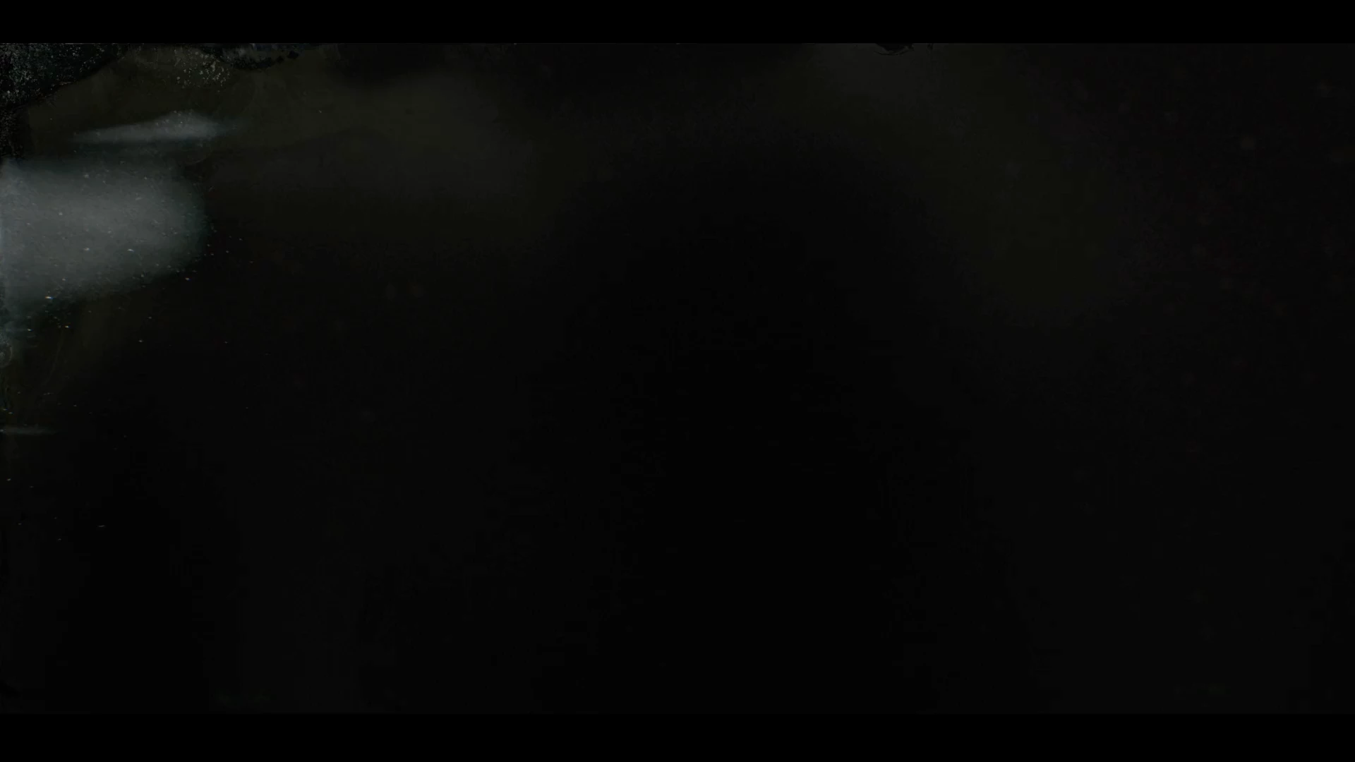

The subtle and random fade-in/out transitions in the 1883 title sequence are incredibly appealing, especially at the beginning. Here is the link to the video: https://vimeo.com/664104163
To achieve a similar effect, I've been experimenting with a gradient wipe and various gradient layers (though I haven't found a suitable one yet).
How would you recommend approaching the creation of a transition effect like this? Any advice would be greatly appreciated.

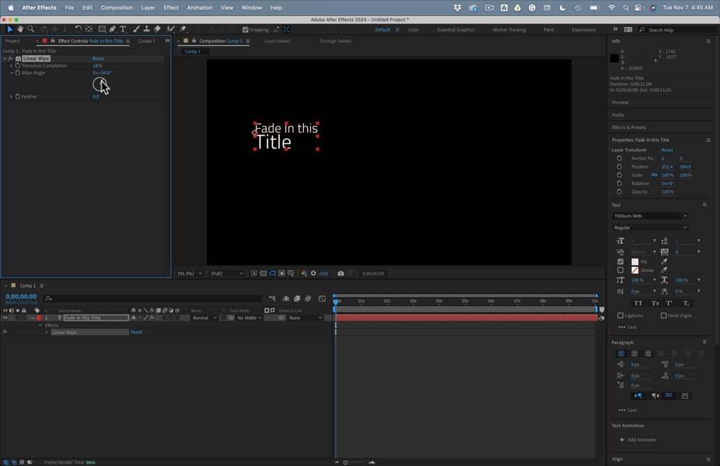

Try something like this:
 In this example, the angle was set to -9º, Feather to 228, and Transition completion was animated from 77% to 54%, then from 54% to 81%.
You could also animate a feathered mask or use an animated Fractan Noise layer as a track matte to have the letters fade in and out in a random pattern.
