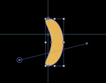

How to find the bounding box of a shape?
I have a layer with multiple shapes in it.
How to find the bounding box of a shape made out of bezier curves, like this one:
I can see vertices and tangents info inside value property, but nothing similar to
sourceRectAtTime for a layer.
Computing bounding box of a concave shape is rather difficult.

Feb 1, 2025 1:29 AM UTC
That will only work for convex shapes, not for concave ones, as you see on the image.

Jan 31, 2025 11:21 AM UTC
That works for a layer bounding box, I'm asking about an individual shape bounding box
Jan 31, 2025 11:28 AM UTC
and I looking for JSX API solution to put the code into an extension, rather that an expression
