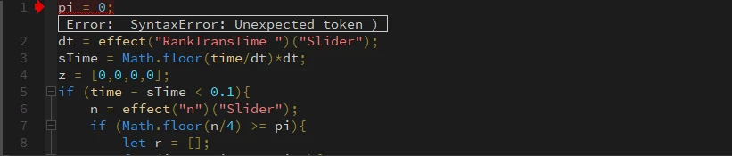

Hello! I'm still trying to grasp AE here! So I'm currently trying to code an automatic ranking system like one here:
https://youtu.be/STw_ZIw3uVE
But I keep getting the error message below
My CS friends explained it's most likely because I misplaced a closing bracket somewhere but we've been staring at it for hours and we still can't figure out where's the mistake. Does anyone know where I may have messed up?
 `pi = 0;
dt = effect("RankTransTime ")("Slider");
sTime = Math.floor(time/dt)*dt;
z = [0,0,0,0];
if (time - sTime < 0.1){
n = effect("n")("Slider");
if (Math.floor(n/4) >= pi){
let r = [];
for (i = 1; i <= n; i++){
ssTime = thisComp.layer(i).masterProperty("time").valueAtTime(sTime);
if (ssTime == 0) ssTime = (n-1)/1000;
let obj = {t: ssTime, id: i};
r[i-1] = Object.assign({}, obj);
r. sort(function(a,b){return b.t - a.t});
for (i = 1 <= 4, i++){
z[i-1] = r.findIndex(function(a)return a.id == i + (pi*4)})/20;
z `

The line
for (i = 1; <= 4, i++)
makes no sense. I'm also not clear what your sort function is supposed to do. You also have some extraneous spaces in your code, which is critical as it breaks inheritance. The whole code seems incomplete.

The code can be found here!
`pi = 0;
z = [0,0,0,0];
        let r = [];
z `
