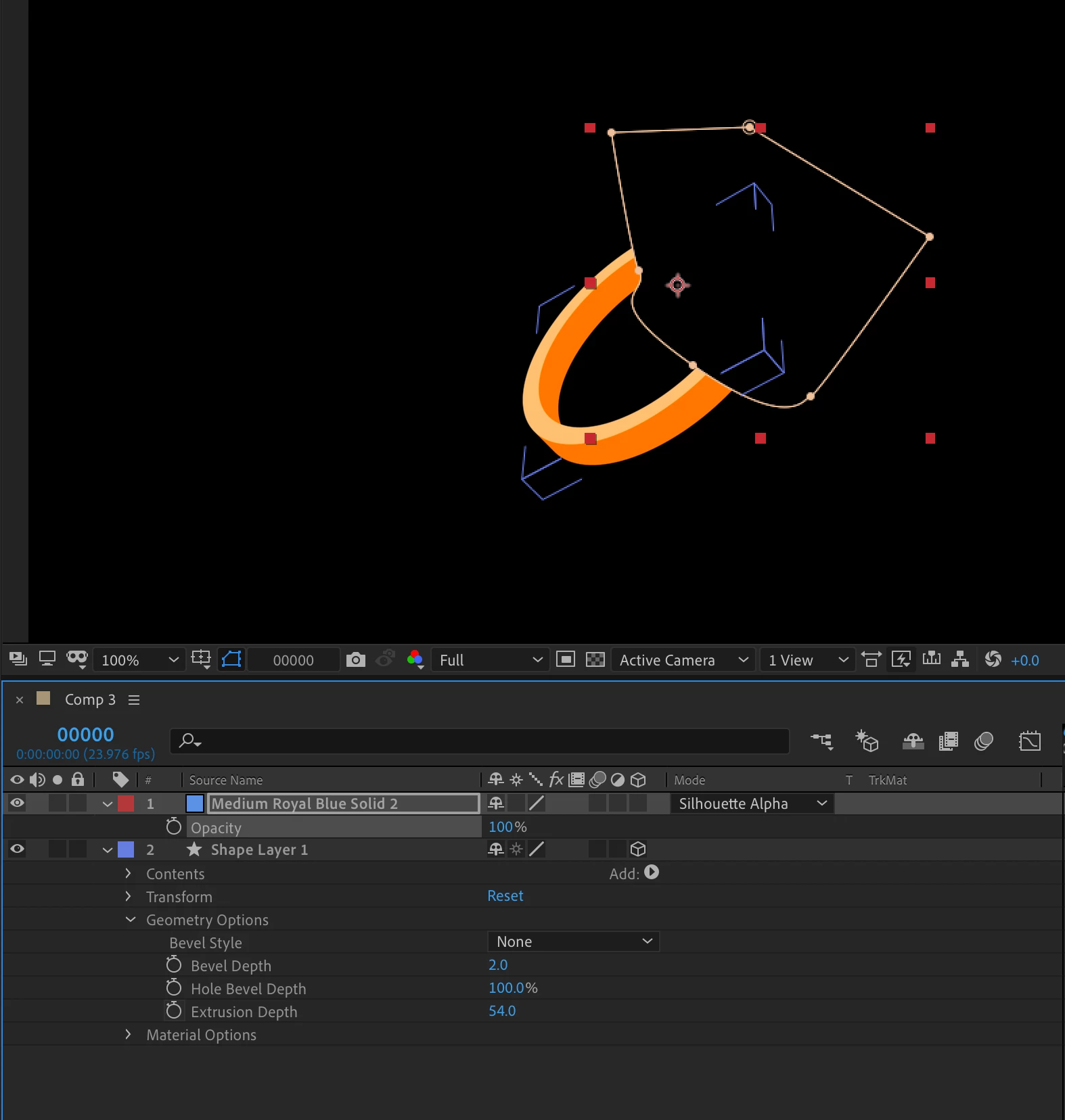

Hi, I have a 3D object in the shape of a "question mark". I want to know how to animate it so it looks like it's drawing itself? In the picture I have attached hopefully you can see how I want it to be animated.
I am familiar with how to do this type of effect in 2D i.e the same way how you would make a handwriting effect. But I cannot find a way to make a 3D object draw/reveal itself.
Hopefully someone can help. Thanks, Ben.

Ko.Maruyama
May 12, 2021
Once you use the 3D Geometry mode in After Effects, you don't have access to Track Mattes, so you may need to think a little more about how that layer will be revealed.
If you precompose it to flat layer, you can use it as a 2D element, which will be flat. (you may want to link a camera from the main comp for this).
If you have your 3D extruded object as the lowest layer, you can use a "mask layer" "fake track matte" layer in silhouette or stencil mode to mask out part of your 3D/extruded layer.
Unfortunately, BOTH of these options will create a flat edge on your 3D element, removing part of your 3D graphic. It will make your "3D" thing not look as "3D" as it was before.

Jose Panadero
May 11, 2021
I think it is not possible reevealing as a 3D object, but you can use a trim path animation on a similar stroke on a shape layer above the question mark and use it as a track matte.Maybe other colleagues in the forum can share some tips to do it.
Cinema 4D has a Sweep generator where you can do what you are looking for. I'm not sure if the Cinema 4D Lite included in After Effects has the Sweep generator included.
