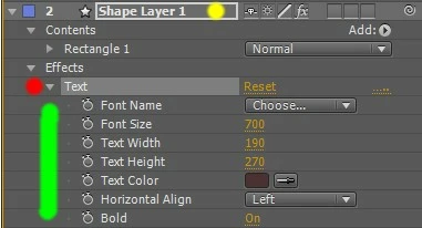

Hi all,
I have a problem when I want to export the parameters from the effect.
(I have checked the sample project "ProjDumper". )
Yellow: layer
Red: one of the effect (Text)
Green: the params of the effect (I want to export those values).
Following is my code:
        // 1. use a loop to find the "Text" effect
     // 2. get all the params from this effect

In the SDK document, it says the value of PF_ParamDefUnion should not be used.
So, how can I obtain those params in the effect I set (the green line in the picture)?
And, If there is any wrong of my logic, please let me know.
Thanks.

October 21, 2010
Use AEGP_StreamSuite4::AEGP_GetNewStreamValue(..)
ZuzuWuAuthor
October 21, 2010
Thank you for the opinion.
But, when I study the document, the output  of AEGP_GetNewStreamValue is AEGP_StreamVal.
It's a union:
typedef union {
    AEGP_FourDVal                        four_d;
    AEGP_ThreeDVal                      three_d;
    AEGP_TwoDVal                         two_d;
    AEGP_OneDVal                         one_d;
    AEGP_ColorVal                          color;
    AEGP_ArbBlockVal                    arbH;
    AEGP_MarkerValH                     markerH;
    AEGP_LayerIDVal                      layer_id;
    AEGP_MaskIDVal                      mask_id;
    AEGP_MaskOutlineValH            mask;
    AEGP_TextDocumentH             text_documentH;
} AEGP_StreamVal;
How can I know which param is pop-menu, checkbox, or fix slider? (You can see the green line of the picture.)
Shouldn't I use a loop to obtain all the params??
Could you please tell more detail how to use it?
Thanks again.
softy123___Correct answer
October 21, 2010
I now only how to get parameter stream type (AEGP_StreamVal type: AEGP_OneDVal, AEGP_ColorVal etc.). Pop-menu, checkbox, or fix slider parameter streams have the same stream type: AEGP_OneDVal.
How to get parameter control type you already posted in your code).
I use such loop too..
I don't know what you want to do.. I can't say more than written in SDK.
