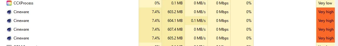

In the newest version of AE, every time I open an old project it initializes Cineware eventhough there is no instance of the plugin used in the project.  Plus, when I exit AE I check the taskmanger and see it is filled with numerable instances of Cineware. One for every project I open.

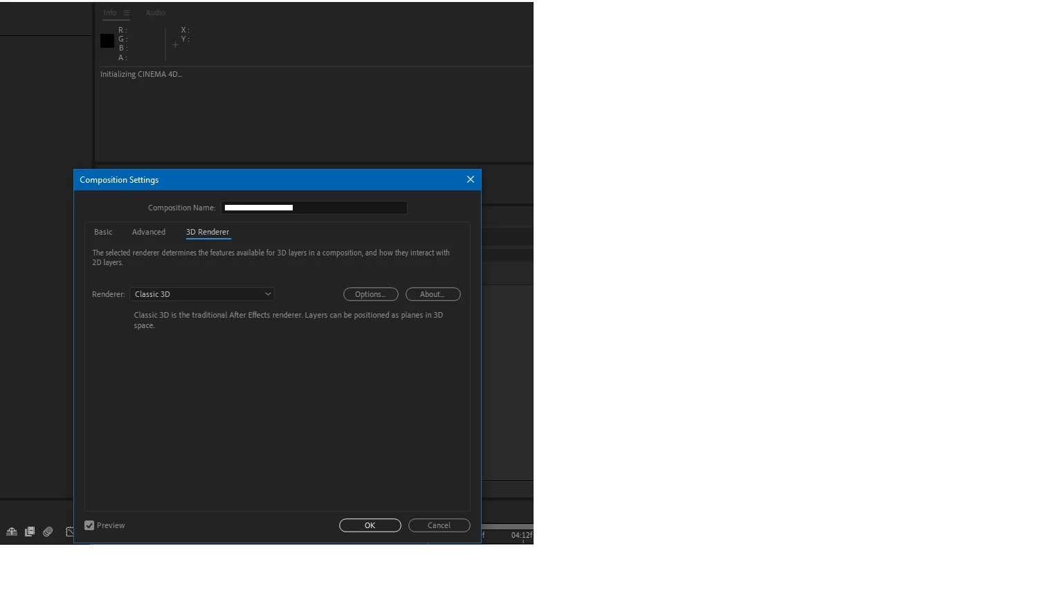

It is initializing Cieware because you have your comp set to use the C4D rendering engine. Open comp settings and change the settings to Classic 3D.

Disregard my other reply. You were right. It was in a comp that wasn't being used. So eventhough my main comp was set to Classic 3d, it seems any one even existing in the project will intialize Cineware (C4D). See my test even threw me...Classic renderer but C4D intializing...
