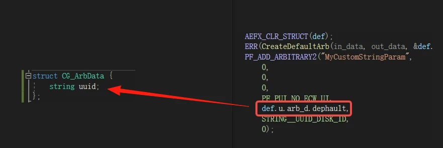

Hi guys, in my effect plugin, I add an arbitrary parameter which value is a string, now I add this effect to an image layer, I want to get the string value through extend script, the value type I found is CUSTOM_VALUE, and I failed with get it through property.value directly, how to achieve this in jsx script?

perhaps there's an easier way than the one i use, but here goes:
1. add some invisible checkbox that is supervised.
2. from the javascript side, leave a message in global scope (or some function to be called) that the C side can later read using AEGP_ExecuteScript(). then toggle the said checkbox. the toggling will trigger a USER_CHANGED_PARAM call.
3. from the C side use AEGP_ExecuteScript() to look for a message from the javascript side. if the message is there, read the string value from the arb and pass it back to the javascript side using AEGP_ExecuteScript().
if not message was left, then this is a regular USER_CHANGED_PARAM call, and you can process it as you would normally.
4. now the execution returns to the javascript side, where the string value awaits wherever you put it in the javascript gloval scope from the C side.
not elegant, but at least it's synchronous...
Aug 13, 2025 9:30 AM UTC
Thanks man! I come up with an idea which is use some hidden UI, and send my string to their controller name, in jsx side, I just get property name and combine them~
