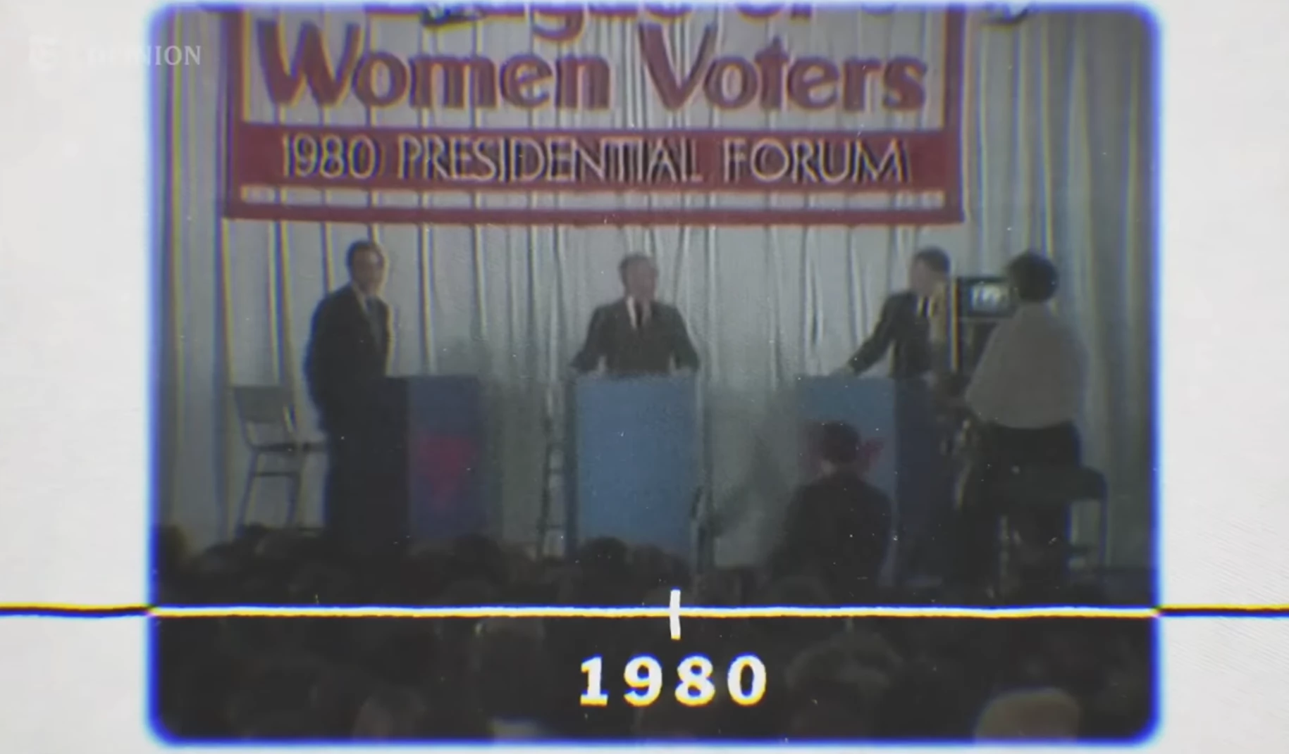

I'm trying to recreate this timeline effect, but I can't work out how to make the text/shapes inverted inside of the TV box whilst also moving everything along. Also does anyone know how that blue hue is caused?
Here is the video at the time the effect takes place: https://youtu.be/W9mPEquFKKA?list=PLYvpAiMpY4V-xV3r4W3en4jTCHCDSdaoW&t=50
Any help would be much appreciated!

Thanks for reaching out, Katie.
You can apply the Invert effect (or any other effect that helps) and add a mask to the effect to cover the TV. So that the effect will apply only on the masked area. This video should help: https://adobe.ly/3HUuFO0
Hope it helps. Let us know how it goes.
Nishu
Nishu

That's worked, thank you!
