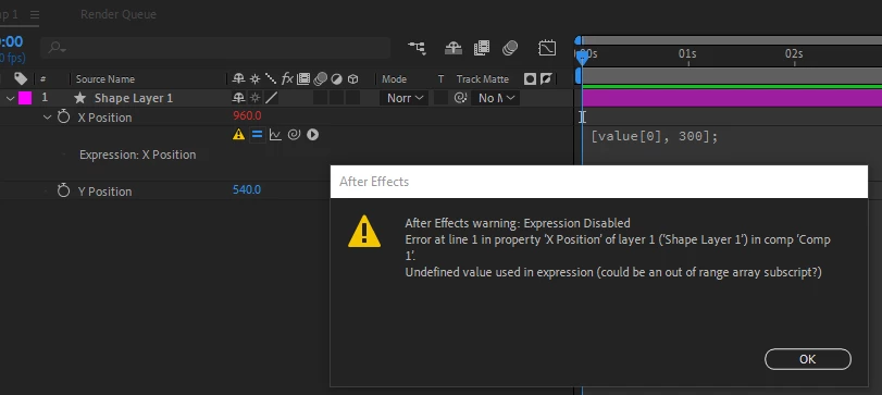

Nov 6, 2023 8:26 PM UTC
Hi and thank you for your respoce.
I tried the first example and it gives me this message. What am i doing wrong?
Nov 7, 2023 12:03 AM UTC
Do not separate values. It is almost always a bad idea to do so.
