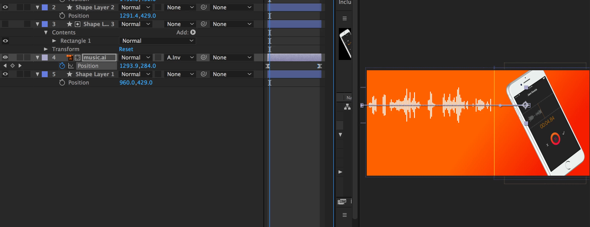

Hi guys,
Im trying to do a GIF of a music line that's ongoing (attaching references)
I want to be able to create a loop that infinitely moves toward the same direction.
Currently using the position i adjusted the animation from beginning to end, but once it starts again it starts from the beginning again, so there's no real loop-like feel of the GIF.
Any idea how i can do this?
Thanks

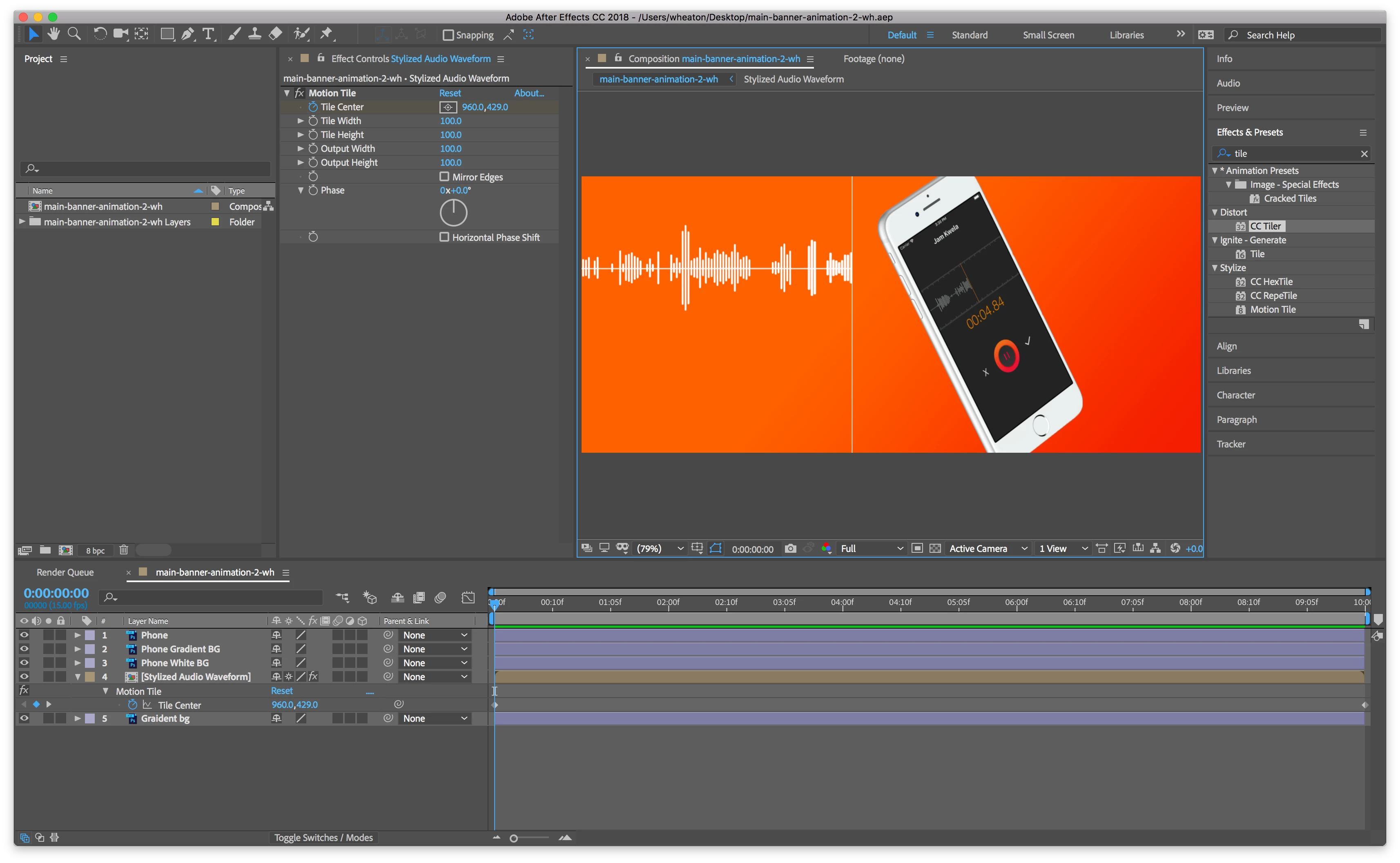

Warren Heaton
October 4, 2018
  1. Go the first fame of your Comp and turn off the Position Time-vary Stopwatch for Layer 4 music.ai.
  2. Assuming that Layer 4 is positioned at the horizontal center of the Comp, apply the Motion Tile effect to Layer 4 music.ai.
  3. Under the Motion Tile effect, enable the Time-vary Stopwatch for Tile Center (while still at the first frame of the Comp).
  4. Go to the last frame and change the current X value for Motion Tile to negative.  For example, if it is 960,430 at the first frame, change it to -960,430 at the last frame.  If you jump to the first frame and then to the last frame, the Comp should look the same.  If you Preview, Layer 4 music ai should move from left to right.
  5. To create a clean loop cycle, nudge the second Tile Center keyframe so that it on the next frame after the last frame.
-Warren
