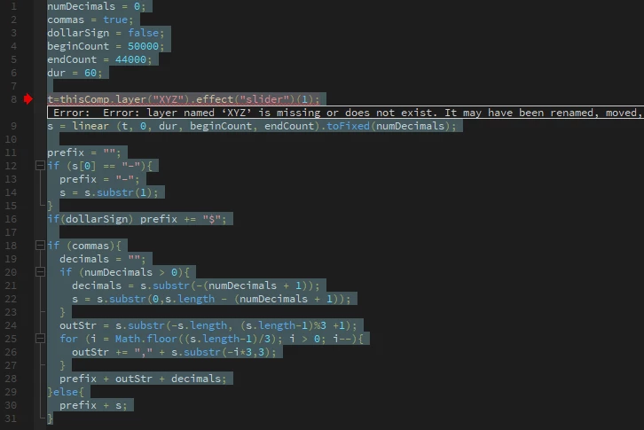

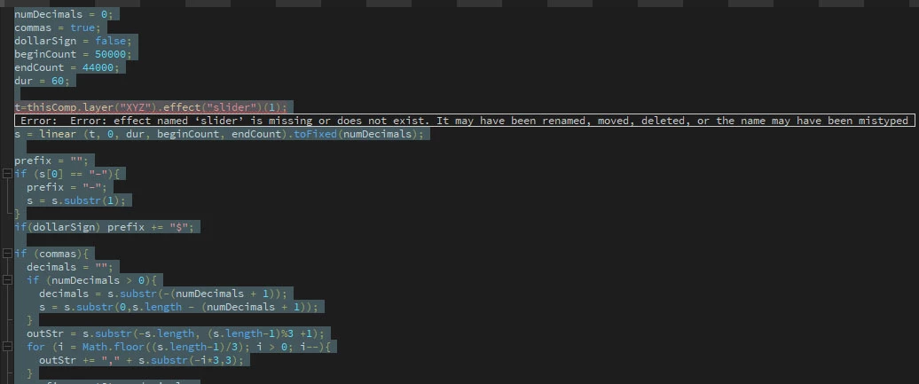

Sadly I never worked with JS and it looks like something additional is needed when entering the code you suggested.
I end up getting "error: layer named XYZ is missing" or "error: effect named slider is missing"
Renaming the text layer seems understandable, but not sure if your code requires me to insert a specific effect for it (Slider Control?)? Yeah man you are dealing with an absolute noob. JS is just not something I expected to need to handle. Know nothing of it. Combination of using JS and AE is just blowing my mind, and not currently in good ways x) thanks for your time.
