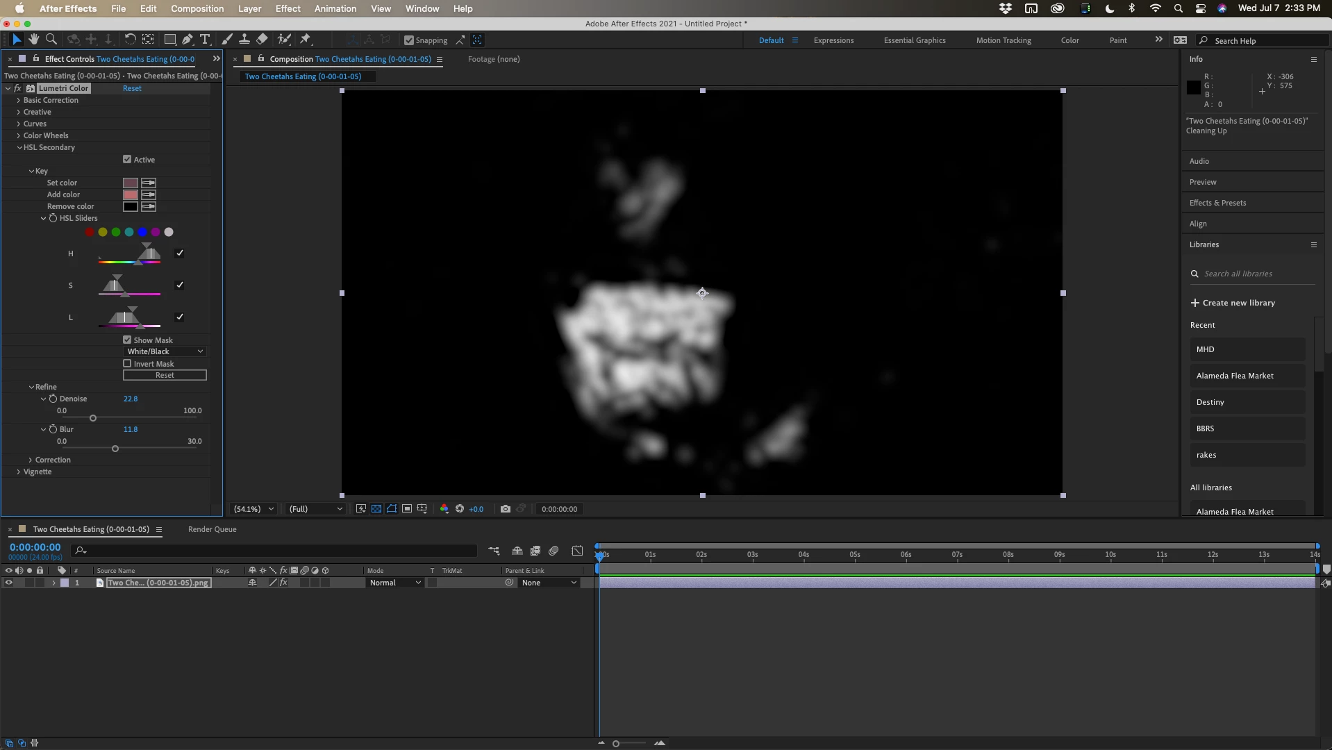

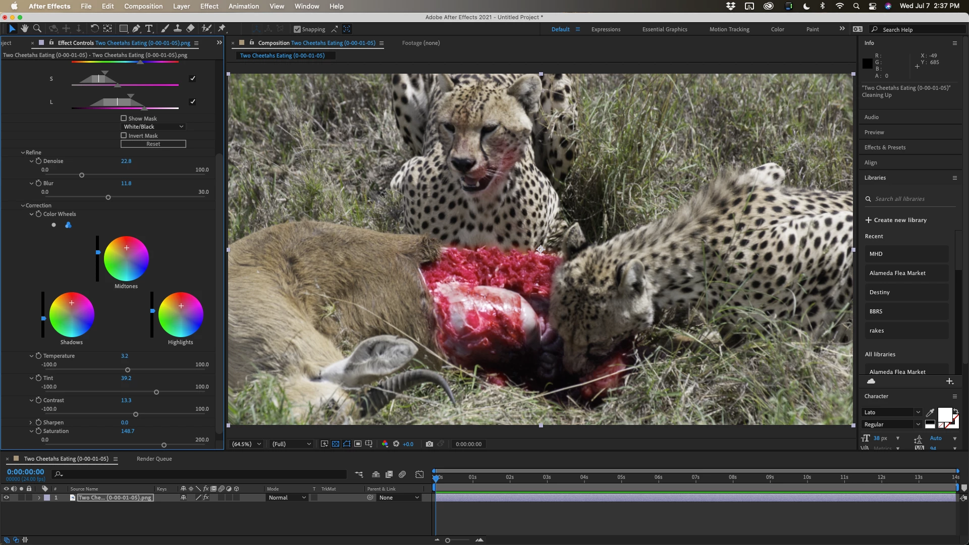

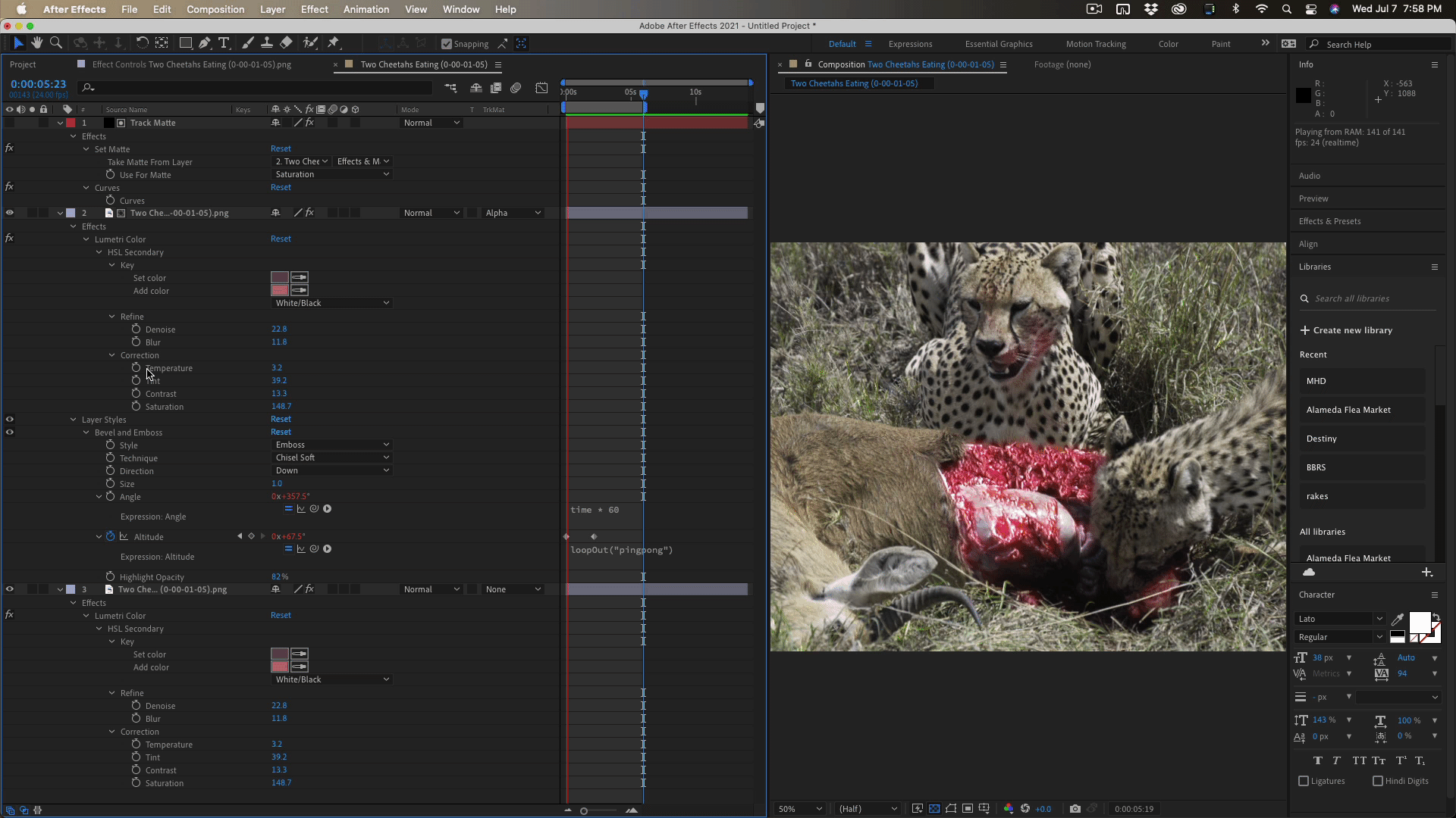

Correct answer Rick Gerard
Personally, I would use Lumetri and to isolate the red color, enhance it, and then create a matte to isolate just the meat. Then I would animate the color correction a bit and add a couple of other effects. You should be able to create a track matte. Here are a couple of screenshots. The first one is setting up volumetric to enhance the red color using HSL secondary:
The second is the adjustments using the color wheels:
The last is the final product using Set Matte to create a matte for a copy of the footage with Bevel and Emboss layer styles set to animate with expressions.
That's just one idea. There are a dozen ways to do something similar, but they all involve creating a matte.
Mylenium
July 8, 2021
I agree with Rick. A slightly more intense color correction is pretty much all I would add here. If at all a slight pumping effect could perhaps be added as well with a Displacment Map effect, but I wouldn't go too crazy.

Rick GerardCommunity ExpertCorrect answer
July 8, 2021
